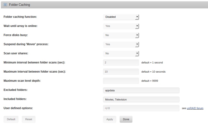

  24. I updated the docker from the docker update available, not from within the application. Still receiving that same 404 error after adding in the EDGE parameter, and also removing the container, image and config file, and then starting from scratch. Things are still being sent and downloading properly to it, but any webui attempt is just error. gfjardim?
