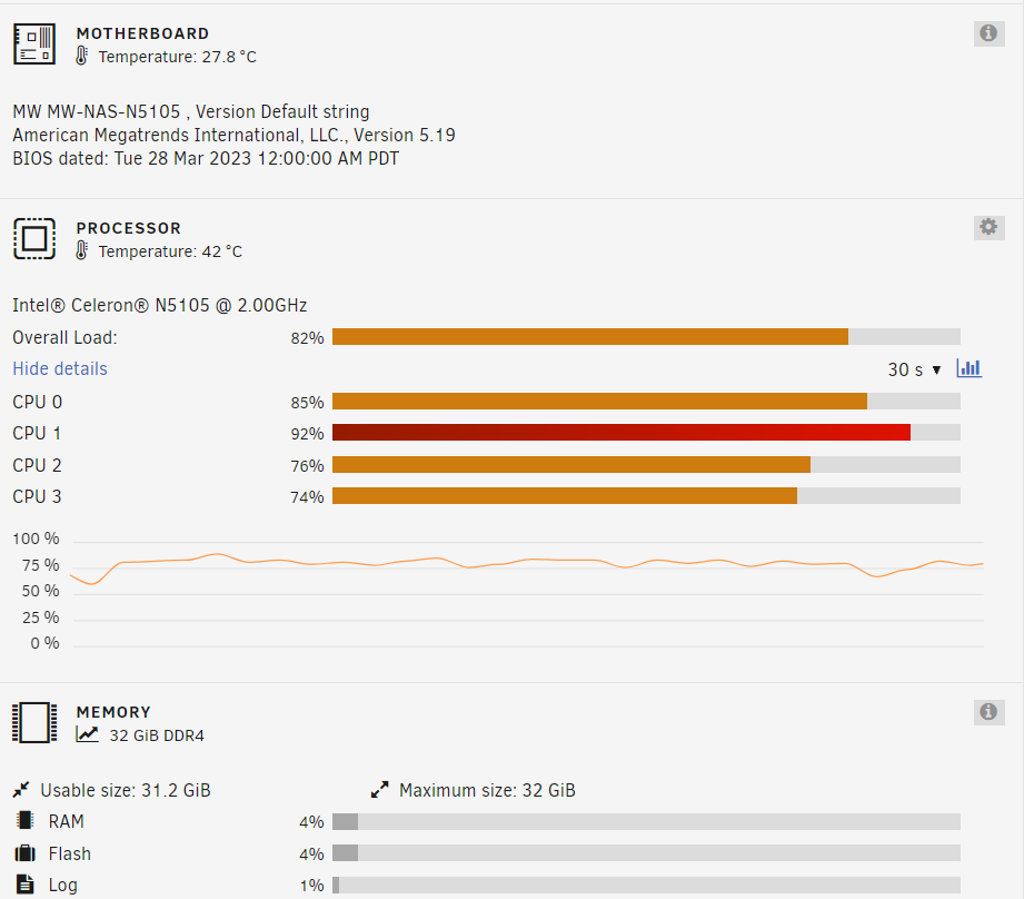

  8. Preclearing 3 disks, I still have two Samsungs apart; CPU temp seems not bad:
