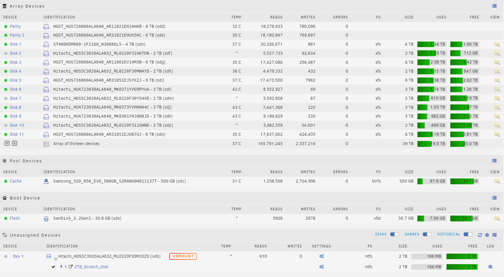

Perhaps it just takes a couple minutes to push the share out. In the time it took me to reread the instructions, then to post my query, the share now shows up and I can access it just like any share on the drive. I had opened a new file explorer (from Win 10) to view the share, but when I went back after posting, the share was there. Thanks again, handy tool.
Love the app, thanks for creating it. Just trying to mount and share the drive to get things started. The drive is shown on main. Its an NTFS drive already formatted. It mounted the drive and i can see it in Main, and click on it to access files/directories. I've gone into settings and turned on SHARE. When I go back into settings I see "Mount Point: 2TB_Scratch_Disk". But I'm not seeing an SMB share available. If I go to http://SERVER/2TB_Scratch_Disk, a blank page displays. I've reread through the instructions in the first post, but must be missing something. Thanks in advance!
