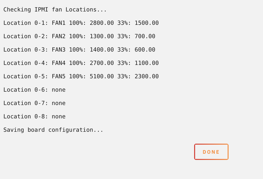

  1. Just checking in to see if anyone has a working solution for the X470D4U? Many thanks in advance.
  2. Sadly I've had no luck getting my Asrock x470D4U working. I can successfully run the 'configure' (which detects the fans and speeds them up etc), but activating the temperature controls and starting fan control does nothing. I can confirm sending a command like: "ipmi-raw -h 192.168.1.11 -u admin -p admin 00 3a 01 00 32 48 48 64 00 00 00" works just fine. Does anyone use this board, or can help me figure this out? Many thanks.
  3. Hi all, Well, following my previous posts (above), I've been trying to get this working for over a week with no luck. I even bought a new fan to populate header_6 to see if that made a difference - it didn't. If anyone has any ideas why it might not be working with my board (but is for others), I'd love some help! It's strange that the configuration ramps up the fans and recognises everythign correctly, but auto / temp control doesn't work
  4. Hi, I've already checked that - no luck sadly I'm wondering if it's related the config / layout of my fans, as it did work briefly when they were attached to other headers. I tried to swap them back, but no luck... Tried a clean install too. Is there a chance you could share your board.json so I can compare it? Thanks in advance. To summarise: Config runs and I hear the fans ramping up, RPM is correct for each. Running in debug shows an incorrect raw command (unless I'm interpreting it wrongly). IPMI shows correct percentages, but no fan control happens. BIOS is set to smart fan, for all fans.
  5. Okay, upon activating debug it seems the issue is caused by a wrong RAW command being sent? I see: 2020-11-12 19:07:19 ipmi-raw 00 3a 01 00 00 44 44 44 44 00 -h '192.168.1.11' -u 'admin' -p 'xxx' --session-timeout=5000 --retransmission-timeout=1000 2>&1 Shouldn't the command include another '00' @dmacias? Would love to get this working, my rack sounds like a jet turbine Edit: reinstalled to test, no luck, debug log below: Sleep 60 seconds. Highest temp is 33ºC DECLARED VARIABLES: Array ( [debug] => 1 [prog] => ipmifan [lockfile] => /var/run/ipmifan.pid [log] => /var/log/ipmifan [service] => /usr/local/emhttp/plugins/ipmi/scripts/ipmifan [usage] => Process settings in ipmi plugin fan config. Control fans based on config values and [options]. Usage: ipmifan [options] -a, --auto set fans to auto --full set fans to full speed -q, --quiet suppress all messages --debug turn on debugging --daemon run in the background --help display this help and exit --quit stop daemon if running --version output version information and exit [shortopts] => adfq [longopts] => Array ( [0] => auto [1] => daemon [2] => debug [3] => full [4] => help [5] => quit [6] => quiet [7] => version ) [args] => Array ( [debug] => ) [arga] => [argf] => [argq] => [daemon] => [quit] => [raw] => 00 3a 01 [board_json] => Array ( [ASRock] => Array ( [raw] => 00 3a 01 [auto] => 00 00 00 00 00 00 00 00 [full] => 64 64 64 64 64 64 64 64 [fans] => Array ( [FAN1] => 01 [FAN2] => 01 [FAN3] => 01 [FAN4] => 01 [FAN5] => 01 [FAN_POS6] => 01 [FAN_POS7] => 01 [FAN_POS8] => 01 ) ) ) [board] => ASRock [board_file_status] => 1 [msg] => Fan:Temp, FAN2(66%):HDD Temp(33°C) [MD5] => 6ff1b3c3d1dd1140c6d895d739d64c7f [fancfg_file] => /boot/config/plugins/ipmi/fan.cfg [hdd_temp] => 33 [sensors] => Array ( [10] => Array ( [ID] => 10 [Name] => MB Temp [Type] => Temperature [Reading] => 35.00 [Units] => C [Event] => 'OK' ) [11] => Array ( [ID] => 11 [Name] => Card side Temp [Type] => Temperature [Reading] => 37.00 [Units] => C [Event] => 'OK' ) [12] => Array ( [ID] => 12 [Name] => CPU Temp [Type] => Temperature [Reading] => 43.00 [Units] => C [Event] => 'OK' ) [13] => Array ( [ID] => 13 [Name] => DDR4_A2_Temp [Type] => Temperature [Reading] => 39.00 [Units] => C [Event] => 'OK' ) [14] => Array ( [ID] => 14 [Name] => DDR4_A1_Temp [Type] => Temperature [Reading] => 40.00 [Units] => C [Event] => 'OK' ) [15] => Array ( [ID] => 15 [Name] => DDR4_B2_Temp [Type] => Temperature [Reading] => 40.00 [Units] => C [Event] => 'OK' ) [16] => Array ( [ID] => 16 [Name] => DDR4_B1_Temp [Type] => Temperature [Reading] => 40.00 [Units] => C [Event] => 'OK' ) [17] => Array ( [ID] => 17 [Name] => FAN1 [Type] => Fan [Reading] => 1000.00 [Units] => RPM [Event] => 'OK' ) [18] => Array ( [ID] => 18 [Name] => FAN2 [Type] => Fan [Reading] => 600.00 [Units] => RPM [Event] => 'OK' ) [19] => Array ( [ID] => 19 [Name] => FAN3 [Type] => Fan [Reading] => 500.00 [Units] => RPM [Event] => 'OK' ) [20] => Array ( [ID] => 20 [Name] => FAN4 [Type] => Fan [Reading] => 800.00 [Units] => RPM [Event] => 'OK' ) [21] => Array ( [ID] => 21 [Name] => FAN5 [Type] => Fan [Reading] => 1900.00 [Units] => RPM [Event] => 'OK' ) [22] => Array ( [ID] => 22 [Name] => FAN6 [Type] => Fan [Reading] => N/A [Units] => RPM [Event] => N/A ) [99] => Array ( [ID] => 99 [Name] => HDD Temperature [Type] => Temperature [Reading] => 33 [Units] => C [Event] => Ok ) ) [ipmipoll] => 6 [fanpoll] => 6 [hddpoll] => 6 [fan_count] => 8 [hdd_count] => 60 [curent_hex] => [current_hex2] => [i] => 1 [board0] => ASRock [fans] => Array ( [FAN1] => 01 [FAN2] => 01 [FAN3] => 01 [FAN4] => 01 [FAN5] => 01 [FAN_POS6] => 01 [FAN_POS7] => 01 [FAN_POS8] => 01 ) [hex] => 00 00 40 00 00 00 00 00 00 [cmd] => [exec] => [value] => 01 [fan] => FAN_POS8 [temp] => [fancfg] => Array ( [FANCONTROL] => disable [FANPOLL] => 6 [FANIP] => 192.168.1.11 [HDDPOLL] => 6 [HDDIGNORE] => [HARDDRIVES] => enable [FAN_FAN1] => 17 [TEMP_FAN1] => 0 [FAN_FAN2] => 18 [TEMP_FAN2] => 99 [TEMPHI_FAN2] => 40 [TEMPLO_FAN2] => 20 [FANMAX_FAN2] => 64 [FANMIN_FAN2] => 1 [FAN_FAN3] => 19 [TEMP_FAN3] => 0 [FAN_FAN4] => 20 [TEMP_FAN4] => 0 [FAN_FAN5] => 21 [TEMP_FAN5] => 0 [FAN_FAN6] => 22 [TEMP_FAN6] => 0 ) [templo] => 20 [temphi] => 40 [fanmin] => 1 [fanmax] => 64 [range] => 64 [reading] => 33 [name] => HDD Temperature [pct] => 66 [pwm] => 00 [cmd_count] => 0 [cmd_str] => ipmi-raw 00 3a 01 00 00 40 00 00 00 00 00 00 -h '192.168.1.11' -u 'admin' -p 'admin' --session-timeout=5000 --retransmission-timeout=1000 2>&1 [fanopts] => -h '192.168.1.11' -u 'admin' -p 'admin' --session-timeout=5000 --retransmission-timeout=1000 [current_hex] => 00 00 40 00 00 00 00 00 00 [time1] => 1605221273 [MD5_new] => 6ff1b3c3d1dd1140c6d895d739d64c7f [plg_path] => /boot/config/plugins/ipmi [cfg_file] => /boot/config/plugins/ipmi/ipmi.cfg [cfg] => Array ( [IPMISELD] => disable [IPMIPOLL] => 180 [NETWORK] => enable [LOCAL] => disable [IPADDR] => 192.168.1.11 [USER] => admin [PASSWORD] => YWRtaW4= [DISP_SENSOR1] => 0 [DISP_SENSOR2] => 0 [LOADCFG] => disable [IGNORE] => [DIGNORE] => [DASH] => enable [DEVIGNORE] => [DEVS] => enable [OVERRIDE] => enable [OBOARD] => ASRock [OCOUNT] => 0 [OMODEL] => 9 ) [netsvc] => enable [ipaddr] => 192.168.1.11 [user] => admin [password] => YWRtaW4= [override] => enable [oboard] => ASRock [omodel] => 9 [ocount] => 0 [ignore] => [dignore] => [devignore] => [devs] => enable [ipmi] => [netopts] => --always-prefix -h '192.168.1.11' -u 'admin' -p 'admin' --session-timeout=5000 --retransmission-timeout=1000 [fanctrl] => disable [hddignore] => [harddrives] => enable [fanip] => 192.168.1.11 [board_file] => /boot/config/plugins/ipmi/board.json [boards] => Array ( [ASRock] => [ASRockRack] => [Dell] => [Supermicro] => ) [board_status] => 1 )
