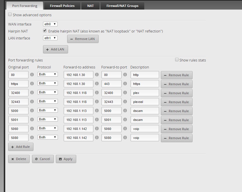

  23. So it seems a Hikvision surveillance camera that is on the same network was somehow hijacking the portforwad. Removed from network and the container is now running as it was. Thanks to @CHBMB for troubleshooting with me.
