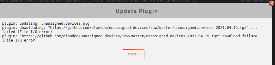

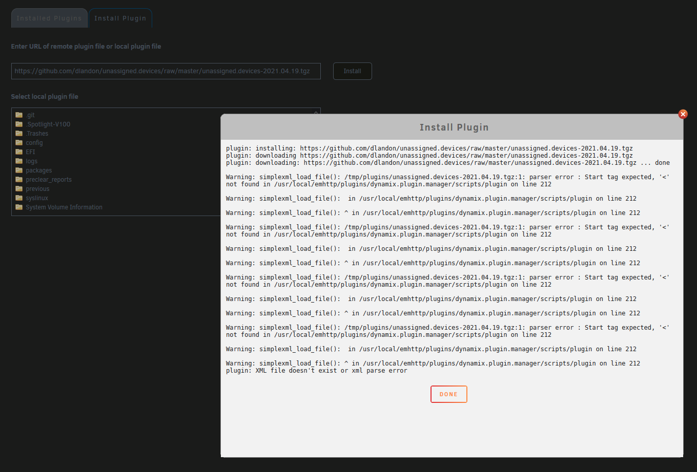

  3. Don't think it's an internet issue, as this is what I get if I try install it manually Having said that, this might be the cause 😅 EDIT: Yep, flash drive corrupted, replaced it and all good now

  8. Ah ha, bingo. Thanks Squid. I hadn't used Unassigned Devices in so long that I totally forgot that was a thing. After enabling that and pressing Stop Preclear, Format shows up again
