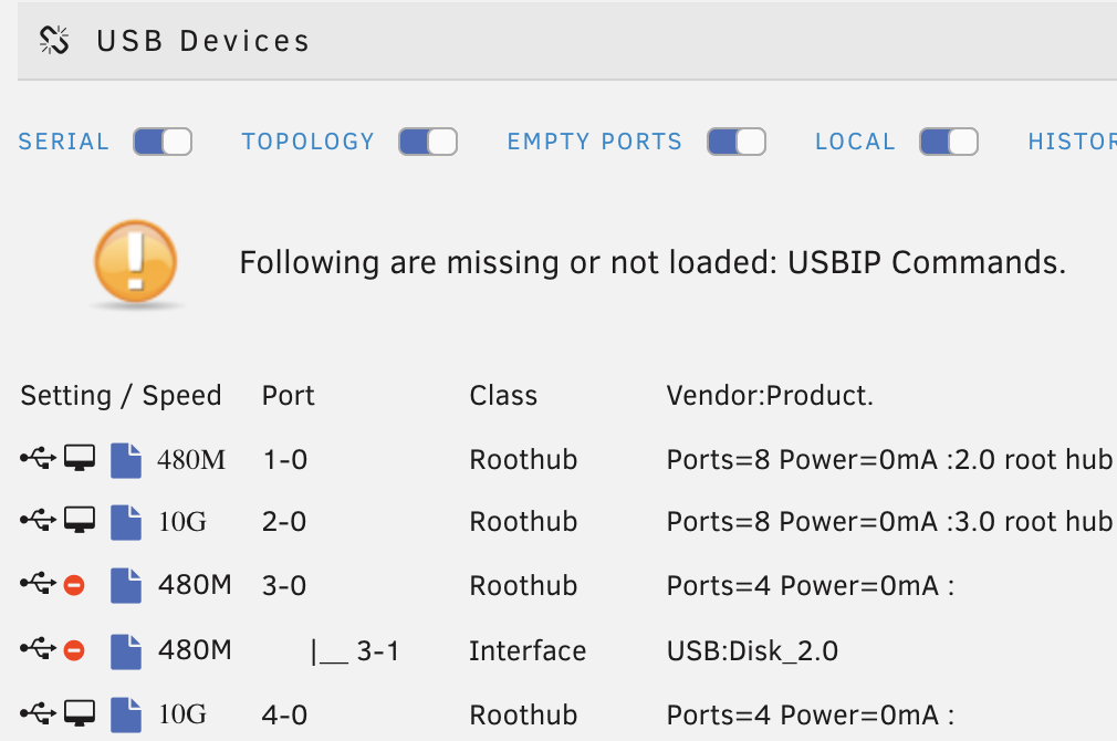

  10. Enclosure & disk work with another PC. I just tried a different USB port. Also doesn't seem to work. Sending another diagnostic log. Thanks for your help! Also noticed that I have a tab "USB", which gives me below info. Maybe that can help lead to the solution? tower-diagnostics-20260110-1041.zip

  18. Yes. Did disconnect and reconnect the usb cable before the diagnostic. Within 5min or so. If not software related, any idea how I can troubleshoot this issue?

  21. Thanks for your help and sorry for late reply. Unfortunately, I am still facing the same issue. I changed to a single-devices USB enclosure for easier problem-solving. Please see below diagnostic log. Thanks! tower-diagnostics-20260110-0749.zip
