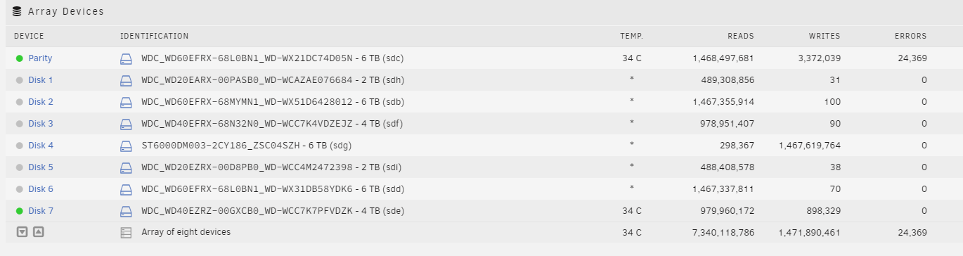

  4. Amazing, my docker works now. Thank you! (EDIT: I installed duplicate-file-handler to check the state of the drive and it just hangs, I then checked the docker images and it's putting them on disk 7, so it's filling up and breaks the dockers again. I think I need to move them to another drive in that case) I still have this issue though, and a disk7 full of the stuff I moved to disk1 Is it as simple as formatting disk 7 now and it should stop getting confused? Mapped drive: Network location (with the right password)
  5. Jul 7 18:54:46 Wintermute ool www[13295]: /usr/local/emhttp/plugins/dynamix/scripts/reiserfs_check 'start' '/dev/md7p1' 'WDC_WD40EZRZ-00GXCB0_WD-WCC7K7PFVDZK' '' Nothing again, both for CLI and GUI. It seems to start to run then ignore it all. I tried deleting a file off disk 7 and it shows a permissions error. or it deletes and hides it until you reboot. I saw this in the logs last reboot
  6. I've rebooted the server a few times, and it didn't even start the first 2 tries, now this. Jul 7 16:37:29 Wintermute ool www[12116]: /usr/local/emhttp/plugins/dynamix/scripts/reiserfs_check 'start' '/dev/md7p1' 'WDC_WD40EZRZ-00GXCB0_WD-WCC7K7PFVDZK' '' or reiserfsck 3.6.27 Will read-only check consistency of the filesystem on /dev/md7p1 Will put log info to 'stdout' ########### reiserfsck --check started at Mon Jul 7 16:37:29 2025 ########### Replaying journal: Replaying journal: Done. Reiserfs journal '/dev/md7p1' in blocks [18..8211]: 0 transactions replayed Or via CLI Also worth noting that I checked all the cables in the machine, nothing loose.
  7. And now this after the restart. I think it's because the drive is full, but I can't see an easy way to confirm it moved all the files other than scrolling 2 screens side by side right now I've worked out a way to do it. Top level file structure and 'calcultate' Movies is 3 files different, no big deal, Disk 1 (the newer is the largest) The only area of significant difference is 'appdata' which appears to be about 0.9gig larger on the old drive. I suspect this is down to it still updating as I'm doing stuff, but to the old drive! That's also insanely large for a small database of watched episodes etc! I tried to delete some things from both drives via the unraid GUI, but the stuff on disk 7 just stays, no error, nothing. It does remove on disk 1 though! I'm thinking at this stage it's wipe disk 7, and maybe repoint the docker images to disk 1?
  8. I also ran it on disk 1 Phase 1 - find and verify superblock... Phase 2 - using internal log - zero log... - scan filesystem freespace and inode maps... - found root inode chunk Phase 3 - for each AG... - scan (but don't clear) agi unlinked lists... - process known inodes and perform inode discovery... - agno = 0 - agno = 1 - agno = 2 - agno = 3 - agno = 4 - agno = 5 - process newly discovered inodes... Phase 4 - check for duplicate blocks... - setting up duplicate extent list... - check for inodes claiming duplicate blocks... - agno = 0 - agno = 1 - agno = 2 - agno = 3 - agno = 4 - agno = 5 No modify flag set, skipping phase 5 Phase 6 - check inode connectivity... - traversing filesystem ... - traversal finished ... - moving disconnected inodes to lost+found ... Phase 7 - verify link counts... No modify flag set, skipping filesystem flush and exiting. After that I was unable to start the array again, no error just nothing after pressing start. Rebooted unraid and it works again.

  11. Ah thank you, that makes sense, I've ordered a drive and I'll get that running asap Typical that it dies the second I buy a new one.
  12. Thank you! So am I right in thinking then that: Step 1 is take out the replacement drive since parity failed. Step 2 replace the parity drive Step 3 New drive to expand space And thank you again for helping, I find I don't have to think about my server for so long that when I do I question all the basics again!
  13. WDC_WD60EFRX-68L0BN1_WD-WX21DC74D05N-20230713-2207.txtWell it jumped from 20% to complete really quickly. Took 90-120 mins Staring at it, I've realised I don't know how to interpret that at all these days!
  14. Cool, I'm running the long smart test on the parity drive now. I'll report back in about 12 hours I guess! Thank you
