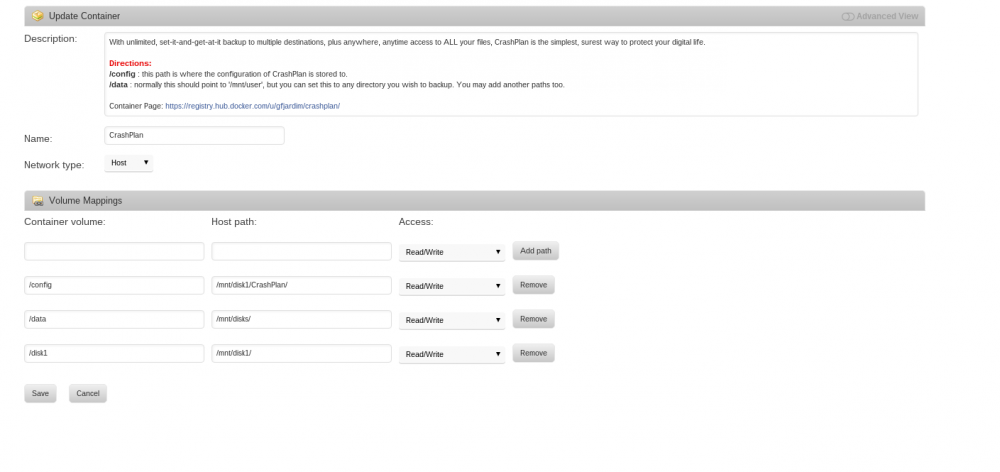

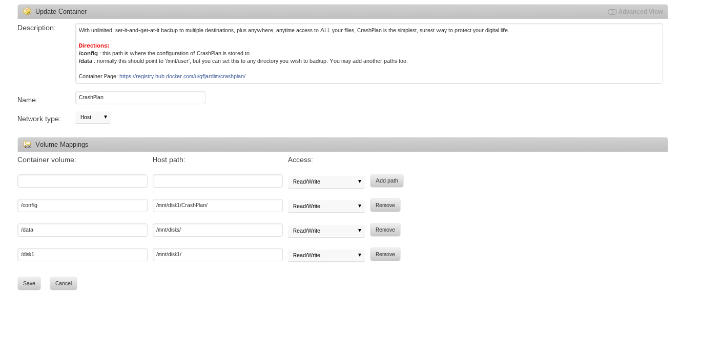

  4. Hello I'm stuck with this question "Q) Why is Crashplan storing backups in my docker.img?", ive tried the steps suggested and its still backing up to the image i have mounted an smb share of another nas using unassigned devices... please help Kind Regards Ryan

  6. That was my theory as well, the backup data should be going to a volume on the nas drive i use but as you said it looks like its going to the docker img... how do i change the config file to reflect this ?

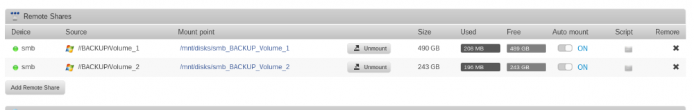

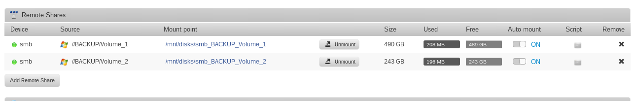

  7. I've tried to backup 157GB of data to a NAS via the unassigned plugins add on for unraid but the crashplan desktop app is telling me that it's out of space at 7GB into the backup, i have moved the config of crashplan from my unraid flash to a larger drive and have mapped the remote shares in crashplan what am i missing ?

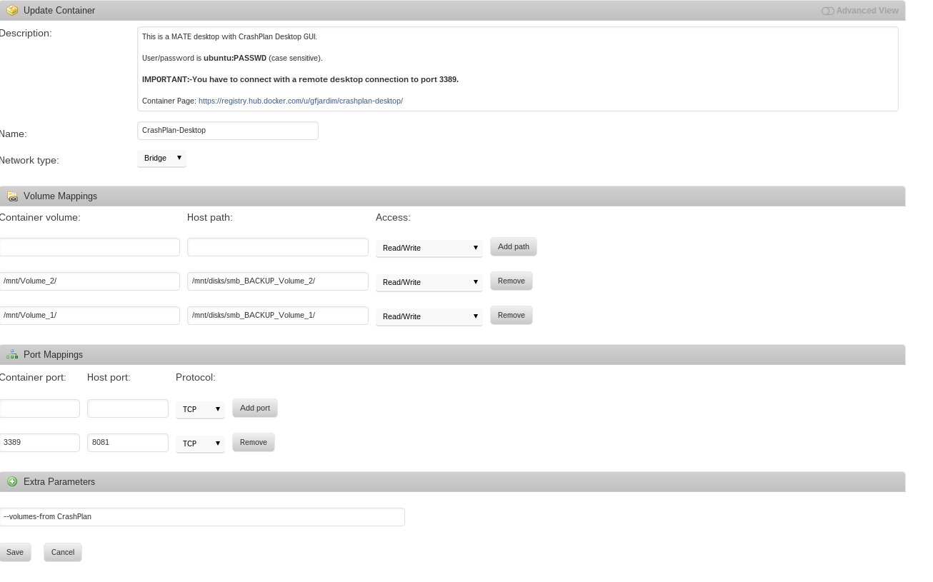

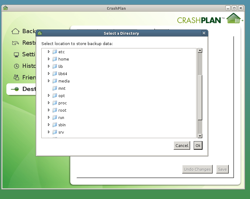

  10. Hello im trying to use crashplan to backup to my NAS from unraid, i have the unraid unassigned devices plugin installed and the shares mount correctly inside the docker container however crashplan can't see the folders i've attached screenshots any advice would be appreciated
