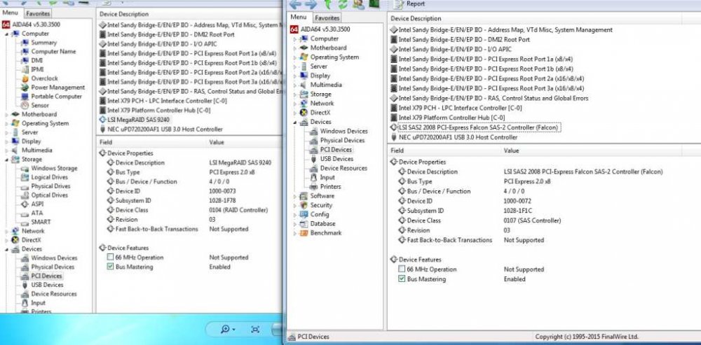

  3. Yes, it's quite up to date but remember the H310 is limited to 25 queue depth in firmware - Avagos firmware is set up for 600. Can't find it now but I read a site that showed a few different fw differences between these cards and the Lsi/Avago is the prefered fw. An update, I managed to flash P16 It and bios and got rid of Nvdata version mismatch but I cant flash the ir as it complains I can't write ir over it fw. Not giving up yet. Also, added the original Dell Precision H310 serial boot rom for your collection + a picture showing Dell H310 on the left and Lsi 9211 on the right with device id/subsystem info. Sbr name changed to txt. DellPrecisionH310.TXT
