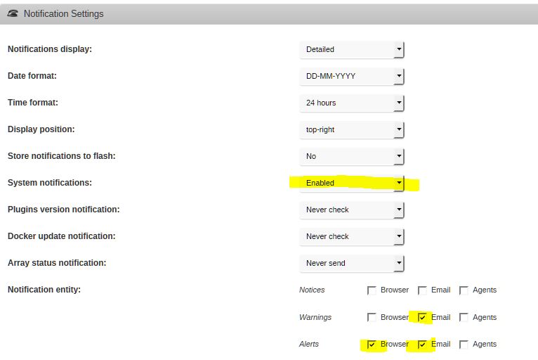

Hi, I already tried turning off directory cache and shares and dockers. I also installed the file activity plugin, which displayed no activity on the NTSF drives, And just to be sure that i'm not wrong, i reenabled system notifications and guess what happend? poof... all NTFS drives spon up immediatly. I attached the settings which are causing this behaviour. cya
Hi, I think the problem is, that unRaid checks all drives regulary (i think 5 or 10 second interval based on observation of spin ups) when system notifications are on so that unRaid can immediatly send warning notifications via email etc. The problem is, that these checks are somehow incompatible to the UD plugin, causing the drives to spin up. All drives are 4TB Seagate drives mounted as NTFS drives. cya
Hi, they won't spin up when requesting standby status via hdparm. Already tested it. So that's not the reason why they're spinning up when UD and system reports are enabled. And if UD is disabled, they spin down with system reports enabled. So it's cleary a bug in UD. cya
Hi, There is a problem with UD drives and System notifications enabled. If System notifications are enabled, UD drives won't spin down. If i try to spin down an UD drive with hdparm -y /dev/sd* it spins up a few seconds later again. Raid drives do not show this behaviour and will spin down accordingly to the spindown setting. It seems that when System notifications are enabled, there's a regular polling of SMART values like temperature etc. While the RAID drives can handle this accordingly and won't spin up, the UD drives are spinning up--- Please fix it. cya
