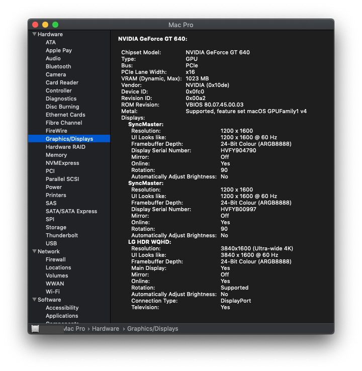

Yeah, the GT 640 isn't fully supported (no boot screen) but it does boot to login and Metal is supported! -

FWIW: I'm using a $30 NVIDIA GT 640 1GB (the one with a Display Port on it) passed through in Mojave with native Metal support. Not the fastest GPU out there but it works until the webdrivers are published. -
