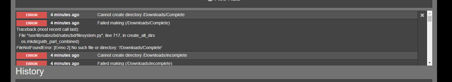

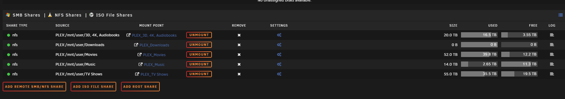

  16. Hello everyone, I have two unraid systems, one is my primary system which has plex and my storage. My second one is my containers/vm system and I connect the shares NFS via unassigned plugin. However, it will frequently become disconnected to my Plex server. The one that disconnects the most is my Downloads share, but my movies share disconnects sometimes as well. This is what it looks like when it disconnects. Then I get this kind of error I have attached diagnostics as well incase its needed. Any help is appreciated. tower-diagnostics-20230202-1640.zip
