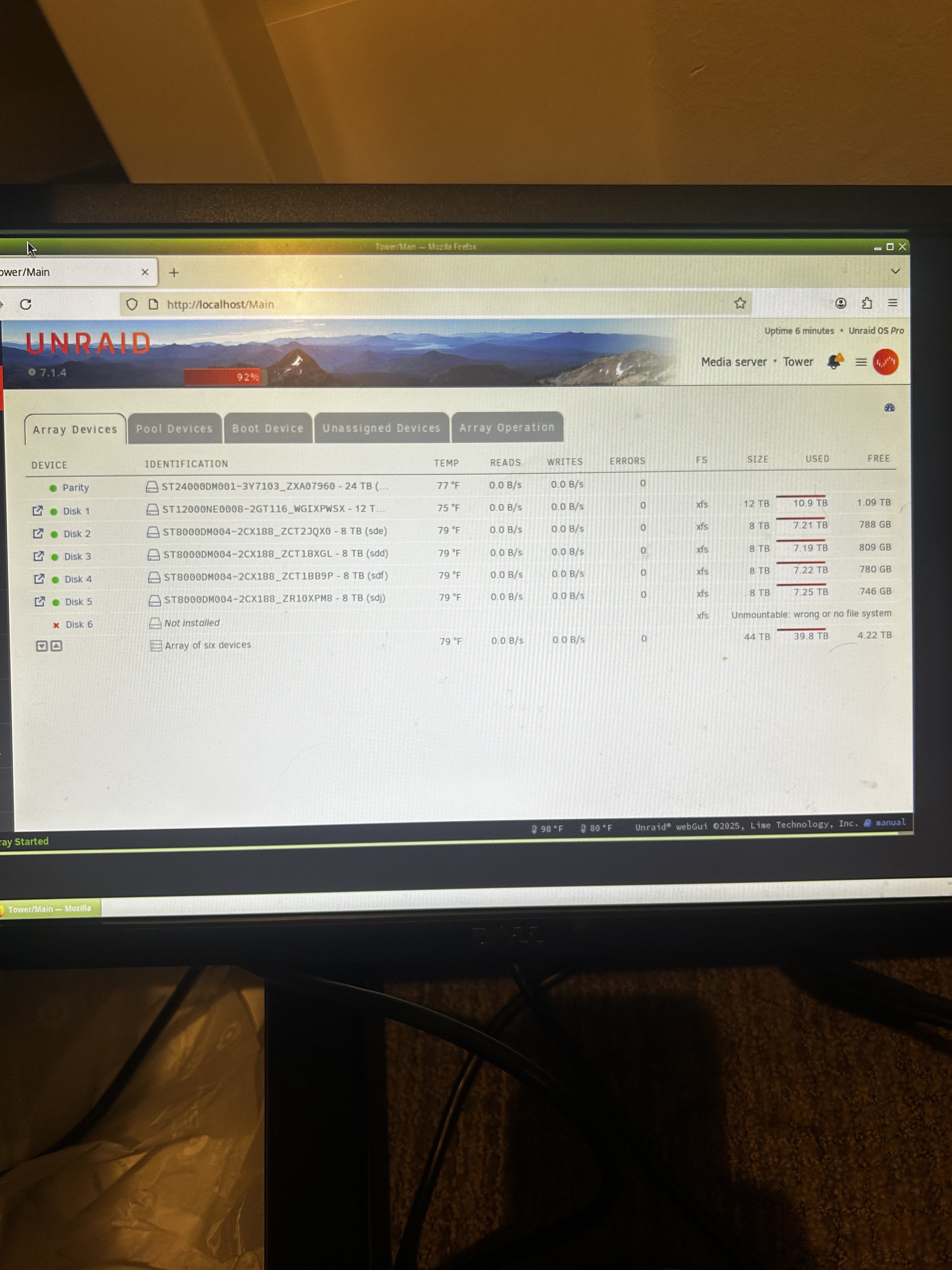

  1. Making progress! i can access the GUI, and I have all my disks present, now just missing plugins and apps.
  2. Stock install works, and I'm able to load in to the GUI. As soon as I add the config folder, I'm not able to access it.
  3. Sorry, forgot to mention it did not boot with a stock install
  4. Im at a complete losshere. I recreated the flash with the creator and replaced my /config but still no boot into Unraid OS. It boots into Unraid OS GUI mode, and I'm able to rebuild data, but no web access.

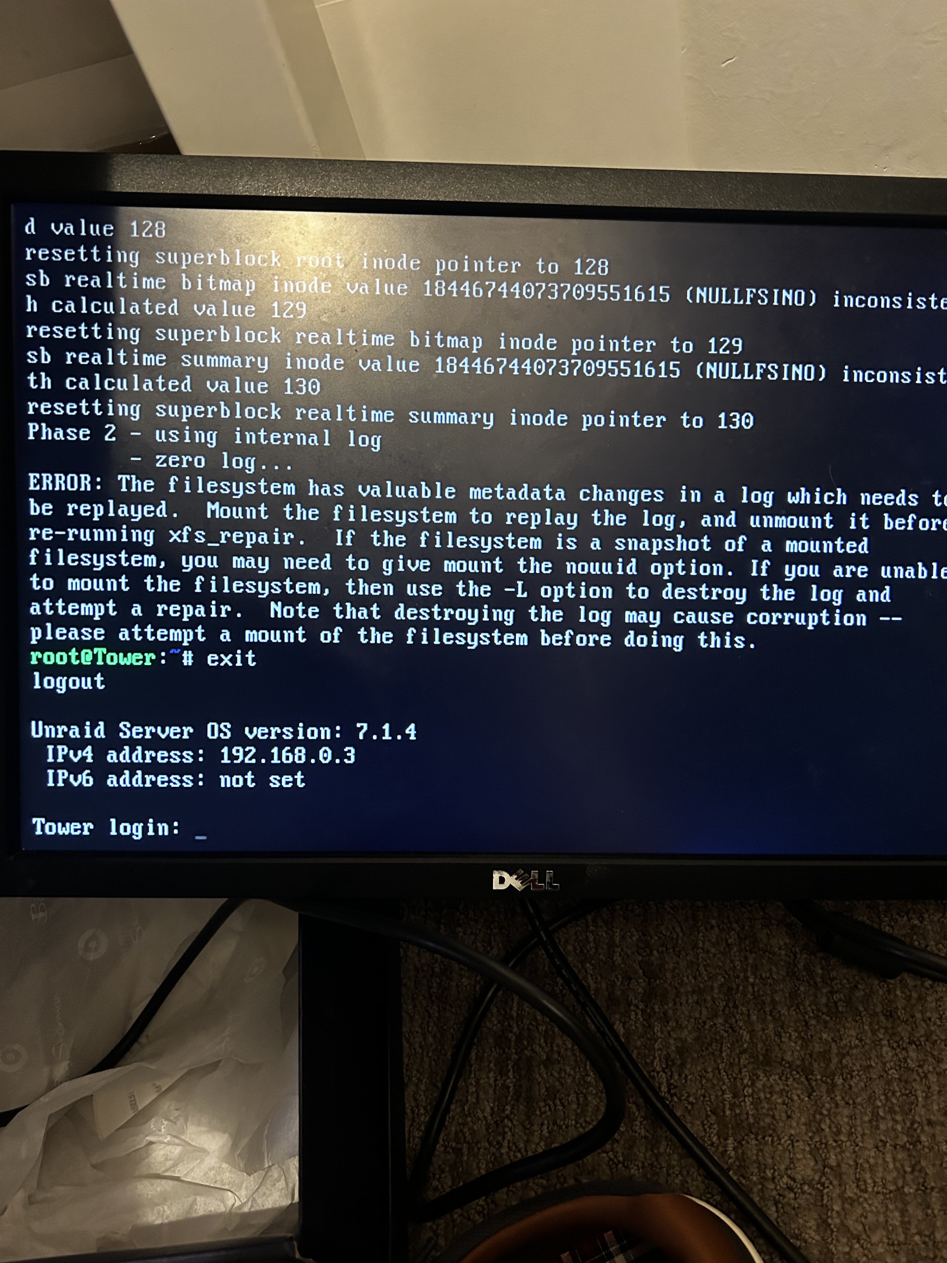

  7. The 12TB disk was the original disk. But it was an older parity drive I repurposed. I have a new 14TB ready to replace it These are the steps I took. Start the array in Maintenance Mode. Run the following command: xfs_repair -v /dev/md6p1 Now it gives me the error Next step was xfs_repair -L /dev/md6p1 That seemed to fix the issue. Now the only issue I have is that I'm not able to access the GUI when Unraid finishes booting. I can choose Unraid OS GUI at startup, but this doesn't start the Docker

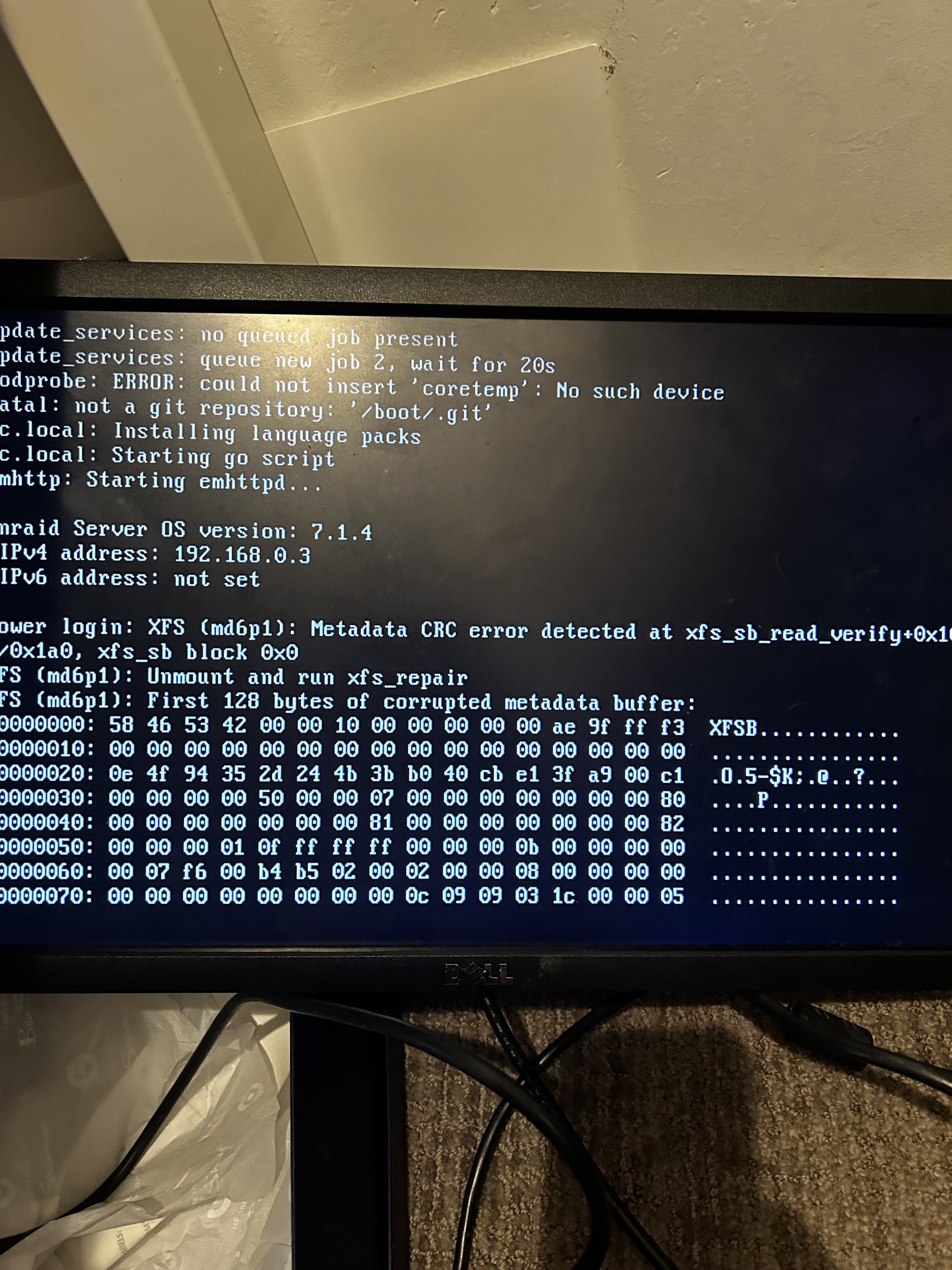

  8. I had a drive start to fail and had to reboot before I could swap in a new drive. I'm not sure if I attempted xfs_repair correctly. Any help would be appreciated! tower-diagnostics-20260228-0555.zip
