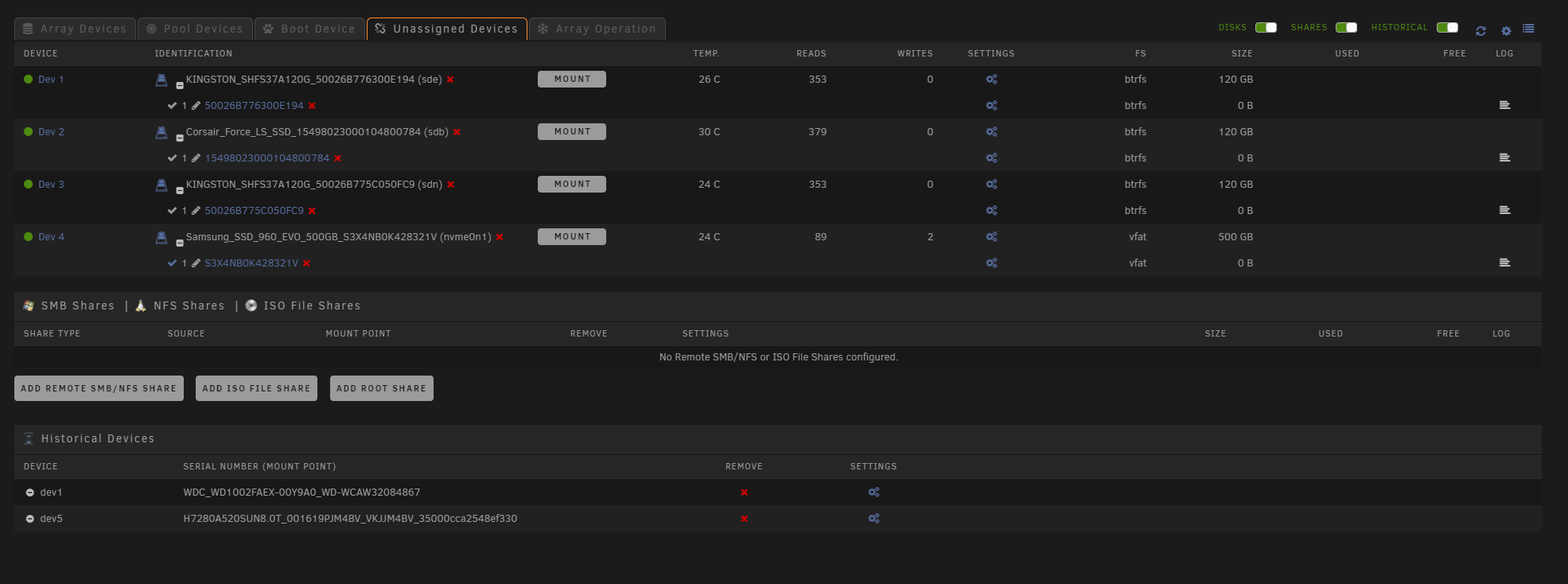

  9. I just tried to erase and format an nvme drive and I selected btrfs and got vfat and now I cant mount it... Is this normal? Mar 20 20:45:50 Datasaurusrex unassigned.devices: Removing all partitions from disk '/dev/nvme0n1'. Mar 20 20:47:32 Datasaurusrex unassigned.devices: Format device '/dev/nvme0n1'. Mar 20 20:47:32 Datasaurusrex unassigned.devices: Device '/dev/nvme0n1' block size: 976773168. Mar 20 20:47:32 Datasaurusrex unassigned.devices: Clearing partition table of disk '/dev/nvme0n1'. Mar 20 20:47:32 Datasaurusrex unassigned.devices: Clear partition result: 1+0 records in 1+0 records out 2097152 bytes (2.1 MB, 2.0 MiB) copied, 0.0107248 s, 196 MB/s Mar 20 20:47:34 Datasaurusrex unassigned.devices: Reloading disk '/dev/nvme0n1' partition table. Mar 20 20:47:34 Datasaurusrex unassigned.devices: Reload partition table result: /dev/nvme0n1: re-reading partition table Mar 20 20:47:34 Datasaurusrex unassigned.devices: Creating Unraid compatible mbr partition on disk '/dev/nvme0n1'. Mar 20 20:47:34 Datasaurusrex kernel: nvme0n1: p1 Mar 20 20:47:34 Datasaurusrex unassigned.devices: Create mbr partition table result: write mbr signature done Mar 20 20:47:36 Datasaurusrex unassigned.devices: Reloading disk '/dev/nvme0n1' partition table. Mar 20 20:47:36 Datasaurusrex kernel: nvme0n1: p1 Mar 20 20:47:36 Datasaurusrex unassigned.devices: Reload partition table result: /dev/nvme0n1: re-reading partition table Mar 20 20:47:36 Datasaurusrex unassigned.devices: Formatting disk '/dev/nvme0n1' with 'btrfs' filesystem. Mar 20 20:47:36 Datasaurusrex unassigned.devices: Format drive command: /sbin/mkfs.btrfs -f '/dev/nvme0n1p1' 2>&1 Mar 20 20:47:38 Datasaurusrex kernel: BTRFS: device fsid 3eaa032f-8941-45fb-8d24-37c5ba01353f devid 1 transid 6 /dev/nvme0n1p1 scanned by mkfs.btrfs (16143) Mar 20 20:47:39 Datasaurusrex unassigned.devices: Format disk '/dev/nvme0n1' with 'zfs' filesystem: btrfs-progs v6.0.1 See http://btrfs.wiki.kernel.org for more information. Performing full device TRIM /dev/nvme0n1p1 (465.76GiB) ... NOTE: several default settings have changed in version 5.15, please make sure this does not affect your deployments: - DUP for metadata (-m dup) - enabled no-holes (-O no-holes) - enabled free-space-tree (-R free-space-tree) Label: (null) UUID: 3eaa032f-8941-45fb-8d24-37c5ba01353f Node size: 16384 Sector size: 4096 Filesystem size: 465.76GiB Block group profiles: Data: single 8.00MiB Metadata: DUP 1.00GiB System: DUP 8.00MiB SSD detected: yes Zoned device: no Incompat features: extref, skinny-metadata, no-holes Runtime features: free-space-tree Checksum: crc32c Number of devices: 1 Devices: ID SIZE PATH 1 465.76GiB /dev/nvme0n1p1 Mar 20 20:47:42 Datasaurusrex unassigned.devices: Reloading disk '/dev/nvme0n1' partition table. Mar 20 20:47:42 Datasaurusrex kernel: nvme0n1: p1 Mar 20 20:47:42 Datasaurusrex unassigned.devices: Reload partition table result: /dev/nvme0n1: re-reading partition table Mar 20 20:47:57 Datasaurusrex unassigned.devices: Mounting partition 'nvme0n1p1' at mountpoint '/mnt/disks/S3X4NB0K428321V'... Mar 20 20:47:57 Datasaurusrex unassigned.devices: Mount cmd: /sbin/mount -t 'vfat' -o rw,noatime,nodiratime,nodev,nosuid,iocharset=utf8,umask=000 '/dev/nvme0n1p1' '/mnt/disks/S3X4NB0K428321V' Mar 20 20:47:57 Datasaurusrex kernel: FAT-fs (nvme0n1p1): utf8 is not a recommended IO charset for FAT filesystems, filesystem will be case sensitive! Mar 20 20:47:57 Datasaurusrex kernel: FAT-fs (nvme0n1p1): bogus number of reserved sectors Mar 20 20:47:57 Datasaurusrex kernel: FAT-fs (nvme0n1p1): Can't find a valid FAT filesystem Mar 20 20:48:00 Datasaurusrex unassigned.devices: Mount of 'nvme0n1p1' failed: 'mount: /mnt/disks/S3X4NB0K428321V: wrong fs type, bad option, bad superblock on /dev/nvme0n1p1, missing codepage or helper program, or other error. dmesg(1) may have more information after failed mount system call. ' Mar 20 20:48:00 Datasaurusrex unassigned.devices: Partition 'S3X4NB0K428321V' cannot be mounted.

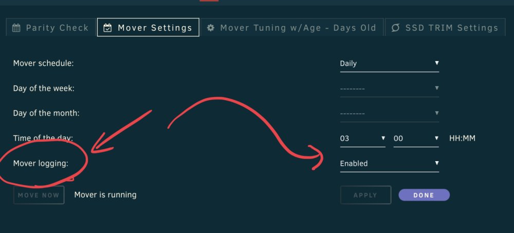

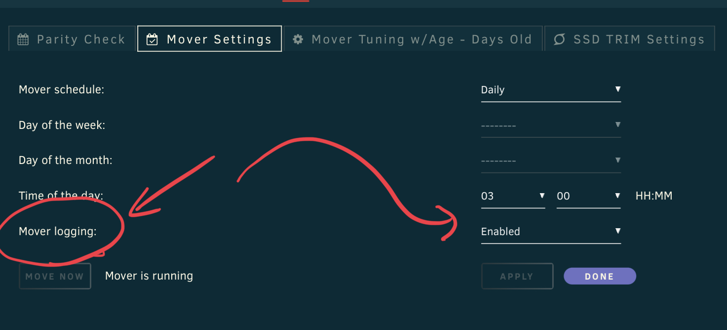

  10. The reason I said that was because in your initial post, you showed paths on the flash drive (/boot). Now that you moved them and made them executable I think you should be good. You need to enable mover logging on the main ‘Mover Settings’ tab and then you will see everything it does in the syslog. As a side note you really should check out the Trash Guides link that I placed above. His script is well vetted and supported by a large community and much more advanced. It uses the qBittorrent api to pause your torrents, run the mover, then resume your torrents. No shutting down or shopping any services and no before after scripting in the somewhat buggy mover tuning plugin.
  11. EDIT: So I am working through something similar and I believe the issue you will find in the logs if you turn them on is that the script cannot be run because of permissions issues. My understanding is that recent updates to Unraid prevent scripts from being run on the flash drive without specifying a run command which as far as I can tell is not possible to do within the mover tuning plugin. See below. Therefore all I did to get around this was move the script from the flash drive to my cache drive and made in executable. Update the path in the mover tuning plugin and now it works well. ORIGINAL POST: Try turning on logging and see what’s in the syslog. This should let you know if and why the scripts are not being run. If you are using qbittorrent with any kind of automation, I would highly recommend you check out trash guides. https://trash-guides.info/Downloaders/qBittorrent/Tips/How-to-run-the-unRaid-mover-for-qBittorrent/#the-script
