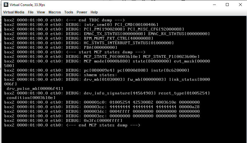

  5. Unraid sometimes crashes after a reboot. I suspect it maybe related to issues I've heard about related to using vlans, but I can' t be sure. As of right now, my box is scrolling this on the screen over and over. I did see I had a logon prompt when I pressed the <enter> key a few times, but I'm not able to log in and can't seem to do anything other than reset. Based on the bnx2, I think it is related to a nic issue, but thats about all I've been able to find after doing some google searches. Anybody have any clue as to what may be happening? Update: Had to reboot to figure out what version I was running Unraid 6.9.2 Please let me know what information you need and I can provide it. Thanks!
