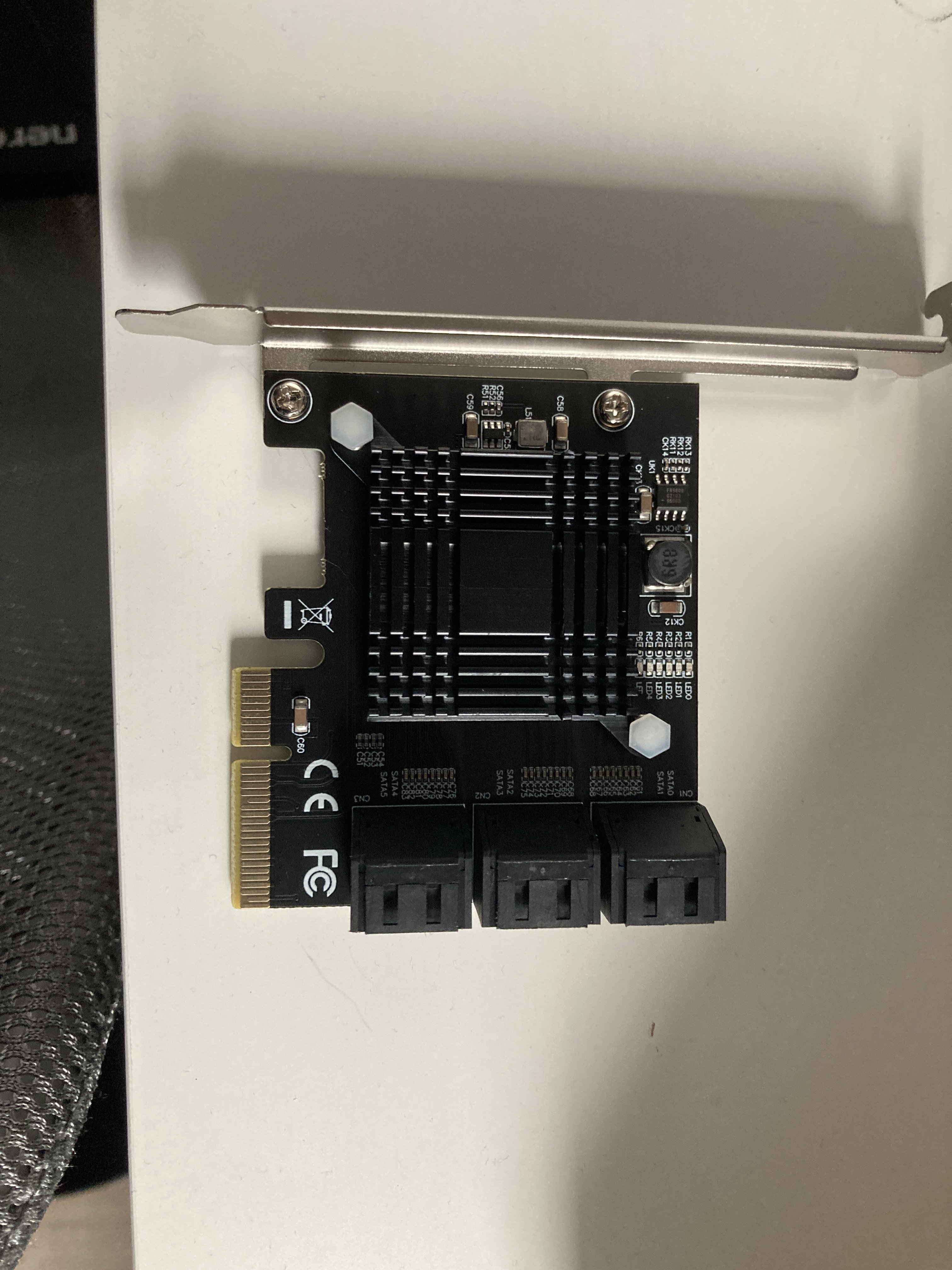

Just a quick warning. Because i wanted a new faster controller card to replace my AAR-1430SA i grabbed a rather cheap (30€) Sata controller card with ASM-1166 chipset from Amazon. Okay they shipped a different model than it was advertised on the photos but okay, nearly all of the ASM1166 are unlabled etc. You can only differ them by the board Layout etc. What i got was that here: Using it resulted in kicked out drives etc. For gods sake with much help here in the Forum the situation was manageable. I dont know if the card is faulty or if the model is crap, but at least i could return it to Amazon. What i ordered now was a bit more expensive model, hopefully it works better: https://smile.amazon.de/dp/B09K4WKHKK?psc=1&ref=ppx_yo2ov_dt_b_product_details

Rebuild went okay, seems that everything worked out. Files are readable at least. Its mainly Media files, so if there is a bitflip anywere it is not the end of the world. That is the ASM1166 Card card which seemed to be faulty, there is no labeling etc: I have returned it to Amazon and ordered another one: https://smile.amazon.de/dp/B09K4WKHKK?psc=1&ref=ppx_yo2ov_dt_b_product_details Hopefully that works better.

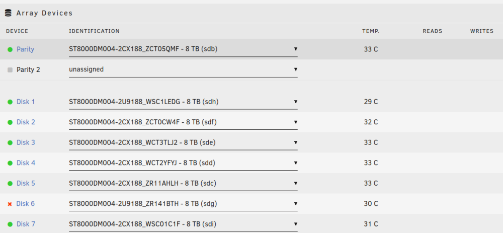

Okay power down, remove WD Drive, place the Seagate, assign it to Slot 6 and than bring array up and start rebuild?

So rebuild it onto the old WD Drive or the newer (previously unsused) Seagate does it matter?

Thanks, also the rebuild was on a fresh disk, not on the one with the red cross.

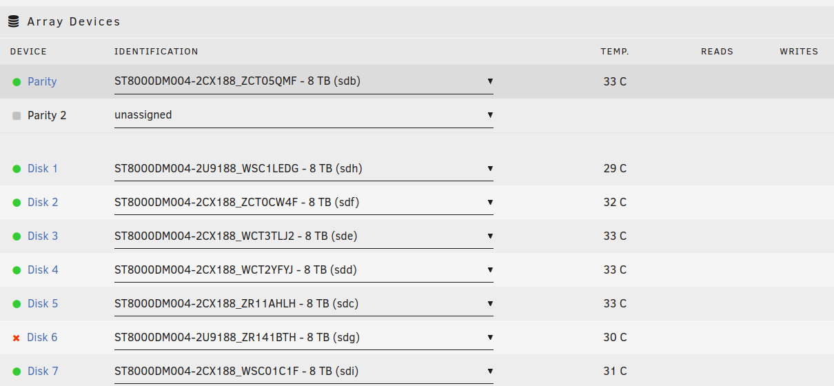

So WD Drive went Red, replaced it with a fresh Seagate, tried to rebuild, Disk 7 went red, stopped the rebuild, than placed WD back. Done nothing more. The Smart report of the WD drive was good, when i recall it right. So i doubt the HDD failed. Maybe the controller was no good.

Hold on stop, let me explain further, really sorry i an so confused right now. Let me recall what i have did befor i switched back to the old card. You are correct, i did tried to rebuild. I placed a new disk to slot 6. Then the disk 7 went red while rebuild. So i stopped the rebuild, and switched back to the WD Drive which is now in. Really sorry i am not really concentrated right now.

Beeing honest i dont know. Never had such a problem before. Is there anyway i can checkt if the contents of the disk are okay without starting the array? It showed that way after the second reboot when i switched back the controller, althouiugt i dont know if the array was autostarted. Was a bit confused
