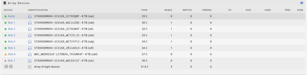

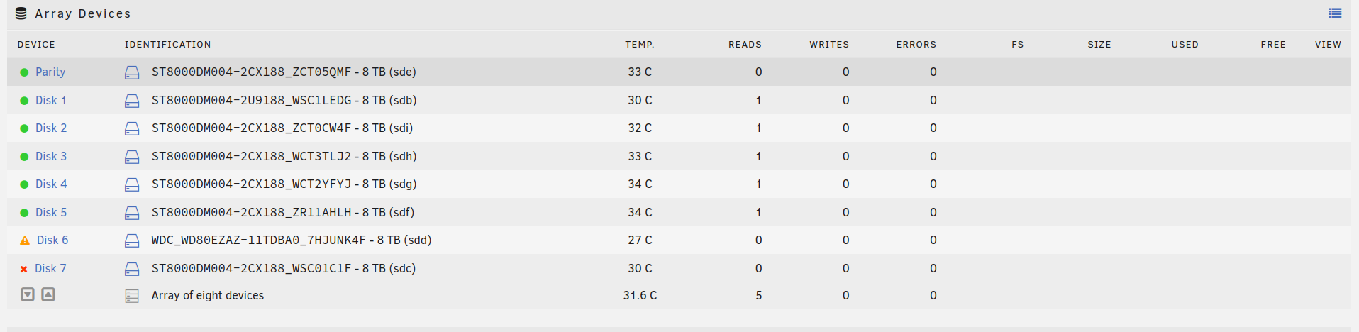

One disk with red cross another Orange what to do?
Yes thats correct, disk6 was disabled first. htms-diagnostics-20230105-1720.zip
Hi there, i think i have a big problem now. After changing my Sata controller card i now have one disk with a red cross and one with an orange warning sign. Have not started the Array in normal mode only in Mainatanance Mode. I also have switch back to the old controller card. What can i do now? Is my data lost? Parity should be valid because i had no writes to it since i switched the card. Is there any hope?
