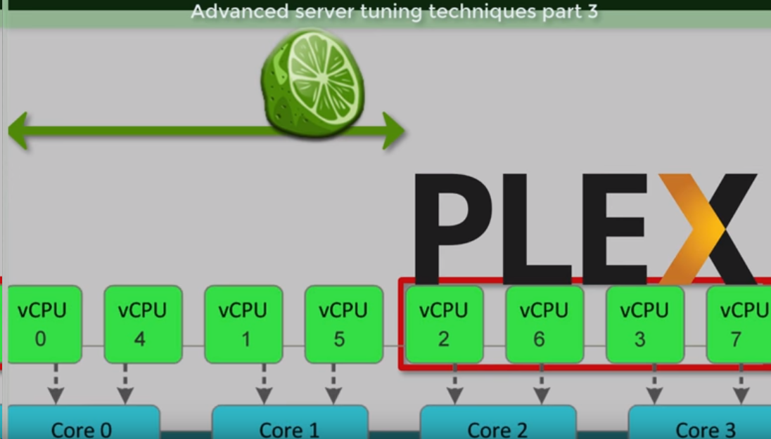

  16. So what's the point in isolating cores? Sorry if I've misunderstood.
  17. Thanks for the reply, I guess it was this part of the video I must have misunderstood. My question now is, is there any way at all to pin multiple cpu cores exclusively for docker applications? Thanks
  18. More info that should be useful. The error stated above says that Plex "will only execute on a single isolated core" As you can see here, I pinned 10-15,26-31 for Plex. On the dashboard I have this, clearly showing one core at 100% Did I misunderstand advanced tweaks from @SpaceInvaderOne ???? Many thanks
  19. After reading what I wrote I would like to clarify, If I understand correctly, I could pin Plex to 4 cores but it will only ever use one? Is that correct?
  20. Hi, After watching many of the excellent videos by SpaceInvader One, I decided to isoloate some cpus from UNRAID and the pin them to one VM and my Plex docker. However since doing this I have this error message from the "fix common problems" plugin, ERRORS FOUND SUGGESTED FIX Docker Application plex has multiple CPUs pinned to isolated CPUs Unless you know exactly what you are doing, pinning a docker application to multiple isolated CPUs will only allow the application to execute on a single isolated core and adjust either the Isolated CPUs or the application's CPU pinning I upgraded to Version 6.6.0 the other day without issue. Here's the line I added, isolcpus=4-15,20-31 and wanted to pin 4 or 6 cores to Plex. https://youtu.be/p0iPpPyebUw?t=517 Any advice please?
