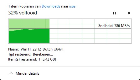

  21. Thanks.👍 A 10GB dummy file tops out at 586MB/s. Conclusion: a 5gbit switch is enough.
  22. Are sata3 ports not limited to 600MB/s ?? I'm transferring an iso file from nvme to sata ssd over 10gbit network and it tops out at 822MB/s.
