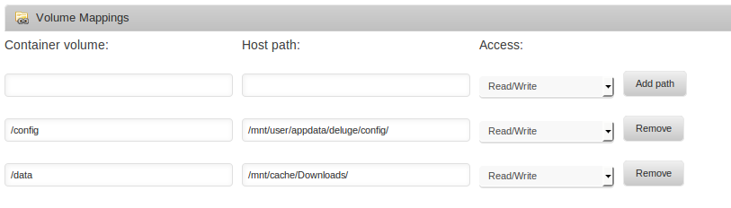

  8. After support from binhex, I was finally able to connect to my VPN provider. Downloads though were saving to my docker.img file which was causing problems. I deleted the DelugeVPN docker to clear everything out and started form scratch. I created a new user share on my cache drive specifically for downloads labeled "Downloads". Now I have DelugeVPN's settings mapped to /mnt/cache/Downloads/ but nothing will download... Help! lol
  9. Thank you so much for your help! Things seem to be running fine and I'm now able to launch the WebGUI

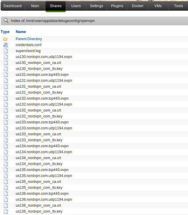

  10. Please attach your supervisord.log file Attached. I have starred out my username and passwords. This is your issue:- [crit] Missing OpenVPN configuration file in /config/openvpn/ (no files with an ovpn extension exist) please create and restart delugevpn So you need to have a openvpn config for from your vpn provider, see the FAQ section in post #2 Q2 for how to get this running with a custom provider. This is where I have my /config directed to (screenshot attached), as you can see i have .ovpn files in there. Or, is this wrong?
