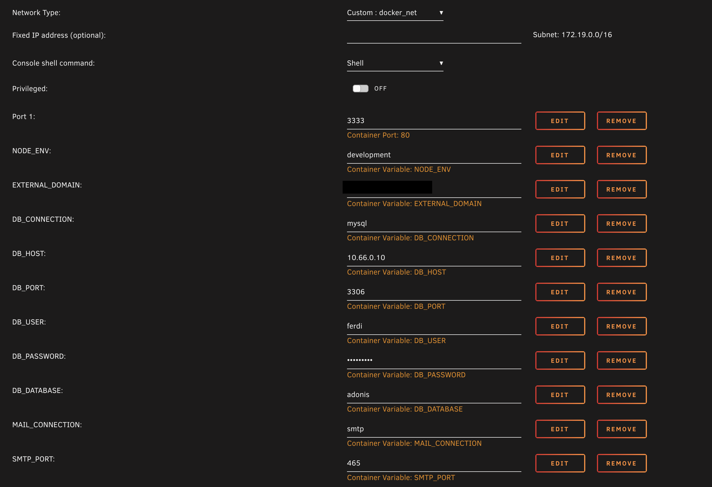

I think most people, including myself, use external databases such as MariaDB, so it definitely works for most people. Have you tried changing your network type from `bridge` to `br0` or another custom docker net that MariaDB is also on? This is what the relevant part of my config looks like:
[Support] xthursdayx - Ferdi-server [archived]
Hmmmm, I really have no idea... Unfortunately (fortunately?), I've never heard of this issue before (and the image has over 100k pulls), so it's kind of baffling. One thing is that I have ferdi-server running on a custom docker-network along with MariaDB and all of my other outward-facing containers, so they share the same LAN network IP range (172.19.0.0/24). I don't feel like not doing that should cause a problem, but something to check perhaps? One thing to note: we're currently completely overhauling the ferdi-server Docker image, so we will be pushing a new image onto Docker Hub in the next week or so which will handle almost everything differently. That doesn't really mean anything for your current issue, but it's just something to know for future planning.

It's hard for me to tell what the issue is based on the screenshot, but I'm wondering if you set up your database correctly? I am using almost the exact same settings as you with no problem. I see in your logs that you have an sql error that says `Access denied for user \`ferdi\`@\`172.17.0.8\`. This may be a stupid question, but did you create a ferdi database and user in MariaDB? It is necessary to manually create the database, user and password, if you want to use an external database.
