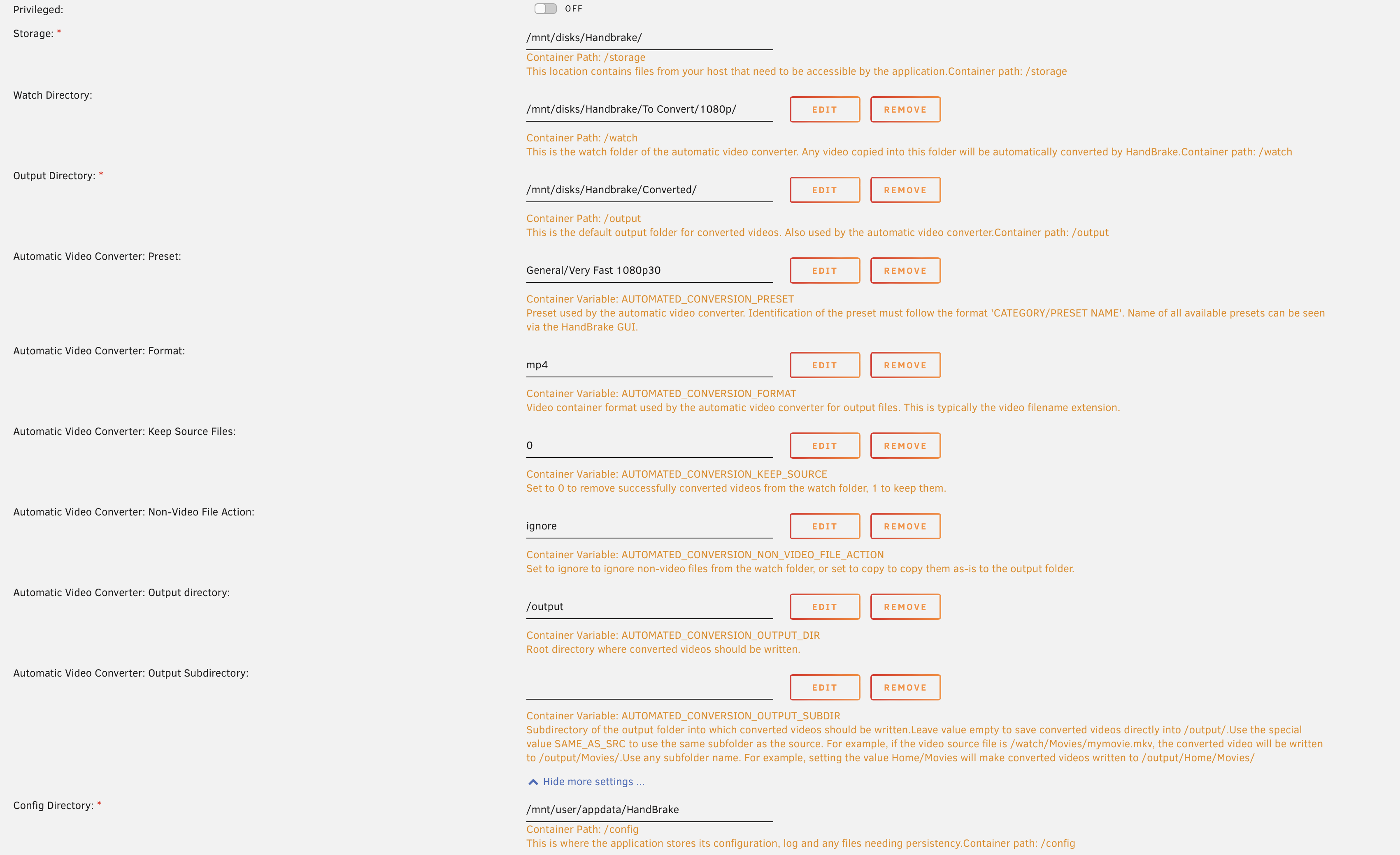

  1. Thanks for the help everyone! I ended up needing to change my Docker settings to point at /mnt so that Handbrake could see my name drive for files to convert and my script could see /mnt/user/Media to move things. I also had to change the permissions on the directories as was mentioned. Thanks again for the help.
  2. I'm overriding the Storage to pass in the Handbrake directory, which is on an nvme drive that isn't my cache drive, or part of the array that I use just for Handbrake. Is that going to be an issue for me?
  3. I am running the script from inside the docker. Do I need to do something special to give it access to the array to be able to move the files for me?
  4. I'm not super familiar with scripting, and sort of going off what I can find from Google, so I'm not sure how to find what user the script is running as. But here's the info from what you asked: ls -l /mnt/user/: drwxrwxrwx 1 nobody users 117 Nov 17 2019 Media/ drwxrwxrwx 1 nobody users 111 Jul 10 15:44 appdata/ drwxrwxrwx 1 nobody users 6 Jun 18 14:37 domains/ drwxrwxrwx 1 nobody users 6 Feb 22 2017 isos/ drwxrwxrwx 1 nobody users 35 Feb 22 2017 system/ ls -l /mnt/user/Media/: drwxrwxrwx 1 nobody users 27 Apr 22 23:32 Kids\ Shows/ drwxr-sr-x 1 nobody users 28672 Jul 10 23:03 Movies/ drwxrwxr-x+ 1 nobody users 167 Jul 10 2021 Plex\ Posters/ drwxr-sr-x 1 nobody users 16384 Jun 24 23:34 TV\ Shows/ The directories all existed previously, although the Kids Shows is recent and I forget if I created it from my Mac or Krusader. The other ones were created like 5+ years ago. I've been manually moving things around in Krusader and relying on Hazel running on my Mac to move things, so was just trying to automate that so it can all happen on the server side. Looking at the Movies and TV Show directories, it looks like they don't have write permissions for not the owner, which I assume is what's causing my problem? Do I just need to use chmod in the terminal on /mnt/user/Media/ to change the permissions, or do I need to do it for the Movies and TV Show directories directly? Thanks for the help!
  5. HI All, I'm trying to setup a post_conversion script that moves converted files from the output directory to my array. I have it working to figure out if it's a TV show or Movie and what the destination path should be, but when I hit my mkdir command in the script, I get the following error in the log: mkdir: cannot create directory ‘/mnt/user/Media/TV Shows/Show/Season 1/’: Permission denied This is the script (I left off the top part with the comment and variables being set from the example): if [ "$CONVERSION_STATUS" -eq 0 ]; then #https://stackoverflow.com/a/24900088 # Successful conversion. FILE="${CONVERTED_FILE##*/}" echo "✅ [$FILE]" # Check for show or movie ISTVSHOW=$(echo "$FILE" | egrep '(S[0-9]+E[0-9]+)') if [ -z "$ISTVSHOW" ]; then # MOVIE DESTINATION="/mnt/user/Media/Movies" else # Get Show Name REMOVE=$(echo "$FILE" | egrep -o ' - S[0-9]+E[0-9]+.*$') LENGTH=${#REMOVE} SHOW=$(echo "$FILE" | rev | cut -c $(($LENGTH+1))- | rev) # Get Season Number CLEANED="${REMOVE:4}" SEASON=$((10#$(echo "$CLEANED" | egrep -o '^[0-9]+'))) DESTINATION="/mnt/user/Media/TV Shows/$SHOW/Season $SEASON" fi # Move the file to the destination, making any directories as needed echo "➡️ $DESTINATION/$FILE" mkdir -p "$DESTINATION/" && mv "$FILE" "$DESTINATION" else # Failed conversion. echo "❌ $SOURCE_FILE" fi I'm hoping it's just a simple thing I don't know about to have the right permissions. Any help appreciated!
