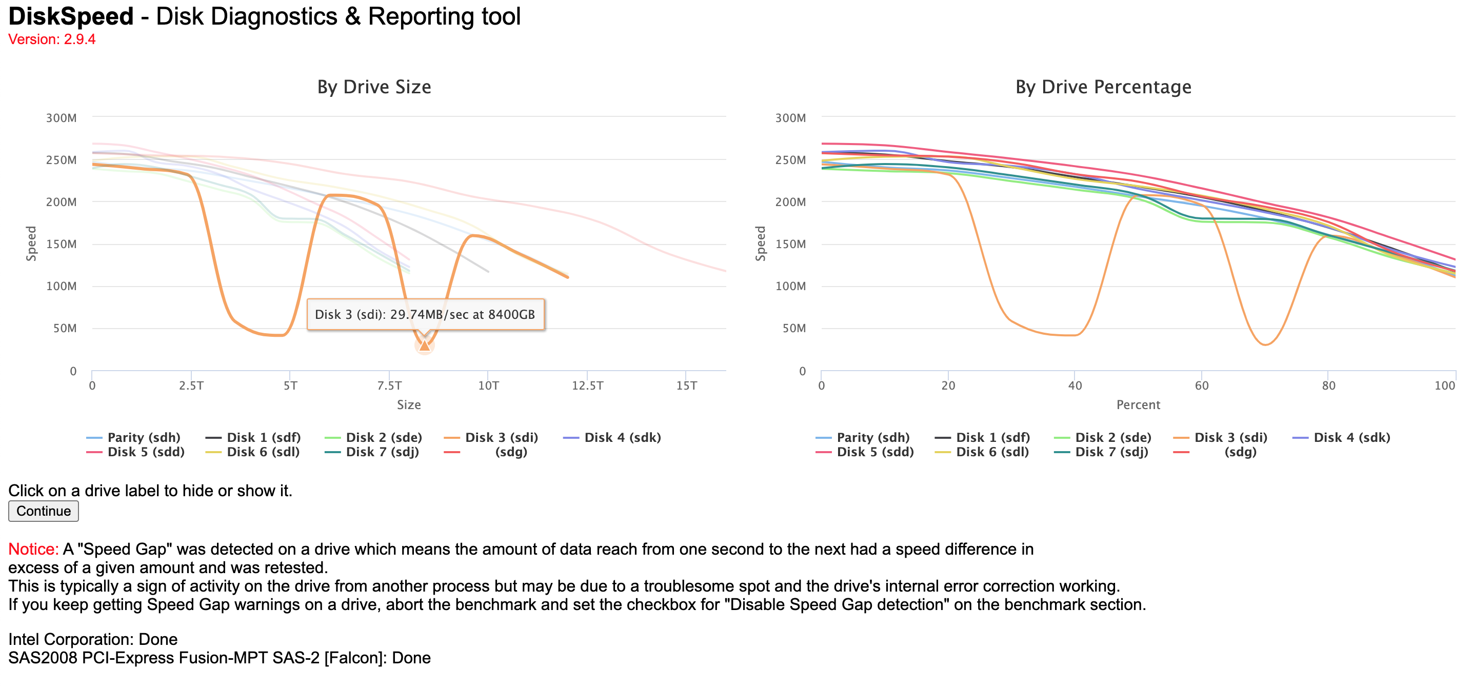

  1. Thanks very much - I will order another drive to replace that one and then play with those tests. The docker is great - the reason I used it was because I am seeing very high CPU IO Wait times when copy operations to the Array are happening and I couldn't pin down the cause. I suspect the issue will be this drive. So thanks for your efforts developing this one.
  2. So ah, what would be the advice given this result... 😰

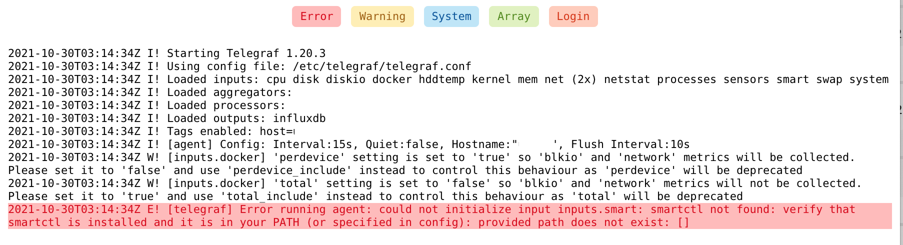

  3. I was having the same problem, noticed it updated over night and now doesn't work. TL;DR this happens in the new version because the docker no longer runs under root and I had some extra parameters that's running `apk` which isn't allowed by the new telegraf user. Longer explain: A google lead me to info about it being a user permission issue: https://stackoverflow.com/questions/50727783/alpine-docker-error-unable-to-lock-database-permission-denied-error-failed-to Then looked at the dockerfile in github, it seems prior to Oct 15, the telegraf docker was running as root. They changed this to use 'telegraf' user, see commit here: https://github.com/influxdata/influxdata-docker/commit/83520188be87cbee6edb3ac995c647cf99acdf51 The error in my case was happening becuase I add some apk pakages by docker settings -> advanced -> Post Arguments /bin/sh -c 'apk update && apk add lm_sensors lm-sensors-detect perl && apk add smartmontools && apk add nvme-cli && telegraf' After removing those argument, I simply get an error in the log because it can't find smart (which was removed): After commenting out inputs.smart in my config I could start telegraf again. In my case, the graphs and data I use actually wasn't affected by not having inputs.smart, so I didn't reconfigure it. But this may help others if they don't want to pin telegraf to an older/specific tag.

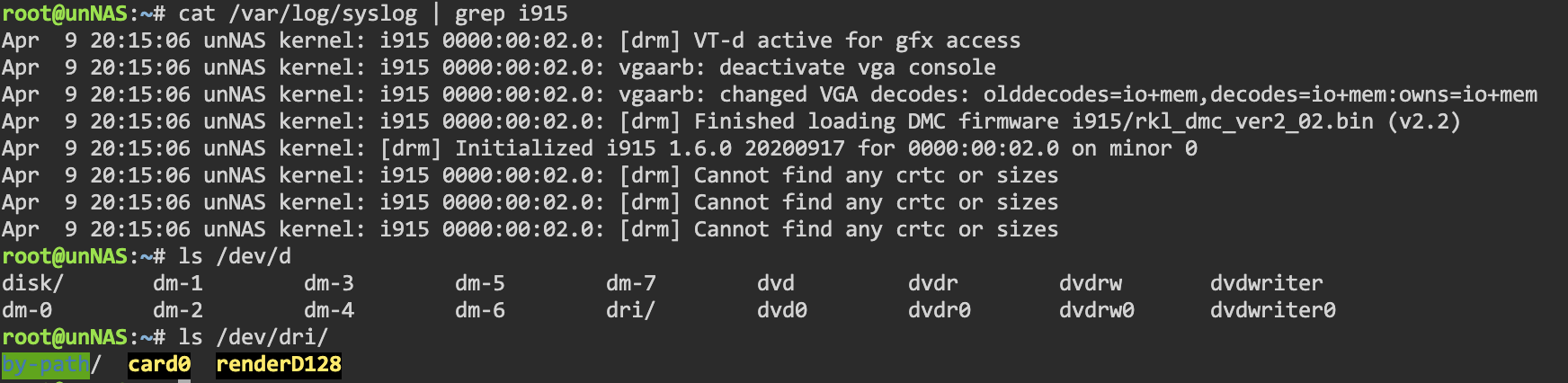

  4. Oh awesome, thanks! Can confirm adding options i915 force_probe=4c8a to /boot/config/modprobe.d/i915.conf worked a treat and I now have the /dev/dri device
