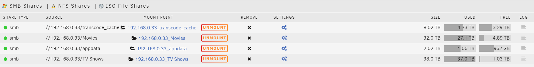

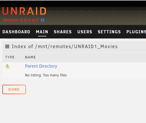

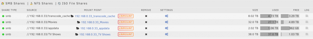

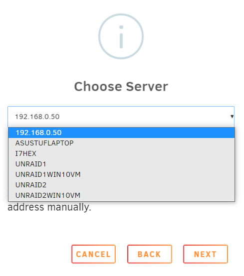

  20. @dlandon Hi, I can confirm that my SMB shares have stayed active! so thanks for that! I wonder if you wouldn't mind letting me know where I stand with the inability to use Jumbo Frames please? I appreciate there is a problem using them but the result is that my setups of 10gbe fibre connections/switch etc cannot be utilized with Jumbo Frames disabled. Is this an unraid issue that will be fixed? Many Thanks
