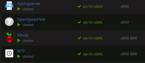

pihole docker on separate vlan - can't access pihole gui
Yes. Yes, too. I notice 10.55.83.10/24 use tag 4091, but you use br0, it should be br0.4091 ? But seem tag over 4000 are special !! Pls note, in Unraid eth0 / br0 means untag, and eth0.5 / br0.5 means tag. Does br0 will pass through to tag 4091 interface ? ( You should ignore above question as you said all valn can access WAN ) Below are my Unraid docker look like, so eth0 are untag and eth0.666 are tag 666 to router's LAN trunk port.
For my understanding, Pihole`s eth0, actually is br0.5. Pihole wouldn't know what's setting outside docker. Pihole eth0 not means Unraid eth0.
Yes, br0 access br0.5 (pihole) shouldn't need enable host access. Then you should focus why console ( assume you said Pihole console ) why can't ping 10.55.5.1 gateway, they are in same subnet.
I also use one ethernet for all vlan, but I use macvlan and not enable bridge. You also need confirm Pihole GUI default accept other subnet to access, I use Pihole to serve different VLAN too, but I only route dns query between VLAN, I didn't family Pfsense as I use hardware router doing all routing.
Problem may be because you use ipvlan and due to one physical ethernet for all vlan, then host network access ( if access to br0.0 ) may need to enable.
