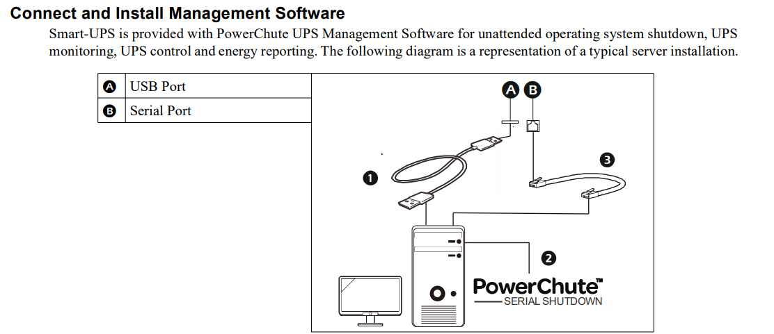

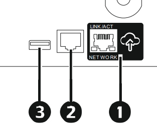

New APC ups
I haven't deeply go through the manual, but APC doc's always not detail. Most cable are USB only, but the RJ50 port may support USB+Serial, my old rack APC UPS have DB9 COM port and RJ50 port, you can use Serial in either DB9 COM port or RJ50 port, but USB only on RJ50. That's not if have DB9 COM, then RJ50 is USB only. That's why I said if use common cable ( USB only ) haven't detect thr USB device then it is connection issue. There a question does OP's UPS RJ50 port also support Serial+USB or USB only or Serial only.
New APC ups
Actually, APC most common cable are USB to RJ50 ( it look like RJ45 but has 10 pin instead 8 pin ), it support USB and Serial in same RJ50 port. But different UPS model will be different, and smt750rm2uc should have stranded RJ45 network port ( most right side ) it native support Ethernet access. If you can found UPS in USB device list then it is not connection issue, otherwise you need try different cable to got UPS detect first.
New APC ups
What plug type in cable end which connect to new UPS ? RJ45 ? For smt750rm2uc, it look like you should use type A to type A USB cable.
