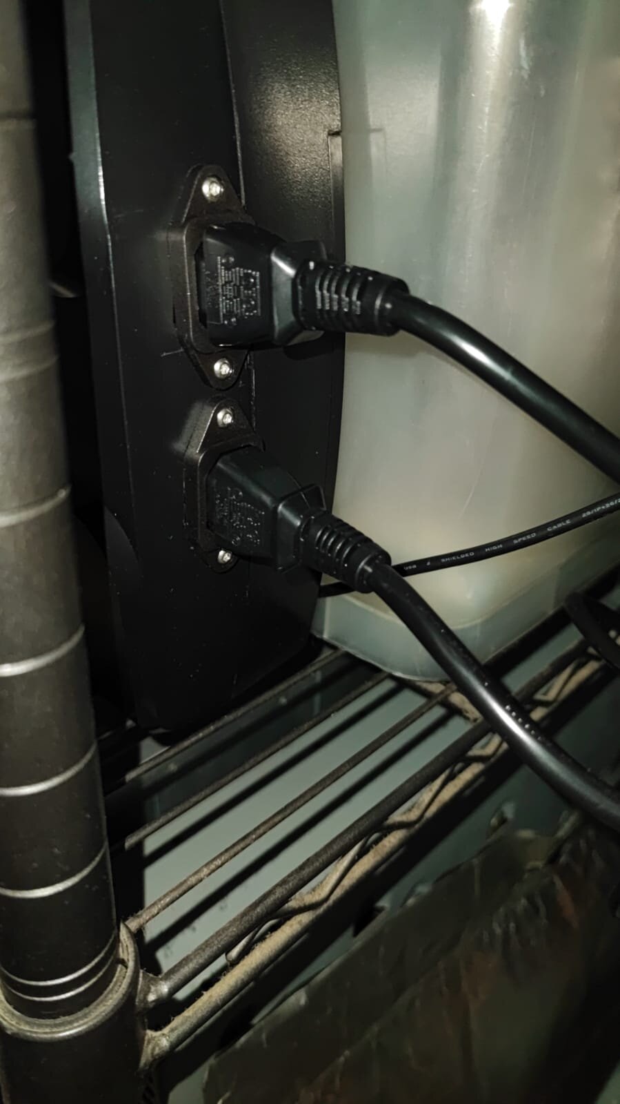

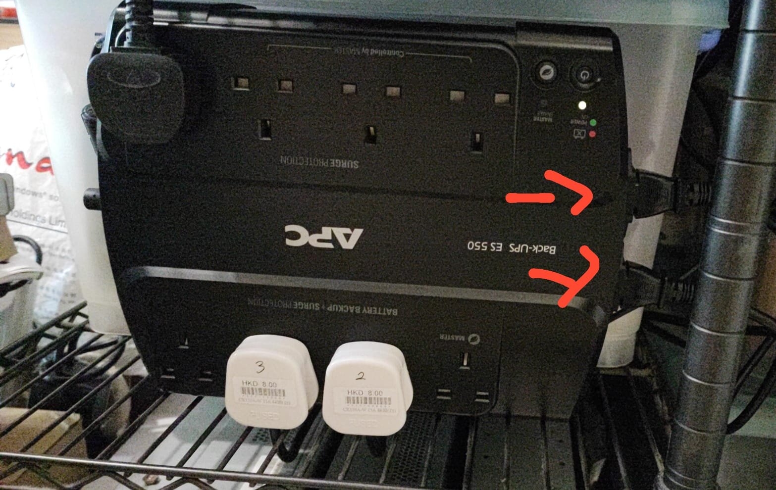

That's also why I have hardware modify a very old unused APC UPS ( entry level Back-UPS ) be a power source switcher , when power interruption occur, it will switch from mains to second power source and verse reverse ( it still work as UPS ) and notify NUT / APCUPSD. Or you can use it be a power interruption detector only. Lot of test and modifying, remove the battery, transformer and add two power input socket ......

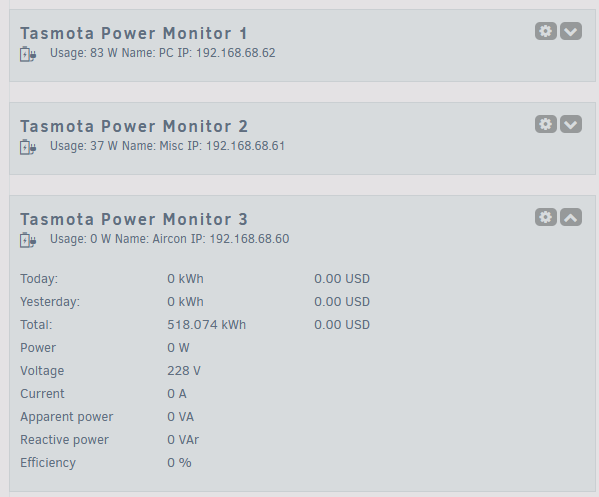

[PLUGIN] Tasmota Power Monitor
It work, thanks !! A minor issue, the placement will reset if page refresh, even already lock. ( Seems only happen once either window in top left, then it will change all at top horizontal )
