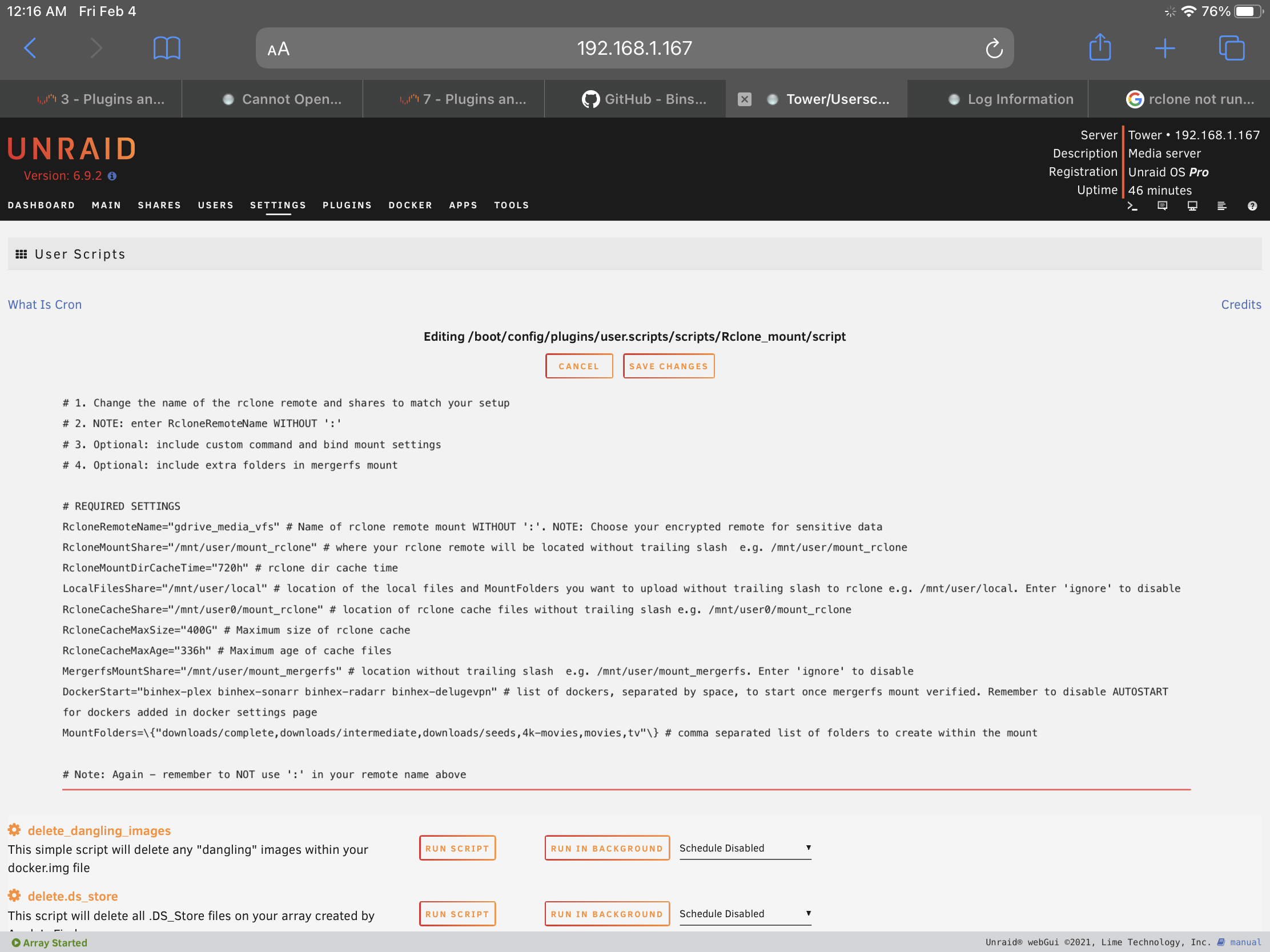

  5. Understand that - but the only setting I saw that could change that was for createBindMount which I have the following. CreateBindMount="Y" # Y/N. Choose whether to bind traffic to a particular network adapter RCloneMountIP="192.168.1.199" # My unraid IP is 172.30.12.2 so I create another similar IP address NetworkAdapter="eth0" # choose your network adapter. eth0 recommended VirtualIPNumber="2" # creates eth0:x e.g. eth0:1. I create a unique virtual IP addresses for each mount & upload so I can monitor and traffic shape for each of them for the second one I have 192.168.1.200 and IP 3. When I run it with a Y in the bind mount it does the following. 13.02.2022 10:58:16 INFO: *** Checking if IP address 192.168.1.199 already created for remote gdrive_media_vfs 13.02.2022 10:58:19 INFO: *** Creating IP address 192.168.1.199 for remote gdrive_media_vfs 13.02.2022 10:58:19 INFO: *** Created bind mount 192.168.1.199 for remote gdrive_media_vfs 13.02.2022 10:58:19 INFO: sleeping for 5 seconds 2022/02/13 10:58:19 Failed to start remote control: start server failed: listen tcp 127.0.0.1:5572: bind: address already in use I am not seeing anything that allows me to change the 127.0.0.1:5572 to anything else in the script. Appreciate the reply though.
  6. So I attempted this but I'm getting a --- 2022/02/13 00:48:17 Failed to start remote control: start server failed: listen tcp 127.0.0.1:5572: bind: address already in use --- error when I attempt the mount script. Any particular setting I should change from the original script to get this to work properly? Thanks in advance.

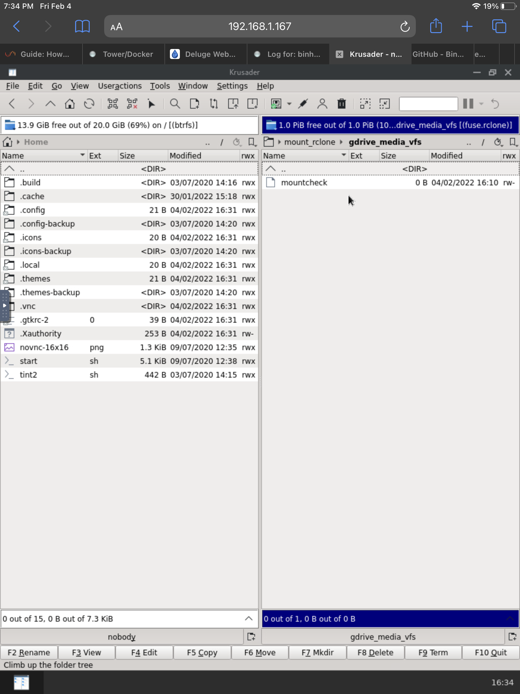

  8. Mountcheck does end up in the mount_rclone/gdrive_media_vfs/ folder and appears encrypted in google drive. It’s just one file if it matters.

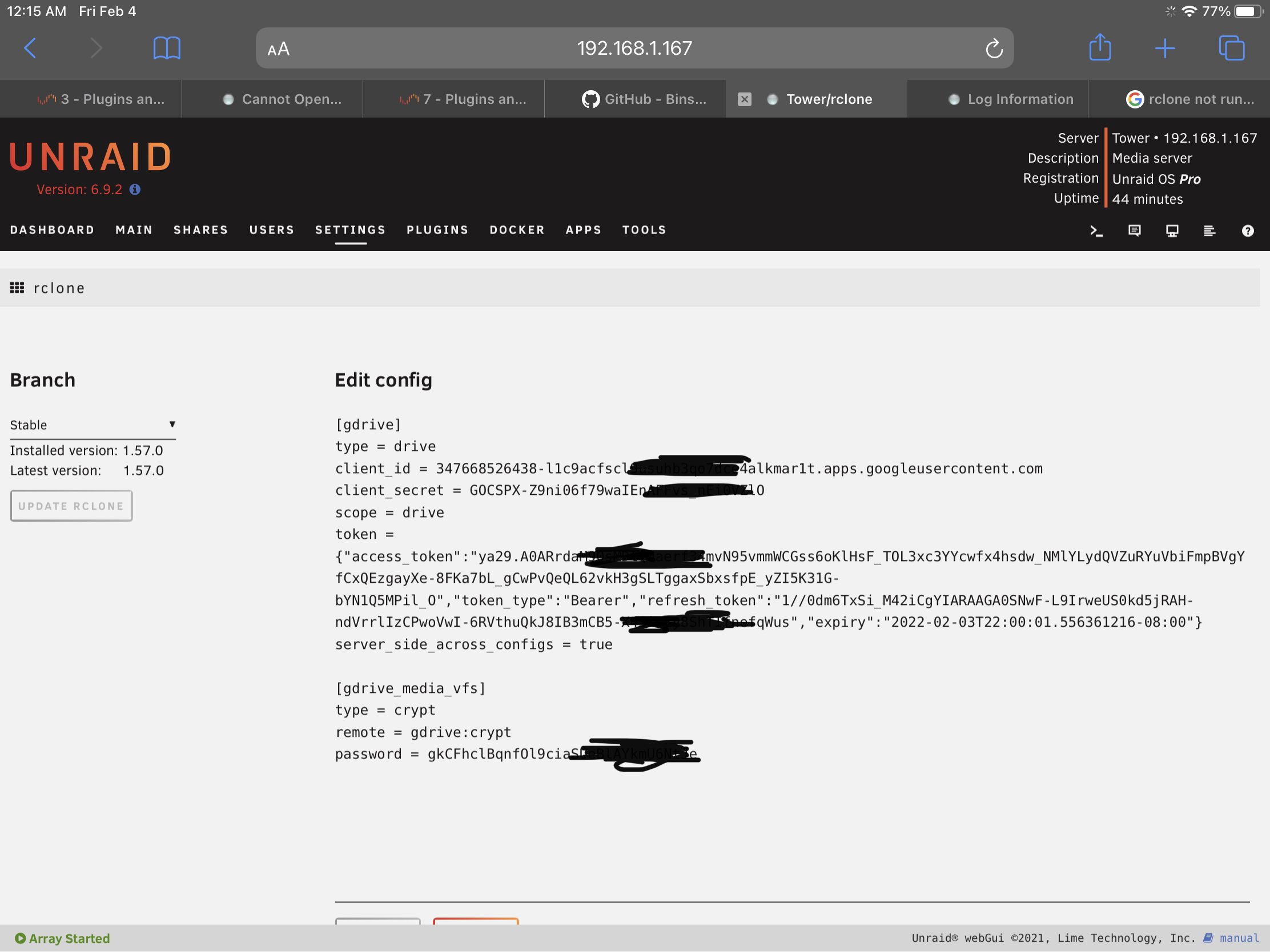

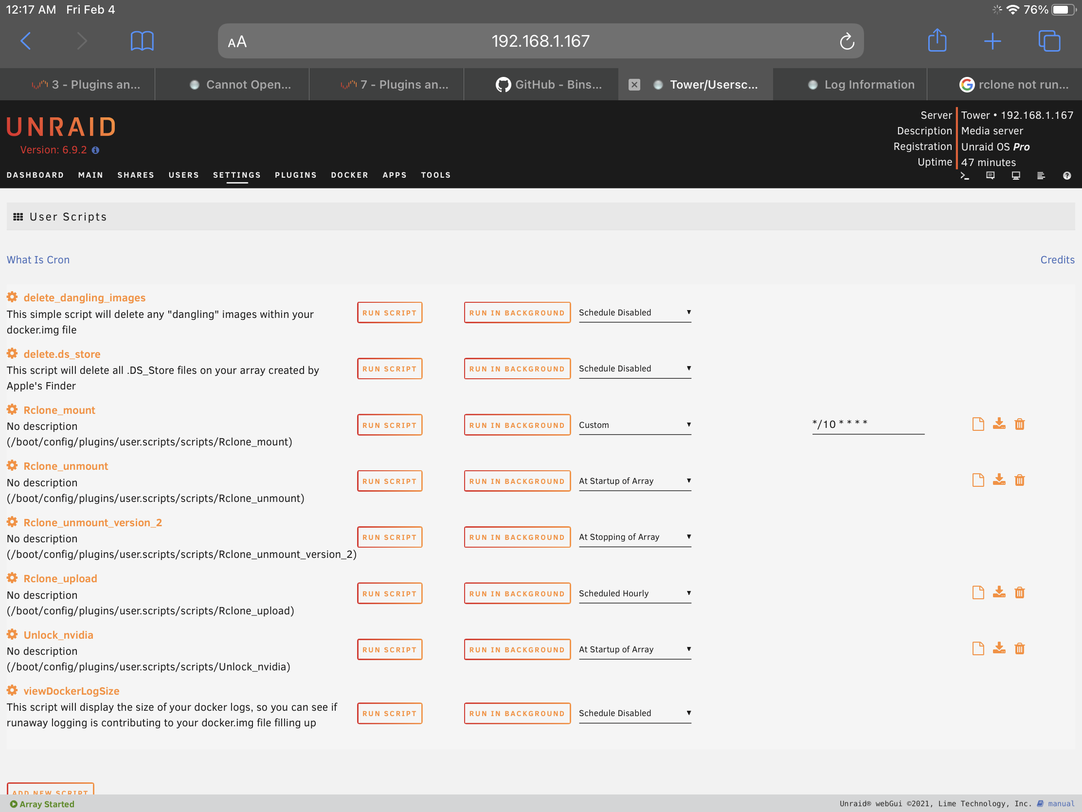

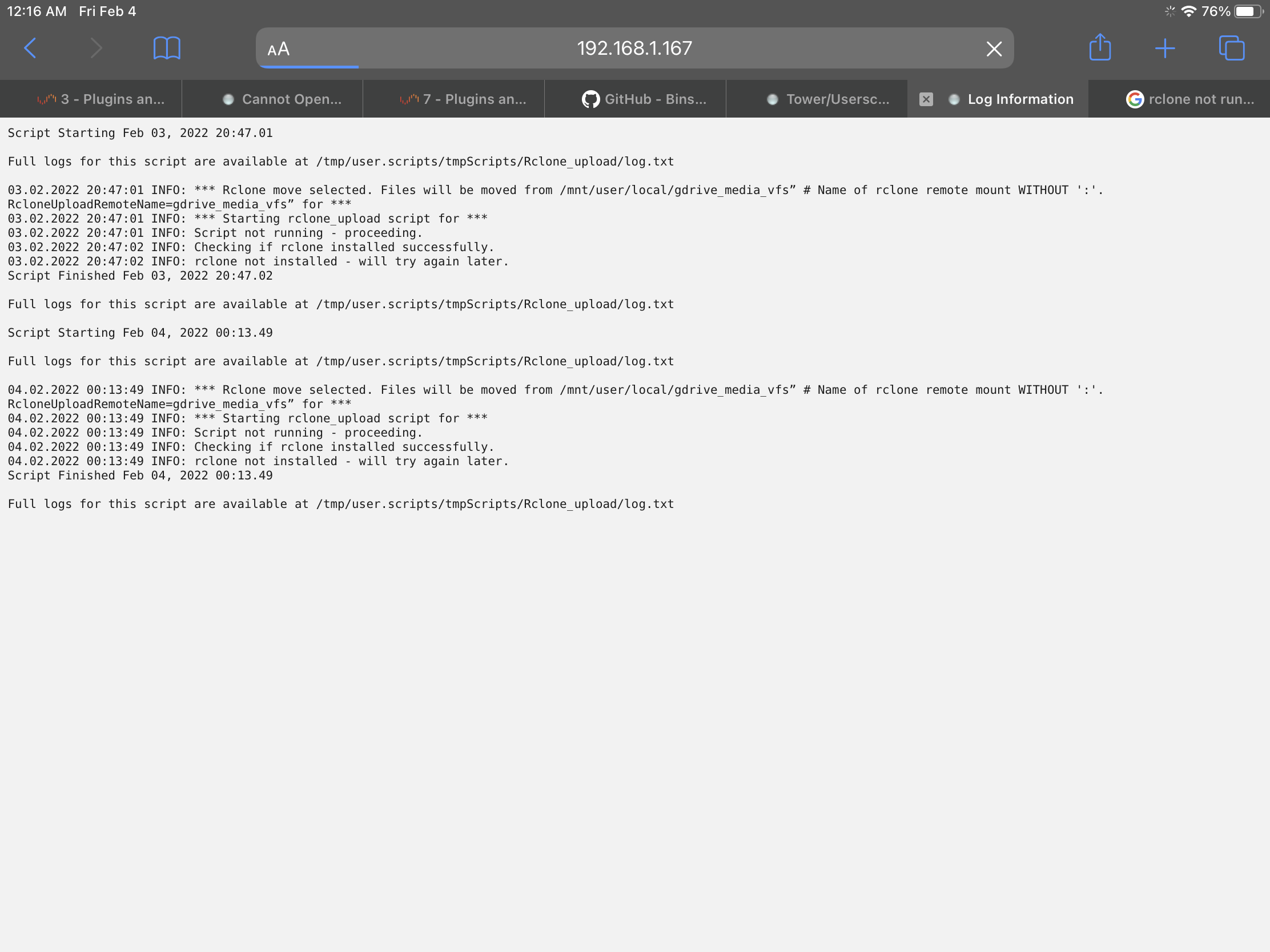

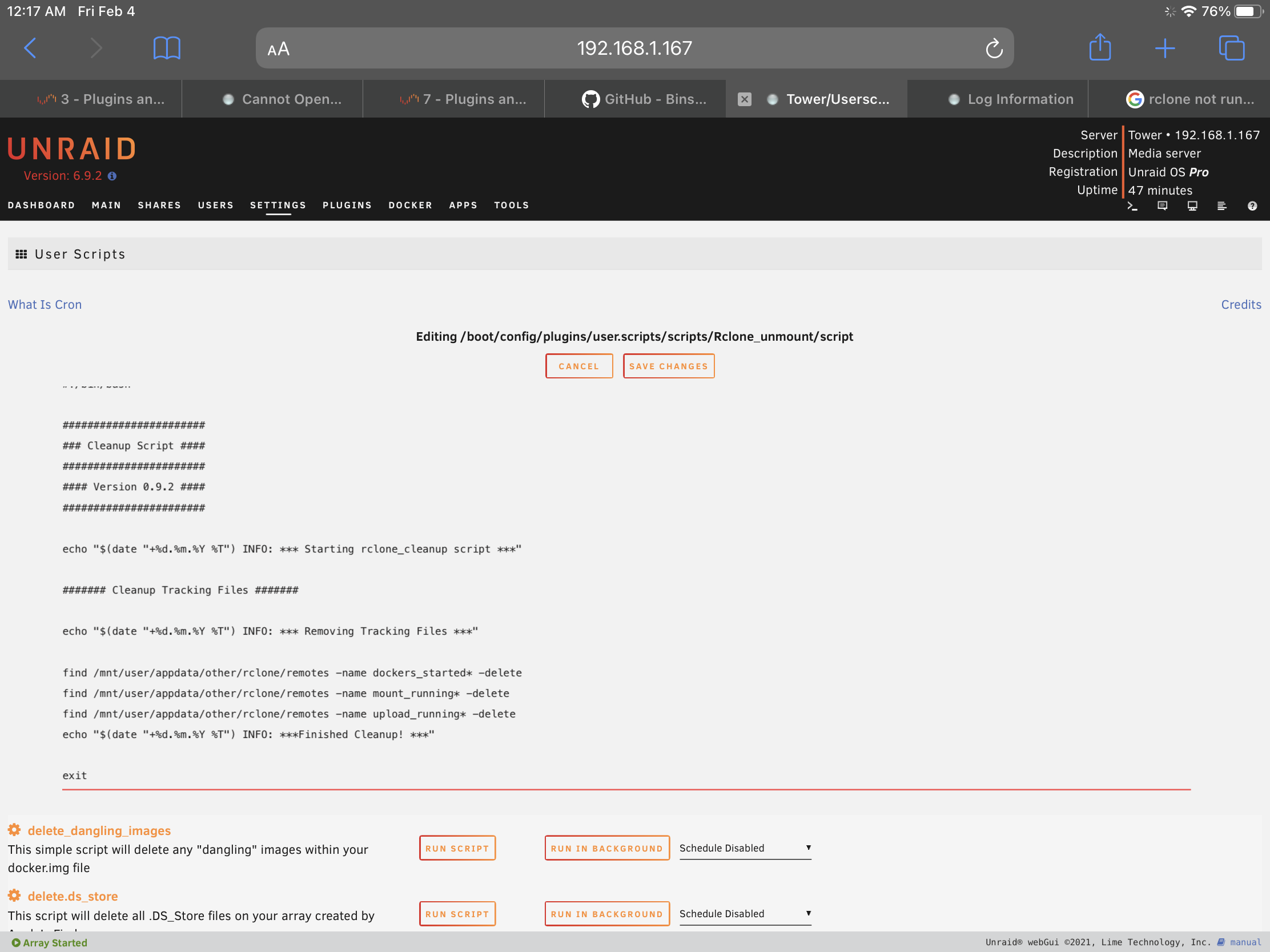

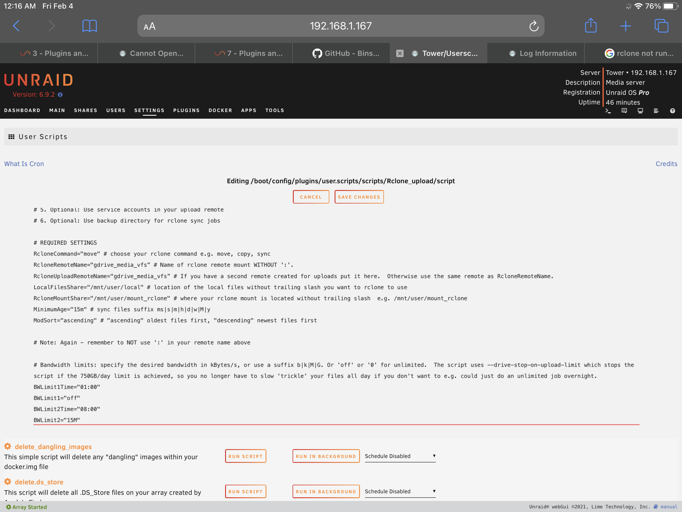

  9. Just tried reinstalling the rclone plugin as well. Did not work unfortunately. I deleted the crypt folder in google drive and it does reinstall it automatically when it does the mountcheck during the mount. Still saying rclone is not installed when I run the upload file. I’m really at a loss so any help would be appreciated. Pics are in my post two replies up roughly.

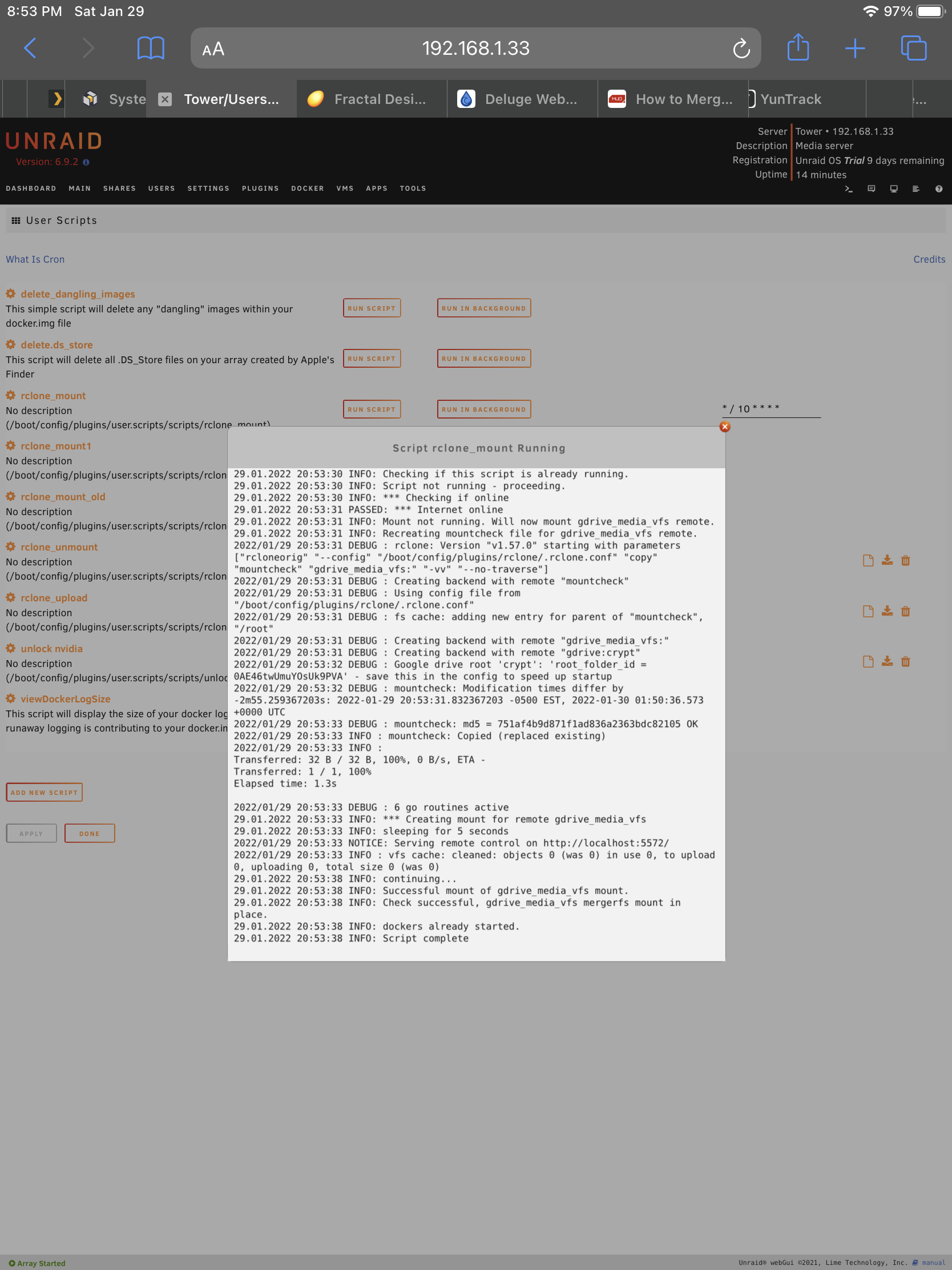

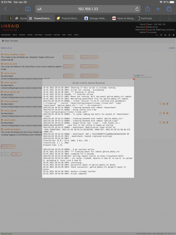

  11. Hey all, Appreciate the earlier feedback about the cache. That was definitely the culprit for taking up the space. I have run into a new problem however. I turned off my computer earlier and turned it back on after a few hours and it’s no longer connecting to rclone it appears. Everything was working flawlessly until now. I have attached a screenshot of what it looks like when I run the mount user script. I have removed rclone, redone the mount script from scratch, redone the client secret on the API site, and gone through the rclone confit from scratch again. I’m not too sure what else I can try short of redoing all of unraid. Thanks in advance. Edit --- added additional text from rclone_mount user script Script location: /tmp/user.scripts/tmpScripts/rclone_mount/script Note that closing this window will abort the execution of this script 30.01.2022 00:11:20 INFO: Creating local folders. 30.01.2022 00:11:20 INFO: Creating MergerFS folders. 30.01.2022 00:11:20 INFO: *** Starting mount of remote gdrive_media_vfs 30.01.2022 00:11:20 INFO: Checking if this script is already running. 30.01.2022 00:11:20 INFO: Script not running - proceeding. 30.01.2022 00:11:20 INFO: *** Checking if online 30.01.2022 00:11:21 PASSED: *** Internet online 30.01.2022 00:11:21 INFO: Mount not running. Will now mount gdrive_media_vfs remote. 30.01.2022 00:11:21 INFO: Recreating mountcheck file for gdrive_media_vfs remote. 2022/01/30 00:11:21 DEBUG : rclone: Version "v1.57.0" starting with parameters ["rcloneorig" "--config" "/boot/config/plugins/rclone/.rclone.conf" "copy" "mountcheck" "gdrive_media_vfs:" "-vv" "--no-traverse"] 2022/01/30 00:11:21 DEBUG : Creating backend with remote "mountcheck" 2022/01/30 00:11:21 DEBUG : Using config file from "/boot/config/plugins/rclone/.rclone.conf" 2022/01/30 00:11:21 DEBUG : fs cache: adding new entry for parent of "mountcheck", "/root" 2022/01/30 00:11:21 DEBUG : Creating backend with remote "gdrive_media_vfs:" 2022/01/30 00:11:21 DEBUG : Creating backend with remote "gdrive:crypt" 2022/01/30 00:11:21 DEBUG : Google drive root 'crypt': 'root_folder_id = 0AE46twUmuYOsUk9PVA' - save this in the config to speed up startup 2022/01/30 00:11:21 DEBUG : mountcheck: Modification times differ by -32m3.923444851s: 2022-01-30 00:11:21.150444851 -0500 EST, 2022-01-30 04:39:17.227 +0000 UTC 2022/01/30 00:11:22 DEBUG : mountcheck: md5 = 2b6512643b9492c83c85fbfdfa38fe41 OK 2022/01/30 00:11:22 INFO : mountcheck: Copied (replaced existing) 2022/01/30 00:11:22 INFO : Transferred: 32 B / 32 B, 100%, 0 B/s, ETA - Transferred: 1 / 1, 100% Elapsed time: 1.2s 2022/01/30 00:11:22 DEBUG : 6 go routines active 30.01.2022 00:11:22 INFO: *** Creating mount for remote gdrive_media_vfs 30.01.2022 00:11:22 INFO: sleeping for 5 seconds 2022/01/30 00:11:22 NOTICE: Serving remote control on http://localhost:5572/ 2022/01/30 00:11:23 INFO : vfs cache: cleaned: objects 0 (was 0) in use 0, to upload 0, uploading 0, total size 0 (was 0) 30.01.2022 00:11:27 INFO: continuing... 30.01.2022 00:11:27 INFO: Successful mount of gdrive_media_vfs mount. 30.01.2022 00:11:27 INFO: Mergerfs not installed - installing now. fetch http://dl-cdn.alpinelinux.org/alpine/v3.10/main/x86_64/APKINDEX.tar.gz fetch http://dl-cdn.alpinelinux.org/alpine/v3.10/community/x86_64/APKINDEX.tar.gz v3.10.9-43-g3feb769ea3 [http://dl-cdn.alpinelinux.org/alpine/v3.10/main] v3.10.6-10-ged79a86de3 [http://dl-cdn.alpinelinux.org/alpine/v3.10/community] OK: 10351 distinct packages available (1/6) Installing ca-certificates (20191127-r2) (2/6) Installing nghttp2-libs (1.39.2-r1) (3/6) Installing libcurl (7.66.0-r4) (4/6) Installing expat (2.2.8-r0) (5/6) Installing pcre2 (10.33-r0) (6/6) Installing git (2.22.5-r0) Executing busybox-1.30.1-r2.trigger Executing ca-certificates-20191127-r2.trigger OK: 21 MiB in 20 packages Cloning into 'mergerfs'... 2.33.3 Note: checking out '2.33.3'. You are in 'detached HEAD' state. You can look around, make experimental changes and commit them, and you can discard any commits you make in this state without impacting any branches by performing another checkout. If you want to create a new branch to retain commits you create, you may do so (now or later) by using -b with the checkout command again. Example: git checkout -b HEAD is now at f159fe6 Merge pull request #997 from trapexit/link-getattr (1/50) Upgrading musl (1.1.22-r3 -> 1.1.22-r4) (2/50) Installing fakeroot (1.23-r0) (3/50) Installing sudo (1.9.5p2-r0) (4/50) Installing libcap (2.27-r0) (5/50) Installing pax-utils (1.2.3-r0) (6/50) Installing openssl (1.1.1k-r0) (7/50) Installing libattr (2.4.48-r0) (8/50) Installing attr (2.4.48-r0) (9/50) Installing tar (1.32-r1) (10/50) Installing pkgconf (1.6.1-r1) (11/50) Installing patch (2.7.6-r6) (12/50) Installing libgcc (8.3.0-r0) (13/50) Installing libstdc++ (8.3.0-r0) (14/50) Installing lzip (1.21-r0) (15/50) Installing curl (7.66.0-r4) (16/50) Installing abuild (3.4.0-r0) Executing abuild-3.4.0-r0.pre-install (17/50) Installing m4 (1.4.18-r1) (18/50) Installing libbz2 (1.0.6-r7) (19/50) Installing perl (5.28.3-r0) (20/50) Installing autoconf (2.69-r2) (21/50) Installing automake (1.16.1-r0) (22/50) Installing binutils (2.32-r1) (23/50) Installing gmp (6.1.2-r1) (24/50) Installing isl (0.18-r0) (25/50) Installing libgomp (8.3.0-r0) (26/50) Installing libatomic (8.3.0-r0) (27/50) Installing mpfr3 (3.1.5-r1) (28/50) Installing mpc1 (1.1.0-r0) (29/50) Installing gcc (8.3.0-r0) (30/50) Installing musl-dev (1.1.22-r4) (31/50) Installing libc-dev (0.7.1-r0) (32/50) Installing g++ (8.3.0-r0) (33/50) Installing gettext-asprintf (0.19.8.1-r4) (34/50) Installing libintl (0.19.8.1-r4) (35/50) Installing libunistring (0.9.10-r0) (36/50) Installing gettext-libs (0.19.8.1-r4) (37/50) Installing ncurses-terminfo-base (6.1_p20190518-r2) (38/50) Installing ncurses-libs (6.1_p20190518-r2) (39/50) Installing libxml2 (2.9.9-r5) (40/50) Installing gettext (0.19.8.1-r4) (41/50) Installing gettext-dev (0.19.8.1-r4) (42/50) Installing perl-error (0.17027-r0) (43/50) Installing perl-git (2.22.5-r0) (44/50) Installing git-perl (2.22.5-r0) (45/50) Installing readline (8.0.0-r0) (46/50) Installing bash (5.0.0-r0) Executing bash-5.0.0-r0.post-install (47/50) Installing libltdl (2.4.6-r6) (48/50) Installing libtool (2.4.6-r6) (49/50) Installing linux-headers (4.19.36-r0) (50/50) Installing make (4.2.1-r2) Executing busybox-1.30.1-r2.trigger OK: 238 MiB in 69 packages make DEBUG= -C libfuse make[1]: Entering directory '/tmp/mergerfs/libfuse' mkdir -p build touch build/stamp ecfd/build | tee build/config.h #ifndef CONFIG_H_INCLUDED #define CONFIG_H_INCLUDED #define HAVE_FORK /tmp/mergerfs/libfuse/ecfd/tests/HAVE_MALLOC_TRIM.c: In function 'main': /tmp/mergerfs/libfuse/ecfd/tests/HAVE_MALLOC_TRIM.c:6:3: warning: implicit declaration of function 'malloc_trim'; did you mean 'malloc'? [-Wimplicit-function-declaration] malloc_trim(0); ^~~~~~~~~~~ malloc /usr/lib/gcc/x86_64-alpine-linux-musl/8.3.0/../../../../x86_64-alpine-linux-musl/bin/ld: /tmp/ccldgBcc.o: in function `main': HAVE_MALLOC_TRIM.c:(.text+0xf): undefined reference to `malloc_trim' collect2: error: ld returned 1 exit status #define HAVE_SPLICE #define HAVE_STRUCT_STAT_ST_ATIM #define HAVE_UTIMENSAT #define HAVE_VMSPLICE #endif make build/buffer.o build/crc32b.o build/debug.o build/fuse.o build/fuse_dirents.o build/fuse_kern_chan.o build/fuse_loop_mt.o build/fuse_lowlevel.o build/fuse_mt.o build/fuse_node.o build/fuse_opt.o build/fuse_session.o build/fuse_signals.o build/helper.o build/mount.o make[2]: Entering directory '/tmp/mergerfs/libfuse' cc -O2 -std=gnu99 -Wall -pipe -MMD -Iinclude -Ibuild -D_REENTRANT -D_FILE_OFFSET_BITS=64 -DFUSE_USE_VERSION=29 -DPACKAGE_VERSION=\"2.9.7-mergerfs_2.30.0\" -DFUSERMOUNT_DIR=\"/usr/local/bin\" -c lib/buffer.c -o build/buffer.o cc -O2 -std=gnu99 -Wall -pipe -MMD -Iinclude -Ibuild -D_REENTRANT -D_FILE_OFFSET_BITS=64 -DFUSE_USE_VERSION=29 -DPACKAGE_VERSION=\"2.9.7-mergerfs_2.30.0\" -DFUSERMOUNT_DIR=\"/usr/local/bin\" -c lib/crc32b.c -o build/crc32b.o cc -O2 -std=gnu99 -Wall -pipe -MMD -Iinclude -Ibuild -D_REENTRANT -D_FILE_OFFSET_BITS=64 -DFUSE_USE_VERSION=29 -DPACKAGE_VERSION=\"2.9.7-mergerfs_2.30.0\" -DFUSERMOUNT_DIR=\"/usr/local/bin\" -c lib/debug.c -o build/debug.o cc -O2 -std=gnu99 -Wall -pipe -MMD -Iinclude -Ibuild -D_REENTRANT -D_FILE_OFFSET_BITS=64 -DFUSE_USE_VERSION=29 -DPACKAGE_VERSION=\"2.9.7-mergerfs_2.30.0\" -DFUSERMOUNT_DIR=\"/usr/local/bin\" -c lib/fuse.c -o build/fuse.o lib/fuse.c: In function 'add_name': lib/fuse.c:837:3: warning: 'strncpy' output truncated before terminating nul copying as many bytes from a string as its length [-Wstringop-truncation] strncpy(s,name,len); ^~~~~~~~~~~~~~~~~~~ lib/fuse.c:811:16: note: length computed here size_t len = strlen(name); ^~~~~~~~~~~~ cc -O2 -std=gnu99 -Wall -pipe -MMD -Iinclude -Ibuild -D_REENTRANT -D_FILE_OFFSET_BITS=64 -DFUSE_USE_VERSION=29 -DPACKAGE_VERSION=\"2.9.7-mergerfs_2.30.0\" -DFUSERMOUNT_DIR=\"/usr/local/bin\" -c lib/fuse_dirents.c -o build/fuse_dirents.o cc -O2 -std=gnu99 -Wall -pipe -MMD -Iinclude -Ibuild -D_REENTRANT -D_FILE_OFFSET_BITS=64 -DFUSE_USE_VERSION=29 -DPACKAGE_VERSION=\"2.9.7-mergerfs_2.30.0\" -DFUSERMOUNT_DIR=\"/usr/local/bin\" -c lib/fuse_kern_chan.c -o build/fuse_kern_chan.o cc -O2 -std=gnu99 -Wall -pipe -MMD -Iinclude -Ibuild -D_REENTRANT -D_FILE_OFFSET_BITS=64 -DFUSE_USE_VERSION=29 -DPACKAGE_VERSION=\"2.9.7-mergerfs_2.30.0\" -DFUSERMOUNT_DIR=\"/usr/local/bin\" -c lib/fuse_loop_mt.c -o build/fuse_loop_mt.o cc -O2 -std=gnu99 -Wall -pipe -MMD -Iinclude -Ibuild -D_REENTRANT -D_FILE_OFFSET_BITS=64 -DFUSE_USE_VERSION=29 -DPACKAGE_VERSION=\"2.9.7-mergerfs_2.30.0\" -DFUSERMOUNT_DIR=\"/usr/local/bin\" -c lib/fuse_lowlevel.c -o build/fuse_lowlevel.o cc -O2 -std=gnu99 -Wall -pipe -MMD -Iinclude -Ibuild -D_REENTRANT -D_FILE_OFFSET_BITS=64 -DFUSE_USE_VERSION=29 -DPACKAGE_VERSION=\"2.9.7-mergerfs_2.30.0\" -DFUSERMOUNT_DIR=\"/usr/local/bin\" -c lib/fuse_mt.c -o build/fuse_mt.o cc -O2 -std=gnu99 -Wall -pipe -MMD -Iinclude -Ibuild -D_REENTRANT -D_FILE_OFFSET_BITS=64 -DFUSE_USE_VERSION=29 -DPACKAGE_VERSION=\"2.9.7-mergerfs_2.30.0\" -DFUSERMOUNT_DIR=\"/usr/local/bin\" -c lib/fuse_node.c -o build/fuse_node.o cc -O2 -std=gnu99 -Wall -pipe -MMD -Iinclude -Ibuild -D_REENTRANT -D_FILE_OFFSET_BITS=64 -DFUSE_USE_VERSION=29 -DPACKAGE_VERSION=\"2.9.7-mergerfs_2.30.0\" -DFUSERMOUNT_DIR=\"/usr/local/bin\" -c lib/fuse_opt.c -o build/fuse_opt.o cc -O2 -std=gnu99 -Wall -pipe -MMD -Iinclude -Ibuild -D_REENTRANT -D_FILE_OFFSET_BITS=64 -DFUSE_USE_VERSION=29 -DPACKAGE_VERSION=\"2.9.7-mergerfs_2.30.0\" -DFUSERMOUNT_DIR=\"/usr/local/bin\" -c lib/fuse_session.c -o build/fuse_session.o cc -O2 -std=gnu99 -Wall -pipe -MMD -Iinclude -Ibuild -D_REENTRANT -D_FILE_OFFSET_BITS=64 -DFUSE_USE_VERSION=29 -DPACKAGE_VERSION=\"2.9.7-mergerfs_2.30.0\" -DFUSERMOUNT_DIR=\"/usr/local/bin\" -c lib/fuse_signals.c -o build/fuse_signals.o cc -O2 -std=gnu99 -Wall -pipe -MMD -Iinclude -Ibuild -D_REENTRANT -D_FILE_OFFSET_BITS=64 -DFUSE_USE_VERSION=29 -DPACKAGE_VERSION=\"2.9.7-mergerfs_2.30.0\" -DFUSERMOUNT_DIR=\"/usr/local/bin\" -c lib/helper.c -o build/helper.o cc -O2 -std=gnu99 -Wall -pipe -MMD -Iinclude -Ibuild -D_REENTRANT -D_FILE_OFFSET_BITS=64 -DFUSE_USE_VERSION=29 -DPACKAGE_VERSION=\"2.9.7-mergerfs_2.30.0\" -DFUSERMOUNT_DIR=\"/usr/local/bin\" -c lib/mount.c -o build/mount.o In file included from lib/mount_generic.c:22, from lib/mount.c:22: /usr/include/sys/poll.h:1:2: warning: #warning redirecting incorrect #include to [-Wcpp] #warning redirecting incorrect #include to ^~~~~~~ make[2]: Leaving directory '/tmp/mergerfs/libfuse' ar rcs build/libfuse.a build/buffer.o build/crc32b.o build/debug.o build/fuse.o build/fuse_dirents.o build/fuse_kern_chan.o build/fuse_loop_mt.o build/fuse_lowlevel.o build/fuse_mt.o build/fuse_node.o build/fuse_opt.o build/fuse_session.o build/fuse_signals.o build/helper.o build/mount.o cc -O2 -std=gnu99 -Wall -pipe -MMD -Iinclude -Ibuild -D_REENTRANT -D_FILE_OFFSET_BITS=64 -DFUSE_USE_VERSION=29 -DPACKAGE_VERSION=\"2.9.7-mergerfs_2.30.0\" -DFUSERMOUNT_DIR=\"/usr/local/bin\" -Ilib -o build/mergerfs-fusermount util/fusermount.c lib/mount_util.c cc -O2 -std=gnu99 -Wall -pipe -MMD -Iinclude -Ibuild -D_REENTRANT -D_FILE_OFFSET_BITS=64 -DFUSE_USE_VERSION=29 -DPACKAGE_VERSION=\"2.9.7-mergerfs_2.30.0\" -DFUSERMOUNT_DIR=\"/usr/local/bin\" -o build/mount.mergerfs util/mount.mergerfs.c build/libfuse.a -lrt -pthread make[1]: Leaving directory '/tmp/mergerfs/libfuse' tools/update-version grep: src/version.hpp: No such file or directory mkdir -p build/.src build/.tests touch build/stamp make build/.src/config_statfs.o build/.src/fuse_readlink.o build/.src/fs_copydata_readwrite.o build/.src/mempools.o build/.src/fuse_bmap.o build/.src/fuse_getattr.o build/.src/fuse_getxattr.o build/.src/fuse_readdir_plus_linux.o build/.src/fuse_truncate.o build/.src/category.o build/.src/fs_cow.o build/.src/policy_erofs.o build/.src/option_parser.o build/.src/fuse_mknod.o build/.src/fuse_ftruncate.o build/.src/fuse_rename.o build/.src/fs_copydata.o build/.src/fs_sendfile.o build/.src/fuse_flock.o build/.src/policy_all.o build/.src/fs_attr.o build/.src/fs_copy_file_range.o build/.src/fuse_releasedir.o build/.src/fuse_release.o build/.src/fuse_prepare_hide.o build/.src/policy_msplus.o build/.src/fs_realpathize.o build/.src/mergerfs.o build/.src/policy_pfrd.o build/.src/num.o build/.src/policy_epall.o build/.src/policy_lus.o build/.src/fuse_write_buf.o build/.src/config_readdir.o build/.src/fs_path.o build/.src/fuse_setxattr.o build/.src/fs_xattr.o build/.src/fs_clonefile.o build/.src/fs_setfl.o build/.src/fusemake[1]: Entering directory '/tmp/mergerfs' g++ -O2 -std=c++11 -static -Wall -Wno-unused-result -MMD -Ilibfuse/include -D_FILE_OFFSET_BITS=64 -DFUSE_USE_VERSION=29 -DUSE_XATTR=1 -DUGID_USE_RWLOCK=0 -c src/config_statfs.cpp -o build/.src/config_statfs.o g++ -O2 -std=c++11 -static -Wall -Wno-unused-result -MMD -Ilibfuse/include -D_FILE_OFFSET_BITS=64 -DFUSE_USE_VERSION=29 -DUSE_XATTR=1 -DUGID_USE_RWLOCK=0 -c src/fuse_readlink.cpp -o build/.src/fuse_readlink.o In file included from src/fuse_readlink.cpp:23: src/ugid.hpp:31:2: warning: #warning "using ugid_linux.hpp" [-Wcpp] #warning "using ugid_linux.hpp" ^~~~~~~ g++ -O2 -std=c++11 -static -Wall -Wno-unused-result -MMD -Ilibfuse/include -D_FILE_OFFSET_BITS=64 -DFUSE_USE_VERSION=29 -DUSE_XATTR=1 -DUGID_USE_RWLOCK=0 -c src/fs_copydata_readwrite.cpp -o build/.src/fs_copydata_readwrite.o g++ -O2 -std=c++11 -static -Wall -Wno-unused-result -MMD -Ilibfuse/include -D_FILE_OFFSET_BITS=64 -DFUSE_USE_VERSION=29 -DUSE_XATTR=1 -DUGID_USE_RWLOCK=0 -c src/mempools.cpp -o build/.src/mempools.o g++ -O2 -std=c++11 -static -Wall -Wno-unused-result -MMD -Ilibfuse/include -D_FILE_OFFSET_BITS=64 -DFUSE_USE_VERSION=29 -DUSE_XATTR=1 -DUGID_USE_RWLOCK=0 -c src/fuse_bmap.cpp -o build/.src/fuse_bmap.o g++ -O2 -std=c++11 -static -Wall -Wno-unused-result -MMD -Ilibfuse/include -D_FILE_OFFSET_BITS=64 -DFUSE_USE_VERSION=29 -DUSE_XATTR=1 -DUGID_USE_RWLOCK=0 -c src/fuse_getattr.cpp -o build/.src/fuse_getattr.o In file included from src/fuse_getattr.cpp:24: src/ugid.hpp:31:2: warning: #warning "using ugid_linux.hpp" [-Wcpp] #warning "using ugid_linux.hpp" ^~~~~~~ g++ -O2 -std=c++11 -static -Wall -Wno-unused-result -MMD -Ilibfuse/include -D_FILE_OFFSET_BITS=64 -DFUSE_USE_VERSION=29 -DUSE_XATTR=1 -DUGID_USE_RWLOCK=0 -c src/fuse_getxattr.cpp -o build/.src/fuse_getxattr.o In file included from src/fuse_getxattr.cpp:24: src/ugid.hpp:31:2: warning: #warning "using ugid_linux.hpp" [-Wcpp] #warning "using ugid_linux.hpp" ^~~~~~~ g++ -O2 -std=c++11 -static -Wall -Wno-unused-result -MMD -Ilibfuse/include -D_FILE_OFFSET_BITS=64 -DFUSE_USE_VERSION=29 -DUSE_XATTR=1 -DUGID_USE_RWLOCK=0 -c src/fuse_readdir_plus_linux.cpp -o build/.src/fuse_readdir_plus_linux.o g++ -O2 -std=c++11 -static -Wall -Wno-unused-result -MMD -Ilibfuse/include -D_FILE_OFFSET_BITS=64 -DFUSE_USE_VERSION=29 -DUSE_XATTR=1 -DUGID_USE_RWLOCK=0 -c src/fuse_truncate.cpp -o build/.src/fuse_truncate.o In file included from src/fuse_truncate.cpp:22: src/ugid.hpp:31:2: warning: #warning "using ugid_linux.hpp" [-Wcpp] #warning "using ugid_linux.hpp" ^~~~~~~ g++ -O2 -std=c++11 -static -Wall -Wno-unused-result -MMD -Ilibfuse/include -D_FILE_OFFSET_BITS=64 -DFUSE_USE_VERSION=29 -DUSE_XATTR=1 -DUGID_USE_RWLOCK=0 -c src/category.cpp -o build/.src/category.o g++ -O2 -std=c++11 -static -Wall -Wno-unused-result -MMD -Ilibfuse/include -D_FILE_OFFSET_BITS=64 -DFUSE_USE_VERSION=29 -DUSE_XATTR=1 -DUGID_USE_RWLOCK=0 -c src/fs_cow.cpp -o build/.src/fs_cow.o g++ -O2 -std=c++11 -static -Wall -Wno-unused-result -MMD -Ilibfuse/include -D_FILE_OFFSET_BITS=64 -DFUSE_USE_VERSION=29 -DUSE_XATTR=1 -DUGID_USE_RWLOCK=0 -c src/policy_erofs.cpp -o build/.src/policy_erofs.o g++ -O2 -std=c++11 -static -Wall -Wno-unused-result -MMD -Ilibfuse/include -D_FILE_OFFSET_BITS=64 -DFUSE_USE_VERSION=29 -DUSE_XATTR=1 -DUGID_USE_RWLOCK=0 -c src/option_parser.cpp -o build/.src/option_parser.o g++ -O2 -std=c++11 -static -Wall -Wno-unused-result -MMD -Ilibfuse/include -D_FILE_OFFSET_BITS=64 -DFUSE_USE_VERSION=29 -DUSE_XATTR=1 -DUGID_USE_RWLOCK=0 -c src/fuse_mknod.cpp -o build/.src/fuse_mknod.o In file included from src/fuse_mknod.cpp:23: src/ugid.hpp:31:2: warning: #warning "using ugid_linux.hpp" [-Wcpp] #warning "using ugid_linux.hpp" ^~~~~~~ g++ -O2 -std=c++11 -static -Wall -Wno-unused-result -MMD -Ilibfuse/include -D_FILE_OFFSET_BITS=64 -DFUSE_USE_VERSION=29 -DUSE_XATTR=1 -DUGID_USE_RWLOCK=0 -c src/fuse_ftruncate.cpp -o build/.src/fuse_ftruncate.o g++ -O2 -std=c++11 -static -Wall -Wno-unused-result -MMD -Ilibfuse/include -D_FILE_OFFSET_BITS=64 -DFUSE_USE_VERSION=29 -DUSE_XATTR=1 -DUGID_USE_RWLOCK=0 -c src/fuse_rename.cpp -o build/.src/fuse_rename.o In file included from src/fs_mkdir_as_root.hpp:20, from src/fuse_rename.cpp:21: src/ugid.hpp:31:2: warning: #warning "using ugid_linux.hpp" [-Wcpp] #warning "using ugid_linux.hpp" ^~~~~~~ src/fuse_rename.cpp:95:3: warning: 'void l::remove(const CPtr&, const string&)' defined but not used [-Wunused-function] remove(const Branches::CPtr &branches_, ^~~~~~ g++ -O2 -std=c++11 -static -Wall -Wno-unused-result -MMD -Ilibfuse/include -D_FILE_OFFSET_BITS=64 -DFUSE_USE_VERSION=29 -DUSE_XATTR=1 -DUGID_USE_RWLOCK=0 -c src/fs_copydata.cpp -o build/.src/fs_copydata.o g++ -O2 -std=c++11 -static -Wall -Wno-unused-result -MMD -Ilibfuse/include -D_FILE_OFFSET_BITS=64 -DFUSE_USE_VERSION=29 -DUSE_XATTR=1 -DUGID_USE_RWLOCK=0 -c src/fs_sendfile.cpp -o build/.src/fs_sendfile.o src/fs_sendfile.cpp:18:2: warning: #warning "using fs_sendfile_linux.icpp" [-Wcpp] #warning "using fs_sendfile_linux.icpp" ^~~~~~~ g++ -O2 -std=c++11 -static -Wall -Wno-unused-result -MMD -Ilibfuse/include -D_FILE_OFFSET_BITS=64 -DFUSE_USE_VERSION=29 -DUSE_XATTR=1 -DUGID_USE_RWLOCK=0 -c src/fuse_flock.cpp -o build/.src/fuse_flock.o g++ -O2 -std=c++11 -static -Wall -Wno-unused-result -MMD -Ilibfuse/include -D_FILE_OFFSET_BITS=64 -DFUSE_USE_VERSION=29 -DUSE_XATTR=1 -DUGID_USE_RWLOCK=0 -c src/policy_all.cpp -o build/.src/policy_all.o g++ -O2 -std=c++11 -static -Wall -Wno-unused-result -MMD -Ilibfuse/include -D_FILE_OFFSET_BITS=64 -DFUSE_USE_VERSION=29 -DUSE_XATTR=1 -DUGID_USE_RWLOCK=0 -c src/fs_attr.cpp -o build/.src/fs_attr.o src/fs_attr.cpp:18:2: warning: #warning "using fs_attr_linux.icpp" [-Wcpp] #warning "using fs_attr_linux.icpp" ^~~~~~~ g++ -O2 -std=c++11 -static -Wall -Wno-unused-result -MMD -Ilibfuse/include -D_FILE_OFFSET_BITS=64 -DFUSE_USE_VERSION=29 -DUSE_XATTR=1 -DUGID_USE_RWLOCK=0 -c src/fs_copy_file_range.cpp -o build/.src/fs_copy_file_range.o src/fs_copy_file_range.cpp:20:2: warning: #warning "using fs_copy_file_range_linux.icpp" [-Wcpp] #warning "using fs_copy_file_range_linux.icpp" ^~~~~~~ g++ -O2 -std=c++11 -static -Wall -Wno-unused-result -MMD -Ilibfuse/include -D_FILE_OFFSET_BITS=64 -DFUSE_USE_VERSION=29 -DUSE_XATTR=1 -DUGID_USE_RWLOCK=0 -c src/fuse_releasedir.cpp -o build/.src/fuse_releasedir.o g++ -O2 -std=c++11 -static -Wall -Wno-unused-result -MMD -Ilibfuse/include -D_FILE_OFFSET_BITS=64 -DFUSE_USE_VERSION=29 -DUSE_XATTR=1 -DUGID_USE_RWLOCK=0 -c src/fuse_release.cpp -o build/.src/fuse_release.o g++ -O2 -std=c++11 -static -Wall -Wno-unused-result -MMD -Ilibfuse/include -D_FILE_OFFSET_BITS=64 -DFUSE_USE_VERSION=29 -DUSE_XATTR=1 -DUGID_USE_RWLOCK=0 -c src/fuse_prepare_hide.cpp -o build/.src/fuse_prepare_hide.o g++ -O2 -std=c++11 -static -Wall -Wno-unused-result -MMD -Ilibfuse/include -D_FILE_OFFSET_BITS=64 -DFUSE_USE_VERSION=29 -DUSE_XATTR=1 -DUGID_USE_RWLOCK=0 -c src/policy_msplus.cpp -o build/.src/policy_msplus.o g++ -O2 -std=c++11 -static -Wall -Wno-unused-result -MMD -Ilibfuse/include -D_FILE_OFFSET_BITS=64 -DFUSE_USE_VERSION=29 -DUSE_XATTR=1 -DUGID_USE_RWLOCK=0 -c src/fs_realpathize.cpp -o build/.src/fs_realpathize.o g++ -O2 -std=c++11 -static -Wall -Wno-unused-result -MMD -Ilibfuse/include -D_FILE_OFFSET_BITS=64 -DFUSE_USE_VERSION=29 -DUSE_XATTR=1 -DUGID_USE_RWLOCK=0 -c src/mergerfs.cpp -o build/.src/mergerfs.o g++ -O2 -std=c++11 -static -Wall -Wno-unused-result -MMD -Ilibfuse/include -D_FILE_OFFSET_BITS=64 -DFUSE_USE_VERSION=29 -DUSE_XATTR=1 -DUGID_USE_RWLOCK=0 -c src/policy_pfrd.cpp -o build/.src/policy_pfrd.o g++ -O2 -std=c++11 -static -Wall -Wno-unused-result -MMD -Ilibfuse/include -D_FILE_OFFSET_BITS=64 -DFUSE_USE_VERSION=29 -DUSE_XATTR=1 -DUGID_USE_RWLOCK=0 -c src/num.cpp -o build/.src/num.o g++ -O2 -std=c++11 -static -Wall -Wno-unused-result -MMD -Ilibfuse/include -D_FILE_OFFSET_BITS=64 -DFUSE_USE_VERSION=29 -DUSE_XATTR=1 -DUGID_USE_RWLOCK=0 -c src/policy_epall.cpp -o build/.src/policy_epall.o g++ -O2 -std=c++11 -static -Wall -Wno-unused-result -MMD -Ilibfuse/include -D_FILE_OFFSET_BITS=64 -DFUSE_USE_VERSION=29 -DUSE_XATTR=1 -DUGID_USE_RWLOCK=0 -c src/policy_lus.cpp -o build/.src/policy_lus.o g++ -O2 -std=c++11 -static -Wall -Wno-unused-result -MMD -Ilibfuse/include -D_FILE_OFFSET_BITS=64 -DFUSE_USE_VERSION=29 -DUSE_XATTR=1 -DUGID_USE_RWLOCK=0 -c src/fuse_write_buf.cpp -o build/.src/fuse_write_buf.o g++ -O2 -std=c++11 -static -Wall -Wno-unused-result -MMD -Ilibfuse/include -D_FILE_OFFSET_BITS=64 -DFUSE_USE_VERSION=29 -DUSE_XATTR=1 -DUGID_USE_RWLOCK=0 -c src/config_readdir.cpp -o build/.src/config_readdir.o g++ -O2 -std=c++11 -static -Wall -Wno-unused-result -MMD -Ilibfuse/include -D_FILE_OFFSET_BITS=64 -DFUSE_USE_VERSION=29 -DUSE_XATTR=1 -DUGID_USE_RWLOCK=0 -c src/fs_path.cpp -o build/.src/fs_path.o g++ -O2 -std=c++11 -static -Wall -Wno-unused-result -MMD -Ilibfuse/include -D_FILE_OFFSET_BITS=64 -DFUSE_USE_VERSION=29 -DUSE_XATTR=1 -DUGID_USE_RWLOCK=0 -c src/fuse_setxattr.cpp -o build/.src/fuse_setxattr.o In file included from src/fuse_setxattr.cpp:26: src/ugid.hpp:31:2: warning: #warning "using ugid_linux.hpp" [-Wcpp] #warning "using ugid_linux.hpp" ^~~~~~~ g++ -O2 -std=c++11 -static -Wall -Wno-unused-result -MMD -Ilibfuse/include -D_FILE_OFFSET_BITS=64 -DFUSE_USE_VERSION=29 -DUSE_XATTR=1 -DUGID_USE_RWLOCK=0 -c src/fs_xattr.cpp -o build/.src/fs_xattr.o g++ -O2 -std=c++11 -static -Wall -Wno-unused-result -MMD -Ilibfuse/include -D_FILE_OFFSET_BITS=64 -DFUSE_USE_VERSION=29 -DUSE_XATTR=1 -DUGID_USE_RWLOCK=0 -c src/fs_clonefile.cpp -o build/.src/fs_clonefile.o In file included from src/fs_clonefile.cpp:23: src/fs_futimens.hpp:26:2: warning: #warning "using fs_futimens_linux.hpp" [-Wcpp] #warning "using fs_futimens_linux.hpp" ^~~~~~~ g++ -O2 -std=c++11 -static -Wall -Wno-unused-result -MMD -Ilibfuse/include -D_FILE_OFFSET_BITS=64 -DFUSE_USE_VERSION=29 -DUSE_XATTR=1 -DUGID_USE_RWLOCK=0 -c src/fs_setfl.cpp -o build/.src/fs_setfl.o g++ -O2 -std=c++11 -static -Wall -Wno-unused-result -MMD -Ilibfuse/include -D_FILE_OFFSET_BITS=64 -DFUSE_USE_VERSION=29 -DUSE_XATTR=1 -DUGID_USE_RWLOCK=0 -c src/fuse_flush.cpp -o build/.src/fuse_flush.o g++ -O2 -std=c++11 -static -Wall -Wno-unused-result -MMD -Ilibfuse/include -D_FILE_OFFSET_BITS=64 -DFUSE_USE_VERSION=29 -DUSE_XATTR=1 -DUGID_USE_RWLOCK=0 -c src/fuse_opendir.cpp -o build/.src/fuse_opendir.o g++ -O2 -std=c++11 -static -Wall -Wno-unused-result -MMD -Ilibfuse/include -D_FILE_OFFSET_BITS=64 -DFUSE_USE_VERSION=29 -DUSE_XATTR=1 -DUGID_USE_RWLOCK=0 -c src/fs_futimesat.cpp -o build/.src/fs_futimesat.o src/fs_futimesat.cpp:23:2: warning: #warning "using fs_futimesat_generic.icpp" [-Wcpp] #warning "using fs_futimesat_generic.icpp" ^~~~~~~ g++ -O2 -std=c++11 -static -Wall -Wno-unused-result -MMD -Ilibfuse/include -D_FILE_OFFSET_BITS=64 -DFUSE_USE_VERSION=29 -DUSE_XATTR=1 -DUGID_USE_RWLOCK=0 -c src/fs_findonfs.cpp -o build/.src/fs_findonfs.o g++ -O2 -std=c++11 -static -Wall -Wno-unused-result -MMD -Ilibfuse/include -D_FILE_OFFSET_BITS=64 -DFUSE_USE_VERSION=29 -DUSE_XATTR=1 -DUGID_USE_RWLOCK=0 -c src/policy_newest.cpp -o build/.src/policy_newest.o g++ -O2 -std=c++11 -static -Wall -Wno-unused-result -MMD -Ilibfuse/include -D_FILE_OFFSET_BITS=64 -DFUSE_USE_VERSION=29 -DUSE_XATTR=1 -DUGID_USE_RWLOCK=0 -c src/fuse_link.cpp -o build/.src/fuse_link.o In file included from src/fuse_link.cpp:26: src/ugid.hpp:31:2: warning: #warning "using ugid_linux.hpp" [-Wcpp] #warning "using ugid_linux.hpp" ^~~~~~~ g++ -O2 -std=c++11 -static -Wall -Wno-unused-result -MMD -Ilibfuse/include -D_FILE_OFFSET_BITS=64 -DFUSE_USE_VERSION=29 -DUSE_XATTR=1 -DUGID_USE_RWLOCK=0 -c src/fuse_readdir_plus.cpp -o build/.src/fuse_readdir_plus.o In file included from src/fuse_readdir_plus.cpp:25: src/ugid.hpp:31:2: warning: #warning "using ugid_linux.hpp" [-Wcpp] #warning "using ugid_linux.hpp" ^~~~~~~ g++ -O2 -std=c++11 -static -Wall -Wno-unused-result -MMD -Ilibfuse/include -D_FILE_OFFSET_BITS=64 -DFUSE_USE_VERSION=29 -DUSE_XATTR=1 -DUGID_USE_RWLOCK=0 -c src/fuse_copy_file_range.cpp -o build/.src/fuse_copy_file_range.o g++ -O2 -std=c++11 -static -Wall -Wno-unused-result -MMD -Ilibfuse/include -D_FILE_OFFSET_BITS=64 -DFUSE_USE_VERSION=29 -DUSE_XATTR=1 -DUGID_USE_RWLOCK=0 -c src/rnd.cpp -o build/.src/rnd.o g++ -O2 -std=c++11 -static -Wall -Wno-unused-result -MMD -Ilibfuse/include -D_FILE_OFFSET_BITS=64 -DFUSE_USE_VERSION=29 -DUSE_XATTR=1 -DUGID_USE_RWLOCK=0 -c src/fuse_create.cpp -o build/.src/fuse_create.o In file included from src/fuse_create.cpp:24: src/ugid.hpp:31:2: warning: #warning "using ugid_linux.hpp" [-Wcpp] #warning "using ugid_linux.hpp" ^~~~~~~ g++ -O2 -std=c++11 -static -Wall -Wno-unused-result -MMD -Ilibfuse/include -D_FILE_OFFSET_BITS=64 -DFUSE_USE_VERSION=29 -DUSE_XATTR=1 -DUGID_USE_RWLOCK=0 -c src/fs_getdents64.cpp -o build/.src/fs_getdents64.o g++ -O2 -std=c++11 -static -Wall -Wno-unused-result -MMD -Ilibfuse/include -D_FILE_OFFSET_BITS=64 -DFUSE_USE_VERSION=29 -DUSE_XATTR=1 -DUGID_USE_RWLOCK=0 -c src/fs_acl.cpp -o build/.src/fs_acl.o g++ -O2 -std=c++11 -static -Wall -Wno-unused-result -MMD -Ilibfuse/include -D_FILE_OFFSET_BITS=64 -DFUSE_USE_VERSION=29 -DUSE_XATTR=1 -DUGID_USE_RWLOCK=0 -c src/config_nfsopenhack.cpp -o build/.src/config_nfsopenhack.o g++ -O2 -std=c++11 -static -Wall -Wno-unused-result -MMD -Ilibfuse/include -D_FILE_OFFSET_BITS=64 -DFUSE_USE_VERSION=29 -DUSE_XATTR=1 -DUGID_USE_RWLOCK=0 -c src/hw_cpu.cpp -o build/.src/hw_cpu.o g++ -O2 -std=c++11 -static -Wall -Wno-unused-result -MMD -Ilibfuse/include -D_FILE_OFFSET_BITS=64 -DFUSE_USE_VERSION=29 -DUSE_XATTR=1 -DUGID_USE_RWLOCK=0 -c src/fuse_fsyncdir.cpp -o build/.src/fuse_fsyncdir.o g++ -O2 -std=c++11 -static -Wall -Wno-unused-result -MMD -Ilibfuse/include -D_FILE_OFFSET_BITS=64 -DFUSE_USE_VERSION=29 -DUSE_XATTR=1 -DUGID_USE_RWLOCK=0 -c src/to_string.cpp -o build/.src/to_string.o g++ -O2 -std=c++11 -static -Wall -Wno-unused-result -MMD -Ilibfuse/include -D_FILE_OFFSET_BITS=64 -DFUSE_USE_VERSION=29 -DUSE_XATTR=1 -DUGID_USE_RWLOCK=0 -c src/fuse_utimens.cpp -o build/.src/fuse_utimens.o In file included from src/fs_lutimens.hpp:21, from src/fuse_utimens.cpp:19: src/fs_utimensat.hpp:22:2: warning: #warning "using fs_utimensat_linux.hpp" [-Wcpp] #warning "using fs_utimensat_linux.hpp" ^~~~~~~ In file included from src/fuse_utimens.cpp:22: src/ugid.hpp:31:2: warning: #warning "using ugid_linux.hpp" [-Wcpp] #warning "using ugid_linux.hpp" ^~~~~~~ g++ -O2 -std=c++11 -static -Wall -Wno-unused-result -MMD -Ilibfuse/include -D_FILE_OFFSET_BITS=64 -DFUSE_USE_VERSION=29 -DUSE_XATTR=1 -DUGID_USE_RWLOCK=0 -c src/fuse_readdir_plus_posix.cpp -o build/.src/fuse_readdir_plus_posix.o g++ -O2 -std=c++11 -static -Wall -Wno-unused-result -MMD -Ilibfuse/include -D_FILE_OFFSET_BITS=64 -DFUSE_USE_VERSION=29 -DUSE_XATTR=1 -DUGID_USE_RWLOCK=0 -c src/policy_epff.cpp -o build/.src/policy_epff.o g++ -O2 -std=c++11 -static -Wall -Wno-unused-result -MMD -Ilibfuse/include -D_FILE_OFFSET_BITS=64 -DFUSE_USE_VERSION=29 -DUSE_XATTR=1 -DUGID_USE_RWLOCK=0 -c src/policy_eprand.cpp -o build/.src/policy_eprand.o g++ -O2 -std=c++11 -static -Wall -Wno-unused-result -MMD -Ilibfuse/include -D_FILE_OFFSET_BITS=64 -DFUSE_USE_VERSION=29 -DUSE_XATTR=1 -DUGID_USE_RWLOCK=0 -c src/config_cachefiles.cpp -o build/.src/config_cachefiles.o g++ -O2 -std=c++11 -static -Wall -Wno-unused-result -MMD -Ilibfuse/include -D_FILE_OFFSET_BITS=64 -DFUSE_USE_VERSION=29 -DUSE_XATTR=1 -DUGID_USE_RWLOCK=0 -c src/fuse_mkdir.cpp -o build/.src/fuse_mkdir.o In file included from src/fuse_mkdir.cpp:24: src/ugid.hpp:31:2: warning: #warning "using ugid_linux.hpp" [-Wcpp] #warning "using ugid_linux.hpp" ^~~~~~~ g++ -O2 -std=c++11 -static -Wall -Wno-unused-result -MMD -Ilibfuse/include -D_FILE_OFFSET_BITS=64 -DFUSE_USE_VERSION=29 -DUSE_XATTR=1 -DUGID_USE_RWLOCK=0 -c src/policy_eplus.cpp -o build/.src/policy_eplus.o g++ -O2 -std=c++11 -static -Wall -Wno-unused-result -MMD -Ilibfuse/include -D_FILE_OFFSET_BITS=64 -DFUSE_USE_VERSION=29 -DUSE_XATTR=1 -DUGID_USE_RWLOCK=0 -c src/fuse_poll.cpp -o build/.src/fuse_poll.o g++ -O2 -std=c++11 -static -Wall -Wno-unused-result -MMD -Ilibfuse/include -D_FILE_OFFSET_BITS=64 -DFUSE_USE_VERSION=29 -DUSE_XATTR=1 -DUGID_USE_RWLOCK=0 -c src/fuse_fsync.cpp -o build/.src/fuse_fsync.o g++ -O2 -std=c++11 -static -Wall -Wno-unused-result -MMD -Ilibfuse/include -D_FILE_OFFSET_BITS=64 -DFUSE_USE_VERSION=29 -DUSE_XATTR=1 -DUGID_USE_RWLOCK=0 -c src/fs_clonepath.cpp -o build/.src/fs_clonepath.o In file included from src/fs_lutimens.hpp:21, from src/fs_clonepath.cpp:22: src/fs_utimensat.hpp:22:2: warning: #warning "using fs_utimensat_linux.hpp" [-Wcpp] #warning "using fs_utimensat_linux.hpp" ^~~~~~~ In file included from src/fs_clonepath.cpp:26: src/ugid.hpp:31:2: warning: #warning "using ugid_linux.hpp" [-Wcpp] #warning "using ugid_linux.hpp" ^~~~~~~ g++ -O2 -std=c++11 -static -Wall -Wno-unused-result -MMD -Ilibfuse/include -D_FILE_OFFSET_BITS=64 -DFUSE_USE_VERSION=29 -DUSE_XATTR=1 -DUGID_USE_RWLOCK=0 -c src/policy_msplfs.cpp -o build/.src/policy_msplfs.o g++ -O2 -std=c++11 -static -Wall -Wno-unused-result -MMD -Ilibfuse/include -D_FILE_OFFSET_BITS=64 -DFUSE_USE_VERSION=29 -DUSE_XATTR=1 -DUGID_USE_RWLOCK=0 -c src/fuse_init.cpp -o build/.src/fuse_init.o In file included from src/fuse_init.cpp:18: src/ugid.hpp:31:2: warning: #warning "using ugid_linux.hpp" [-Wcpp] #warning "using ugid_linux.hpp" ^~~~~~~ g++ -O2 -std=c++11 -static -Wall -Wno-unused-result -MMD -Ilibfuse/include -D_FILE_OFFSET_BITS=64 -DFUSE_USE_VERSION=29 -DUSE_XATTR=1 -DUGID_USE_RWLOCK=0 -c src/fuse_destroy.cpp -o build/.src/fuse_destroy.o g++ -O2 -std=c++11 -static -Wall -Wno-unused-result -MMD -Ilibfuse/include -D_FILE_OFFSET_BITS=64 -DFUSE_USE_VERSION=29 -DUSE_XATTR=1 -DUGID_USE_RWLOCK=0 -c src/policy_lfs.cpp -o build/.src/policy_lfs.o src/policy_lfs.cpp: In function 'int lfs::create(const CPtr&, StrVec*)': src/policy_lfs.cpp:43:19: warning: unused variable 'branch' [-Wunused-variable] const Branch *branch; ^~~~~~ g++ -O2 -std=c++11 -static -Wall -Wno-unused-result -MMD -Ilibfuse/include -D_FILE_OFFSET_BITS=64 -DFUSE_USE_VERSION=29 -DUSE_XATTR=1 -DUGID_USE_RWLOCK=0 -c src/gidcache.cpp -o build/.src/gidcache.o g++ -O2 -std=c++11 -static -Wall -Wno-unused-result -MMD -Ilibfuse/include -D_FILE_OFFSET_BITS=64 -DFUSE_USE_VERSION=29 -DUSE_XATTR=1 -DUGID_USE_RWLOCK=0 -c src/fuse_access.cpp -o build/.src/fuse_access.o In file included from src/fuse_access.cpp:21: src/ugid.hpp:31:2: warning: #warning "using ugid_linux.hpp" [-Wcpp] #warning "using ugid_linux.hpp" ^~~~~~~ g++ -O2 -std=c++11 -static -Wall -Wno-unused-result -MMD -Ilibfuse/include -D_FILE_OFFSET_BITS=64 -DFUSE_USE_VERSION=29 -DUSE_XATTR=1 -DUGID_USE_RWLOCK=0 -c src/fuse_listxattr.cpp -o build/.src/fuse_listxattr.o In file included from src/fuse_listxattr.cpp:22: src/ugid.hpp:31:2: warning: #warning "using ugid_linux.hpp" [-Wcpp] #warning "using ugid_linux.hpp" ^~~~~~~ g++ -O2 -std=c++11 -static -Wall -Wno-unused-result -MMD -Ilibfuse/include -D_FILE_OFFSET_BITS=64 -DFUSE_USE_VERSION=29 -DUSE_XATTR=1 -DUGID_USE_RWLOCK=0 -c src/config_follow_symlinks.cpp -o build/.src/config_follow_symlinks.o g++ -O2 -std=c++11 -static -Wall -Wno-unused-result -MMD -Ilibfuse/include -D_FILE_OFFSET_BITS=64 -DFUSE_USE_VERSION=29 -DUSE_XATTR=1 -DUGID_USE_RWLOCK=0 -c src/policy_mspmfs.cpp -o build/.src/policy_mspmfs.o g++ -O2 -std=c++11 -static -Wall -Wno-unused-result -MMD -Ilibfuse/include -D_FILE_OFFSET_BITS=64 -DFUSE_USE_VERSION=29 -DUSE_XATTR=1 -DUGID_USE_RWLOCK=0 -c src/config_log_metrics.cpp -o build/.src/config_log_metrics.o g++ -O2 -std=c++11 -static -Wall -Wno-unused-result -MMD -Ilibfuse/include -D_FILE_OFFSET_BITS=64 -DFUSE_USE_VERSION=29 -DUSE_XATTR=1 -DUGID_USE_RWLOCK=0 -c src/fuse_fchmod.cpp -o build/.src/fuse_fchmod.o g++ -O2 -std=c++11 -static -Wall -Wno-unused-result -MMD -Ilibfuse/include -D_FILE_OFFSET_BITS=64 -DFUSE_USE_VERSION=29 -DUSE_XATTR=1 -DUGID_USE_RWLOCK=0 -c src/config_moveonenospc.cpp -o build/.src/config_moveonenospc.o g++ -O2 -std=c++11 -static -Wall -Wno-unused-result -MMD -Ilibfuse/include -D_FILE_OFFSET_BITS=64 -DFUSE_USE_VERSION=29 -DUSE_XATTR=1 -DUGID_USE_RWLOCK=0 -c src/fuse_chmod.cpp -o build/.src/fuse_chmod.o In file included from src/fuse_chmod.cpp:22: src/ugid.hpp:31:2: warning: #warning "using ugid_linux.hpp" [-Wcpp] #warning "using ugid_linux.hpp" ^~~~~~~ g++ -O2 -std=c++11 -static -Wall -Wno-unused-result -MMD -Ilibfuse/include -D_FILE_OFFSET_BITS=64 -DFUSE_USE_VERSION=29 -DUSE_XATTR=1 -DUGID_USE_RWLOCK=0 -c src/policy_mfs.cpp -o build/.src/policy_mfs.o g++ -O2 -std=c++11 -static -Wall -Wno-unused-result -MMD -Ilibfuse/include -D_FILE_OFFSET_BITS=64 -DFUSE_USE_VERSION=29 -DUSE_XATTR=1 -DUGID_USE_RWLOCK=0 -c src/policy_eplfs.cpp -o build/.src/policy_eplfs.o g++ -O2 -std=c++11 -static -Wall -Wno-unused-result -MMD -Ilibfuse/include -D_FILE_OFFSET_BITS=64 -DFUSE_USE_VERSION=29 -DUSE_XATTR=1 -DUGID_USE_RWLOCK=0 -c src/fuse_symlink.cpp -o build/.src/fuse_symlink.o In file included from src/fuse_symlink.cpp:23: src/ugid.hpp:31:2: warning: #warning "using ugid_linux.hpp" [-Wcpp] #warning "using ugid_linux.hpp" ^~~~~~~ g++ -O2 -std=c++11 -static -Wall -Wno-unused-result -MMD -Ilibfuse/include -D_FILE_OFFSET_BITS=64 -DFUSE_USE_VERSION=29 -DUSE_XATTR=1 -DUGID_USE_RWLOCK=0 -c src/fs_getfl.cpp -o build/.src/fs_getfl.o g++ -O2 -std=c++11 -static -Wall -Wno-unused-result -MMD -Ilibfuse/include -D_FILE_OFFSET_BITS=64 -DFUSE_USE_VERSION=29 -DUSE_XATTR=1 -DUGID_USE_RWLOCK=0 -c src/fs_has_space.cpp -o build/.src/fs_has_space.o g++ -O2 -std=c++11 -static -Wall -Wno-unused-result -MMD -Ilibfuse/include -D_FILE_OFFSET_BITS=64 -DFUSE_USE_VERSION=29 -DUSE_XATTR=1 -DUGID_USE_RWLOCK=0 -c src/config_statfsignore.cpp -o build/.src/config_statfsignore.o g++ -O2 -std=c++11 -static -Wall -Wno-unused-result -MMD -Ilibfuse/include -D_FILE_OFFSET_BITS=64 -DFUSE_USE_VERSION=29 -DUSE_XATTR=1 -DUGID_USE_RWLOCK=0 -c src/fuse_open.cpp -o build/.src/fuse_open.o In file included from src/fuse_open.cpp:27: src/ugid.hpp:31:2: warning: #warning "using ugid_linux.hpp" [-Wcpp] #warning "using ugid_linux.hpp" ^~~~~~~ g++ -O2 -std=c++11 -static -Wall -Wno-unused-result -MMD -Ilibfuse/include -D_FILE_OFFSET_BITS=64 -DFUSE_USE_VERSION=29 -DUSE_XATTR=1 -DUGID_USE_RWLOCK=0 -c src/fuse_unlink.cpp -o build/.src/fuse_unlink.o In file included from src/fuse_unlink.cpp:21: src/ugid.hpp:31:2: warning: #warning "using ugid_linux.hpp" [-Wcpp] #warning "using ugid_linux.hpp" ^~~~~~~ g++ -O2 -std=c++11 -static -Wall -Wno-unused-result -MMD -Ilibfuse/include -D_FILE_OFFSET_BITS=64 -DFUSE_USE_VERSION=29 -DUSE_XATTR=1 -DUGID_USE_RWLOCK=0 -c src/fs_ficlone.cpp -o build/.src/fs_ficlone.o src/fs_ficlone.cpp:20:2: warning: #warning "using fs_ficlone_linux.icpp" [-Wcpp] #warning "using fs_ficlone_linux.icpp" ^~~~~~~ g++ -O2 -std=c++11 -static -Wall -Wno-unused-result -MMD -Ilibfuse/include -D_FILE_OFFSET_BITS=64 -DFUSE_USE_VERSION=29 -DUSE_XATTR=1 -DUGID_USE_RWLOCK=0 -c src/policy_epmfs.cpp -o build/.src/policy_epmfs.o g++ -O2 -std=c++11 -static -Wall -Wno-unused-result -MMD -Ilibfuse/include -D_FILE_OFFSET_BITS=64 -DFUSE_USE_VERSION=29 -DUSE_XATTR=1 -DUGID_USE_RWLOCK=0 -c src/config.cpp -o build/.src/config.o g++ -O2 -std=c++11 -static -Wall -Wno-unused-result -MMD -Ilibfuse/include -D_FILE_OFFSET_BITS=64 -DFUSE_USE_VERSION=29 -DUSE_XATTR=1 -DUGID_USE_RWLOCK=0 -c src/fuse_readdir_linux.cpp -o build/.src/fuse_readdir_linux.o g++ -O2 -std=c++11 -static -Wall -Wno-unused-result -MMD -Ilibfuse/include -D_FILE_OFFSET_BITS=64 -DFUSE_USE_VERSION=29 -DUSE_XATTR=1 -DUGID_USE_RWLOCK=0 -c src/policy_cache.cpp -o build/.src/policy_cache.o g++ -O2 -std=c++11 -static -Wall -Wno-unused-result -MMD -Ilibfuse/include -D_FILE_OFFSET_BITS=64 -DFUSE_USE_VERSION=29 -DUSE_XATTR=1 -DUGID_USE_RWLOCK=0 -c src/fs_movefile.cpp -o build/.src/fs_movefile.o In file included from src/fs_movefile.cpp:32: src/ugid.hpp:31:2: warning: #warning "using ugid_linux.hpp" [-Wcpp] #warning "using ugid_linux.hpp" ^~~~~~~ g++ -O2 -std=c++11 -static -Wall -Wno-unused-result -MMD -Ilibfuse/include -D_FILE_OFFSET_BITS=64 -DFUSE_USE_VERSION=29 -DUSE_XATTR=1 -DUGID_USE_RWLOCK=0 -c src/policy_rand.cpp -o build/.src/policy_rand.o g++ -O2 -std=c++11 -static -Wall -Wno-unused-result -MMD -Ilibfuse/include -D_FILE_OFFSET_BITS=64 -DFUSE_USE_VERSION=29 -DUSE_XATTR=1 -DUGID_USE_RWLOCK=0 -c src/fuse_statfs.cpp -o build/.src/fuse_statfs.o In file included from src/fuse_statfs.cpp:23: src/ugid.hpp:31:2: warning: #warning "using ugid_linux.hpp" [-Wcpp] #warning "using ugid_linux.hpp" ^~~~~~~ g++ -O2 -std=c++11 -static -Wall -Wno-unused-result -MMD -Ilibfuse/include -D_FILE_OFFSET_BITS=64 -DFUSE_USE_VERSION=29 -DUSE_XATTR=1 -DUGID_USE_RWLOCK=0 -c src/fuse_readdir_posix.cpp -o build/.src/fuse_readdir_posix.o g++ -O2 -std=c++11 -static -Wall -Wno-unused-result -MMD -Ilibfuse/include -D_FILE_OFFSET_BITS=64 -DFUSE_USE_VERSION=29 -DUSE_XATTR=1 -DUGID_USE_RWLOCK=0 -c src/fuse_fallocate.cpp -o build/.src/fuse_fallocate.o g++ -O2 -std=c++11 -static -Wall -Wno-unused-result -MMD -Ilibfuse/include -D_FILE_OFFSET_BITS=64 -DFUSE_USE_VERSION=29 -DUSE_XATTR=1 -DUGID_USE_RWLOCK=0 -c src/policy_eppfrd.cpp -o build/.src/policy_eppfrd.o g++ -O2 -std=c++11 -static -Wall -Wno-unused-result -MMD -Ilibfuse/include -D_FILE_OFFSET_BITS=64 -DFUSE_USE_VERSION=29 -DUSE_XATTR=1 -DUGID_USE_RWLOCK=0 -c src/func.cpp -o build/.src/func.o g++ -O2 -std=c++11 -static -Wall -Wno-unused-result -MMD -Ilibfuse/include -D_FILE_OFFSET_BITS=64 -DFUSE_USE_VERSION=29 -DUSE_XATTR=1 -DUGID_USE_RWLOCK=0 -c src/resources.cpp -o build/.src/resources.o g++ -O2 -std=c++11 -static -Wall -Wno-unused-result -MMD -Ilibfuse/include -D_FILE_OFFSET_BITS=64 -DFUSE_USE_VERSION=29 -DUSE_XATTR=1 -DUGID_USE_RWLOCK=0 -c src/fuse_fchown.cpp -o build/.src/fuse_fchown.o g++ -O2 -std=c++11 -static -Wall -Wno-unused-result -MMD -Ilibfuse/include -D_FILE_OFFSET_BITS=64 -DFUSE_USE_VERSION=29 -DUSE_XATTR=1 -DUGID_USE_RWLOCK=0 -c src/config_xattr.cpp -o build/.src/config_xattr.o g++ -O2 -std=c++11 -static -Wall -Wno-unused-result -MMD -Ilibfuse/include -D_FILE_OFFSET_BITS=64 -DFUSE_USE_VERSION=29 -DUSE_XATTR=1 -DUGID_USE_RWLOCK=0 -c src/fuse_chown.cpp -o build/.src/fuse_chown.o In file included from src/fuse_chown.cpp:22: src/ugid.hpp:31:2: warning: #warning "using ugid_linux.hpp" [-Wcpp] #warning "using ugid_linux.hpp" ^~~~~~~ g++ -O2 -std=c++11 -static -Wall -Wno-unused-result -MMD -Ilibfuse/include -D_FILE_OFFSET_BITS=64 -DFUSE_USE_VERSION=29 -DUSE_XATTR=1 -DUGID_USE_RWLOCK=0 -c src/policy_ff.cpp -o build/.src/policy_ff.o g++ -O2 -std=c++11 -static -Wall -Wno-unused-result -MMD -Ilibfuse/include -D_FILE_OFFSET_BITS=64 -DFUSE_USE_VERSION=29 -DUSE_XATTR=1 -DUGID_USE_RWLOCK=0 -c src/config_rename_exdev.cpp -o build/.src/config_rename_exdev.o g++ -O2 -std=c++11 -static -Wall -Wno-unused-result -MMD -Ilibfuse/include -D_FILE_OFFSET_BITS=64 -DFUSE_USE_VERSION=29 -DUSE_XATTR=1 -DUGID_USE_RWLOCK=0 -c src/fuse_read_buf.cpp -o build/.src/fuse_read_buf.o g++ -O2 -std=c++11 -static -Wall -Wno-unused-result -MMD -Ilibfuse/include -D_FILE_OFFSET_BITS=64 -DFUSE_USE_VERSION=29 -DUSE_XATTR=1 -DUGID_USE_RWLOCK=0 -c src/fs_glob.cpp -o build/.src/fs_glob.o g++ -O2 -std=c++11 -static -Wall -Wno-unused-result -MMD -Ilibfuse/include -D_FILE_OFFSET_BITS=64 -DFUSE_USE_VERSION=29 -DUSE_XATTR=1 -DUGID_USE_RWLOCK=0 -c src/fs_fadvise.cpp -o build/.src/fs_fadvise.o src/fs_fadvise.cpp:23:2: warning: #warning "using fs_fadvise_unsupported.icpp" [-Wcpp] #warning "using fs_fadvise_unsupported.icpp" ^~~~~~~ g++ -O2 -std=c++11 -static -Wall -Wno-unused-result -MMD -Ilibfuse/include -D_FILE_OFFSET_BITS=64 -DFUSE_USE_VERSION=29 -DUSE_XATTR=1 -DUGID_USE_RWLOCK=0 -c src/fs_fallocate.cpp -o build/.src/fs_fallocate.o g++ -O2 -std=c++11 -static -Wall -Wno-unused-result -MMD -Ilibfuse/include -D_FILE_OFFSET_BITS=64 -DFUSE_USE_VERSION=29 -DUSE_XATTR=1 -DUGID_USE_RWLOCK=0 -c src/fuse_futimens.cpp -o build/.src/fuse_futimens.o In file included from src/fuse_futimens.cpp:19: src/fs_futimens.hpp:26:2: warning: #warning "using fs_futimens_linux.hpp" [-Wcpp] #warning "using fs_futimens_linux.hpp" ^~~~~~~ g++ -O2 -std=c++11 -static -Wall -Wno-unused-result -MMD -Ilibfuse/include -D_FILE_OFFSET_BITS=64 -DFUSE_USE_VERSION=29 -DUSE_XATTR=1 -DUGID_USE_RWLOCK=0 -c src/config_link_exdev.cpp -o build/.src/config_link_exdev.o g++ -O2 -std=c++11 -static -Wall -Wno-unused-result -MMD -Ilibfuse/include -D_FILE_OFFSET_BITS=64 -DFUSE_USE_VERSION=29 -DUSE_XATTR=1 -DUGID_USE_RWLOCK=0 -c src/fs_inode.cpp -o build/.src/fs_inode.o g++ -O2 -std=c++11 -static -Wall -Wno-unused-result -MMD -Ilibfuse/include -D_FILE_OFFSET_BITS=64 -DFUSE_USE_VERSION=29 -DUSE_XATTR=1 -DUGID_USE_RWLOCK=0 -c src/ugid.cpp -o build/.src/ugid.o g++ -O2 -std=c++11 -static -Wall -Wno-unused-result -MMD -Ilibfuse/include -D_FILE_OFFSET_BITS=64 -DFUSE_USE_VERSION=29 -DUSE_XATTR=1 -DUGID_USE_RWLOCK=0 -c src/fs_file_size.cpp -o build/.src/fs_file_size.o g++ -O2 -std=c++11 -static -Wall -Wno-unused-result -MMD -Ilibfuse/include -D_FILE_OFFSET_BITS=64 -DFUSE_USE_VERSION=29 -DUSE_XATTR=1 -DUGID_USE_RWLOCK=0 -c src/fs_findallfiles.cpp -o build/.src/fs_findallfiles.o g++ -O2 -std=c++11 -static -Wall -Wno-unused-result -MMD -Ilibfuse/include -D_FILE_OFFSET_BITS=64 -DFUSE_USE_VERSION=29 -DUSE_XATTR=1 -DUGID_USE_RWLOCK=0 -c src/fs_info.cpp -o build/.src/fs_info.o g++ -O2 -std=c++11 -static -Wall -Wno-unused-result -MMD -Ilibfuse/include -D_FILE_OFFSET_BITS=64 -DFUSE_USE_VERSION=29 -DUSE_XATTR=1 -DUGID_USE_RWLOCK=0 -c src/fuse_ioctl.cpp -o build/.src/fuse_ioctl.o In file included from src/fuse_ioctl.cpp:28: src/ugid.hpp:31:2: warning: #warning "using ugid_linux.hpp" [-Wcpp] #warning "using ugid_linux.hpp" ^~~~~~~ g++ -O2 -std=c++11 -static -Wall -Wno-unused-result -MMD -Ilibfuse/include -D_FILE_OFFSET_BITS=64 -DFUSE_USE_VERSION=29 -DUSE_XATTR=1 -DUGID_USE_RWLOCK=0 -c src/fuse_lock.cpp -o build/.src/fuse_lock.o g++ -O2 -std=c++11 -static -Wall -Wno-unused-result -MMD -Ilibfuse/include -D_FILE_OFFSET_BITS=64 -DFUSE_USE_VERSION=29 -DUSE_XATTR=1 -DUGID_USE_RWLOCK=0 -c src/fuse_rmdir.cpp -o build/.src/fuse_rmdir.o In file included from src/fuse_rmdir.cpp:22: src/ugid.hpp:31:2: warning: #warning "using ugid_linux.hpp" [-Wcpp] #warning "using ugid_linux.hpp" ^~~~~~~ g++ -O2 -std=c++11 -static -Wall -Wno-unused-result -MMD -Ilibfuse/include -D_FILE_OFFSET_BITS=64 -DFUSE_USE_VERSION=29 -DUSE_XATTR=1 -DUGID_USE_RWLOCK=0 -c src/config_inodecalc.cpp -o build/.src/config_inodecalc.o g++ -O2 -std=c++11 -static -Wall -Wno-unused-result -MMD -Ilibfuse/include -D_FILE_OFFSET_BITS=64 -DFUSE_USE_VERSION=29 -DUSE_XATTR=1 -DUGID_USE_RWLOCK=0 -c src/fuse_fgetattr.cpp -o build/.src/fuse_fgetattr.o g++ -O2 -std=c++11 -static -Wall -Wno-unused-result -MMD -Ilibfuse/include -D_FILE_OFFSET_BITS=64 -DFUSE_USE_VERSION=29 -DUSE_XATTR=1 -DUGID_USE_RWLOCK=0 -c src/fs_statvfs_cache.cpp -o build/.src/fs_statvfs_cache.o g++ -O2 -std=c++11 -static -Wall -Wno-unused-result -MMD -Ilibfuse/include -D_FILE_OFFSET_BITS=64 -DFUSE_USE_VERSION=29 -DUSE_XATTR=1 -DUGID_USE_RWLOCK=0 -c src/fs_mktemp.cpp -o build/.src/fs_mktemp.o g++ -O2 -std=c++11 -static -Wall -Wno-unused-result -MMD -Ilibfuse/include -D_FILE_OFFSET_BITS=64 -DFUSE_USE_VERSION=29 -DUSE_XATTR=1 -DUGID_USE_RWLOCK=0 -c src/fs_copydata_copy_file_range.cpp -o build/.src/fs_copydata_copy_file_range.o g++ -O2 -std=c++11 -static -Wall -Wno-unused-result -MMD -Ilibfuse/include -D_FILE_OFFSET_BITS=64 -DFUSE_USE_VERSION=29 -DUSE_XATTR=1 -DUGID_USE_RWLOCK=0 -c src/branch.cpp -o build/.src/branch.o g++ -O2 -std=c++11 -static -Wall -Wno-unused-result -MMD -Ilibfuse/include -D_FILE_OFFSET_BITS=64 -DFUSE_USE_VERSION=29 -DUSE_XATTR=1 -DUGID_USE_RWLOCK=0 -c src/fuse_removexattr.cpp -o build/.src/fuse_removexattr.o In file included from src/fuse_removexattr.cpp:22: src/ugid.hpp:31:2: warning: #warning "using ugid_linux.hpp" [-Wcpp] #warning "using ugid_linux.hpp" ^~~~~~~ g++ -O2 -std=c++11 -static -Wall -Wno-unused-result -MMD -Ilibfuse/include -D_FILE_OFFSET_BITS=64 -DFUSE_USE_VERSION=29 -DUSE_XATTR=1 -DUGID_USE_RWLOCK=0 -c src/str.cpp -o build/.src/str.o g++ -O2 -std=c++11 -static -Wall -Wno-unused-result -MMD -Ilibfuse/include -D_FILE_OFFSET_BITS=64 -DFUSE_USE_VERSION=29 -DUSE_XATTR=1 -DUGID_USE_RWLOCK=0 -c src/branches.cpp -o build/.src/branches.o g++ -O2 -std=c++11 -static -Wall -Wno-unused-result -MMD -Ilibfuse/include -D_FILE_OFFSET_BITS=64 -DFUSE_USE_VERSION=29 -DUSE_XATTR=1 -DUGID_USE_RWLOCK=0 -c src/fuse_free_hide.cpp -o build/.src/fuse_free_hide.o g++ -O2 -std=c++11 -static -Wall -Wno-unused-result -MMD -Ilibfuse/include -D_FILE_OFFSET_BITS=64 -DFUSE_USE_VERSION=29 -DUSE_XATTR=1 -DUGID_USE_RWLOCK=0 -c src/policy_msppfrd.cpp -o build/.src/policy_msppfrd.o g++ -O2 -std=c++11 -static -Wall -Wno-unused-result -MMD -Ilibfuse/include -D_FILE_OFFSET_BITS=64 -DFUSE_USE_VERSION=29 -DUSE_XATTR=1 -DUGID_USE_RWLOCK=0 -c src/policies.cpp -o build/.src/policies.o g++ -O2 -std=c++11 -static -Wall -Wno-unused-result -MMD -Ilibfuse/include -D_FILE_OFFSET_BITS=64 -DFUSE_USE_VERSION=29 -DUSE_XATTR=1 -DUGID_USE_RWLOCK=0 -c src/from_string.cpp -o build/.src/from_string.o g++ -O2 -std=c++11 -static -Wall -Wno-unused-result -MMD -Ilibfuse/include -D_FILE_OFFSET_BITS=64 -DFUSE_USE_VERSION=29 -DUSE_XATTR=1 -DUGID_USE_RWLOCK=0 -c src/fuse_write.cpp -o build/.src/fuse_write.o In file included from src/fuse_write.cpp:22: src/ugid.hpp:31:2: warning: #warning "using ugid_linux.hpp" [-Wcpp] #warning "using ugid_linux.hpp" ^~~~~~~ g++ -O2 -std=c++11 -static -Wall -Wno-unused-result -MMD -Ilibfuse/include -D_FILE_OFFSET_BITS=64 -DFUSE_USE_VERSION=29 -DUSE_XATTR=1 -DUGID_USE_RWLOCK=0 -c src/fuse_readdir.cpp -o build/.src/fuse_readdir.o In file included from src/fuse_readdir.cpp:25: src/ugid.hpp:31:2: warning: #warning "using ugid_linux.hpp" [-Wcpp] #warning "using ugid_linux.hpp" ^~~~~~~ make[1]: Leaving directory '/tmp/mergerfs' g++ -O2 -std=c++11 -static -Wall -Wno-unused-result -MMD -Ilibfuse/include -D_FILE_OFFSET_BITS=64 -DFUSE_USE_VERSION=29 -DUSE_XATTR=1 -DUGID_USE_RWLOCK=0 build/.src/config_statfs.o build/.src/fuse_readlink.o build/.src/fs_copydata_readwrite.o build/.src/mempools.o build/.src/fuse_bmap.o build/.src/fuse_getattr.o build/.src/fuse_getxattr.o build/.src/fuse_readdir_plus_linux.o build/.src/fuse_truncate.o build/.src/category.o build/.src/fs_cow.o build/.src/policy_erofs.o build/.src/option_parser.o build/.src/fuse_mknod.o build/.src/fuse_ftruncate.o build/.src/fuse_rename.o build/.src/fs_copydata.o build/.src/fs_sendfile.o build/.src/fuse_flock.o build/.src/policy_all.o build/.src/fs_attr.o build/.src/fs_copy_file_range.o build/.src/fuse_releasedir.o build/.src/fuse_release.o build/.src/fuse_prepare_hide.o build/.src/policy_msplus.o build/.src/fs_realpathize.o build/.src/mergerfs.o build/.src/policy_pfrd.o build/.src/num.o build/.src/policy_epall.o build/.src/policy_lus.o build/.src/fuse_write_buf.o build/.srcmergerfs version: 2.33.3 'build/mergerfs' -> '/build/mergerfs' 30.01.2022 00:12:06 INFO: *sleeping for 5 seconds 30.01.2022 00:12:11 INFO: Mergerfs installed successfully, proceeding to create mergerfs mount. 30.01.2022 00:12:11 INFO: Creating gdrive_media_vfs mergerfs mount. mv: cannot move '/mnt/user/mount_mergerfs/gdrive_media_vfs' to '/mnt/user/local/gdrive_media_vfs/gdrive_media_vfs': File exists 30.01.2022 00:12:11 INFO: Checking if gdrive_media_vfs mergerfs mount created. 30.01.2022 00:12:11 INFO: Check successful, gdrive_media_vfs mergerfs mount created. 30.01.2022 00:12:11 INFO: Starting dockers. binhex-plex binhex-sonarr binhex-radarr binhex-delugevpn 30.01.2022 00:12:13 INFO: Script complete

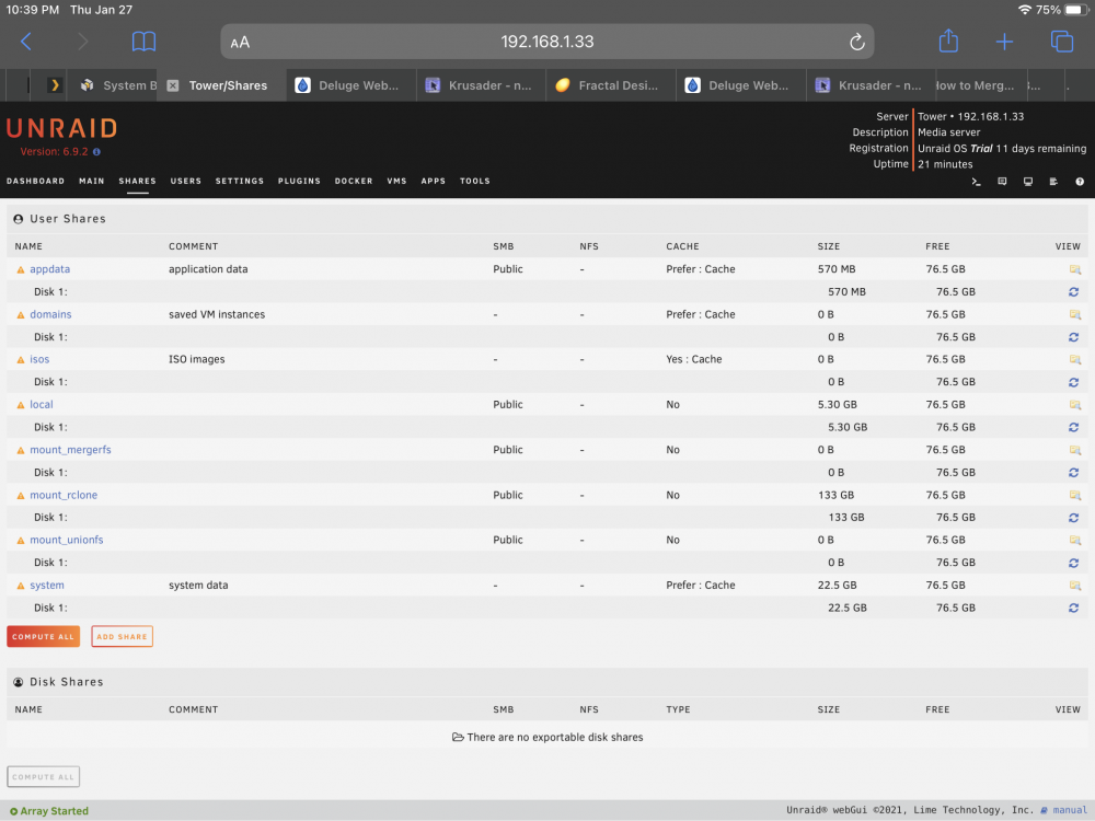

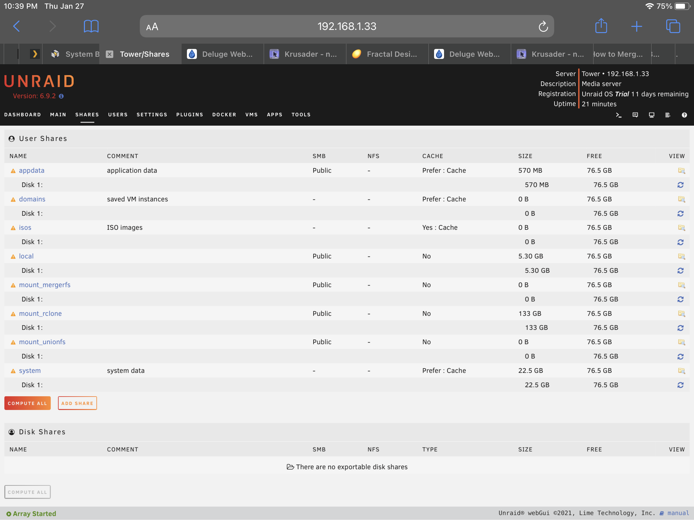

  12. Hi all, I just went through the steps to setup clone, google drive, etc. per the directions on this forum however I have a question. My mount_rclone folder is currently using local data, a fair amount in comparison to total. I was wondering what could be causing this or what I could check? Everything in this folder is uploaded to the cloud already. If anyone asks I’m currently running this machine off a 240gb SSD as a test. My main server (little over 150tb) has unfortunately become a hindrance physically and I need to down size it’s size into something smaller. Thinking a node 304 which can only accommodate six drives and I have 14 currently so I’m really hoping to make this work until I can use my server rack again sometime down the road. Thanks in advance.
