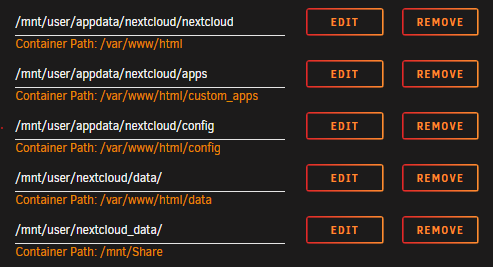

  3. Absolutely sure! Can you please advise me on this? I have some bad experiences with changing rights of the nextcloud folder.. The last times I tried stuff like this nextcloud gave me the 'rights' error and after that the internal server error lol. So the rights at this moment are in the docker container: drwxrwx--- 1 www-data root 246 Mar 29 13:31 data From the unraid terminal: drwxrwx--- 1 sshd root 246 Mar 29 13:31 data/ If I get this correctly: the root folder on unraid itself (data in this case) does not inherit the rights given IN the docker container? So: if I add the users: 'nobody' and 'users' which is the same as the other shares: drwxrwxrwx 1 nobody users 0 Mar 14 15:23 SHARE_NAME/ It should work? Or do I need to change the rights in the docker container as well?
  4. Yes it is x64, and it should work but it doesn't (I did install the apps from the start) no matter now: it works with the external onlyoffice docker. My path are set as follows: I have acces to /mnt/user/nextcloud. (and can create folders/files, so the share is working) I don't have acces to /mnt/user/nextcloud/data -> the error is: I do not have permission to acces the folder.
