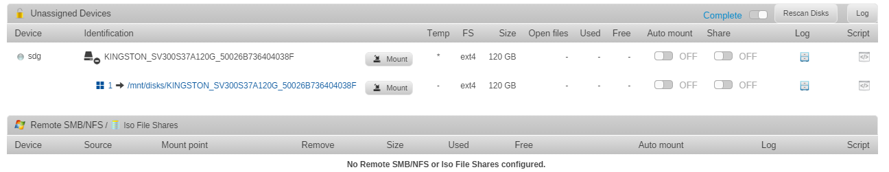

  3. Yeah, it goes all the way through the process but won't save the change when I press enter. I've tried with AUTOMOUNT and SHARE settings ON and OFF. Also no dockers or VM's running. Also tried stopping the array. Still the same reaction.It goes back to the original name.
  4. I tried several. 120GB and KINGSTON were two of them.Also tried entering /mnt/disks/KINGSTON and /mnt/disks/SSD. Thx.
  5. Hi. I have successfully installed, created a single ext4 partition and mounted an SSD from Unassigned Devices that I can use from my Win 7 VM. However I am having an issue trying to rename the mount point (ext4 partition). When I have the partition unmounted and select it, I can type in the new name via the box that appears. But when I hit enter, the name does not take and goes back to the original long name. I have been scanning the threads here looking for info on this (I'm still a newb to unraid) but have found nothing. Does anybody have any idea(s) what I may be doing wrong? Thanks!!
