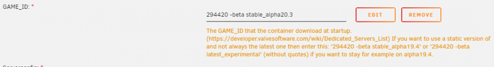

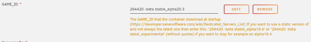

  1. Thanks. I got in contact with him and he had me use "294420 -beta Alpha20.3" without the quotes and that worked for me.
  2. Ich777, just wanted to check in with you regarding the 7D2D docker. I've been trying to deploy a clean Alpha 20.3 stable (I don't want to run the recently released Alpha 20.4 stable), and every time I set the options in the configuration, steamcmd still pulls down 20.4 release. This should be the correct syntax according to the instructions. Am I missing something here? Thanks!

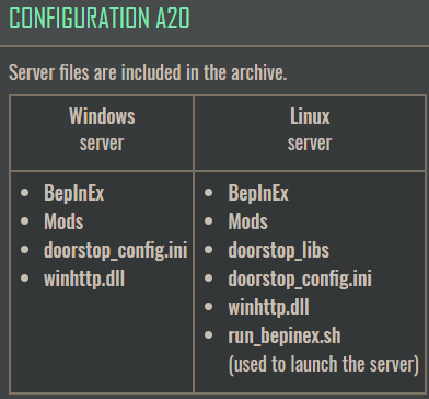

  4. It's just one mod, Undead Legacy. ul.subquake.com. Here's what's included with the mod when you download it: All the required files to run the server with Undead Legacy are included in the archive: BepInEx Mods doorstop_libs doorstop_config.ini run_bepinex_server.sh (used to launch the server) It works perfectly fine launching it with a full Linux distro when you launch the 7d2d server using run_bepinex_server.sh, just doesn't work from the docker instance. The only thing I can think of is something in the that sh file is causing issues maybe.

  8. Sure. It's included with SubQuake's Undead Legacy mod for 7DtD. With his A20 release, he has switched most of his code over to BepInEx and the .sh file is included in his Mod which is here: https://ul.subquake.com/. The requirement is that the server needs to be launched using the run_bepinex.sh file. Instructions for his A20 server are as follows: https://ul.subquake.com/dedicated-servers

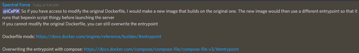

  10. Ok, thanks. I did get a response from @Spectral Force Modifying the Dockerfile is a bit beyond my skillset
  11. I am on his Discord and chatted with him yesterday. He wasn't sure about it and was going to talk to someone who knew more about containers than he did. I don't think anyone has done this yet for 7 Days to Die. Would be great if you could look into it as it'll likely become more of an issue if more mod creators decide to use Bepinex. Thanks!
