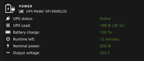

  8. Here the unRAID server UPS details:

  10. The UPS can provide 550W and the unRAID server draws about 170-200W The fact of disconnecting the USB cable was just to test it, thinking that unRAID was perhaps giving "wrong" information to the UPS. With the USB cable connected unRAID says the load is about 30%, so I don't think the UPS is struggling to power it.....am I wrong?
