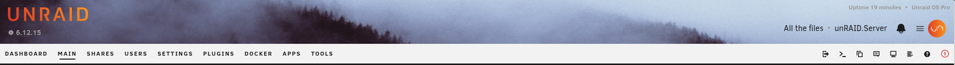

  2. I just updated Unraid Connect to version 2025.09.05.0026. I am on Unraid version 6.12.15. I did not receive any errors during install, everything seemed to run successfully. I am accessing the server GUI through Chrome. Upon restarting my server, I did have to re-login into the connect plugin and re-attach my server to my account for some reason. I've also noticed that clicking the "Settings" button within the Connect menu doesn't do anything The primary issue is that sometimes the Connect button that opens the drop-down menu just disappears, along with the server version number. I can get it to re-appear by clicking on a separate page, or by re-loading the page entirely. I've attached two screenshots for reference

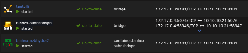

  7. I wanted to make this post before submitting a bug ticket, not knowing whether or not this is expected behavior. I have a container "binhex-nzbhydra2" which I route through a separate VPN enabled container "binhex-sabnzbdvpn". Generally speaking this seems to be working fine and I'm not aware of any issues such as IP leak or connectivity problems. I used the guide created by spaceinvaderone that was linked here to accomplish this: All this said, I have noticed that when I install or update another container unrelated to nzbhydra2, it will inherit the port mappings of that container in the GUI. I believe this may only be a visual error but without 100% certainty, as I'm still able to access the nzbhydra container via the ip and port that are established by sabnzbd. The example below demonstrates the issue, I just updated the tautulli container and the port mappings for nzbhydra2 show the same (usually this field is blank).

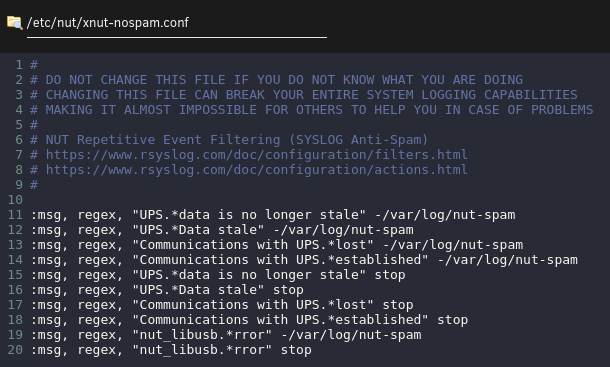

  12. I fixed it! To start, yes I do have a remote syslog server running. While that wasn't exactly the culprit, the fact that you mentioned it along with the syslogd configuration had me digging through all my syslog config files. It turns out there was a bug in how rsyslog.conf was written sometime before unraid 6.9.x (issue linked below), which would inadvertently reset the filtering rules after custom rules has been applied. After deleting rsyslog.conf and rsyslog.cfg from flash, the files were recreated properly after accessing the syslog configuration in settings. The filters are now working! Thanks again for the support, there's no way I would have sorted this out through blind troubleshooting.

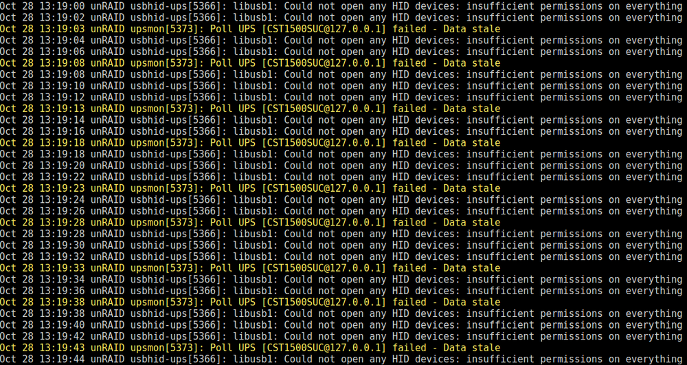

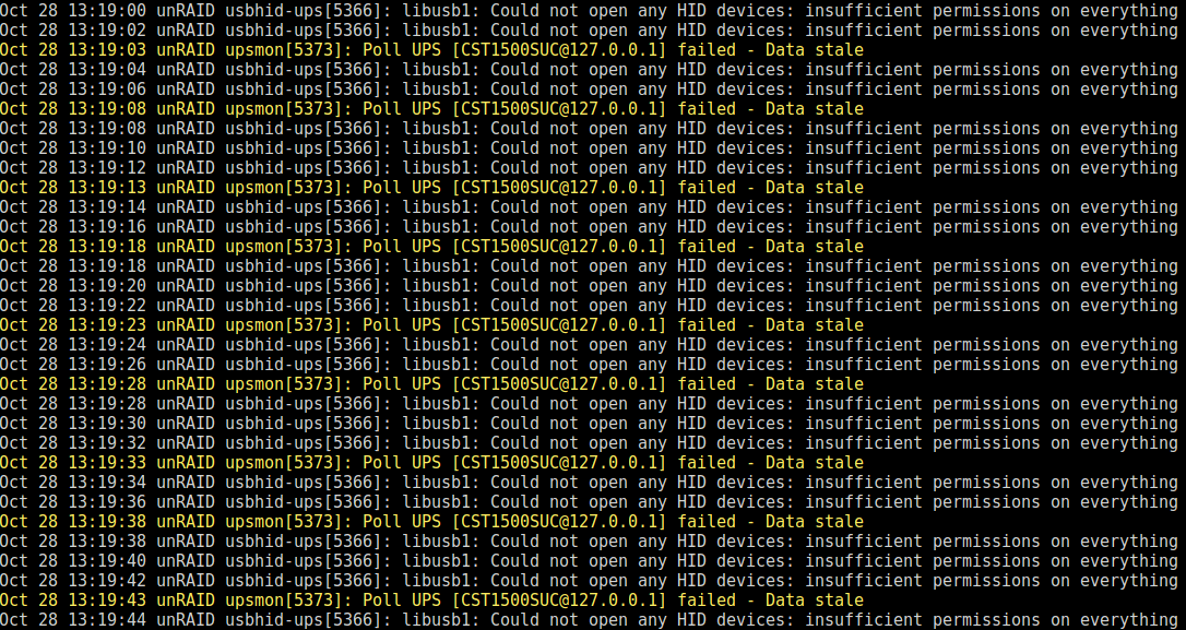

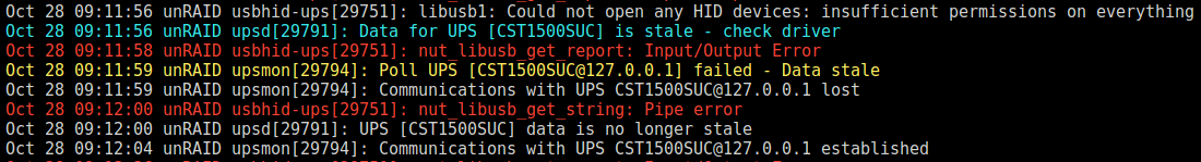

  14. Welp, I don't want to waste your time with any of this. I ended up trying a different USB cable on a whim and those errors have stopped it seems. That said, it does seem like the ability to suppress the syslog errors is not working for me, but I guess I won't worry about that until the need arises. Thanks again for your help! EDIT AGAIN: I spoke too soon. I'm now getting a bunch of the data stale messages, but as stated previously it does not seem like the syslog filtering function is working for me. Screenshot attached for ref
  15. Unfortunately this doesn't seem to have worked for me, I'm still getting the same errors populating in syslog. This is after adding the lines above and restarting NUT several times with Enable Rule-Based Syslog Filters: "Yes" Some things I've noticed that may or may (or may not) be helpful: when I was originally trying to add my own filter rules to "xnut-nospam.conf" I was getting syntax errors upon NUT start-up, presumably because what I was adding was wrong. After adding the lines you suggested above, I no longer receive those errors so that is a good sign I've looked for the /var/log/nut-spam file through Krusader and I simply can't find it. I had NUT running overnight with "Enable Rule-Based Syslog Filters" set to Yes, so I would have at least expected the file to have been created. Is it possible there might be some sort of permission issue that's preventing any of these lines from executing? Attaching my current xnut-nospam.conf for reference. Thanks again for the help! EDIT: adding an additional screenshot of "errors". I believe some of these should be captured by the filters in xnut-nospam.conf which seems to indicate that none of the filters are working in my case
