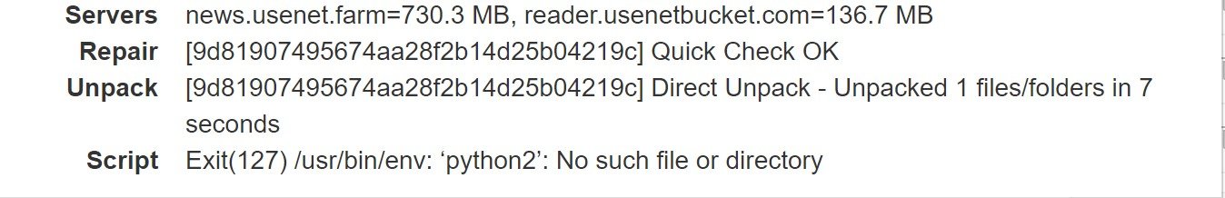

  5. Anybody else using nzbtoSickbeard.py to sort your tv shows? After 3 years without a single issue the latest sabnzbd is giving me this error when processing tv-shows /usr/bin/env: ‘python2’: No such file or directory Was there a change in the python version or path in the latest docker? this issue started five days ago.
