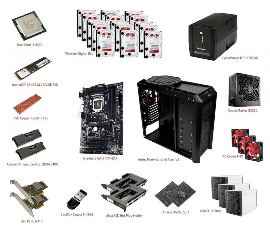

  17. I'd like to share my unRAID server, I'm very happy with it, specs in sig.
