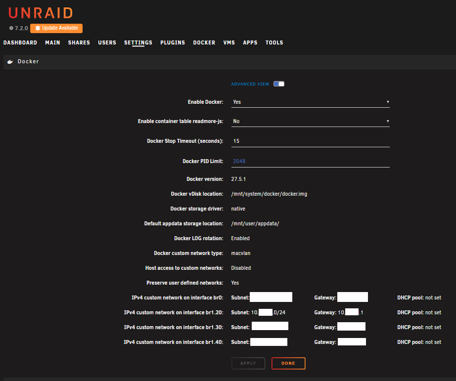

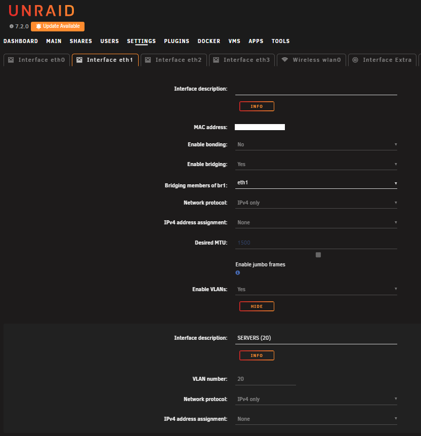

Once your network (outside of Unraid) is setup for vlans, you can add them to the network settings in Unraid per NIC, then you add them to network setting on the Docker service settings page. The network config will change depending on your network equipment, which needs to be vlan capable, but for the Unraid side its as below. Taking an example vlan of my "servers" on Network settings page, which creates the br1.20 (interface-or-bridge-name dot vlan-id) : note that I've masked some elements of my network config Docker service settings page (service needs to be stopped to change), vlan configured in settings this is how a container is configured in template, if you don't specify fixed address it uses your configured DHCP pool from Dockers page (docker doesn't use router DHCP) and subsequent container instance:

For me personally, everything has individual IPs per container using custom networks via my configured vlans (out of the box unraid configs). I couldn't imagine going back to the nightmare of managing port mapping conflicts, host shim network hacks, and lack of container name resolution... not to mention the overhead of an extra NAT layer.
