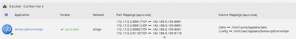

Thanks so much, also glad to support :) I couldn't get this to work so I ended up changing the conflicting container port (SABNZBD from 8080 to 9091) and reinstalled the container and it worked. Thanks again sir!

Binhex, thank you for your work on all of this. I'll send some coffee money over right away! I've changed the Host Port 3 to 8091, and the WEBUI_PORT to 8091 however I'm still unable to browse to the container. I feel like I'm missing something simple. Here are the other ports on the box: Thanks...
