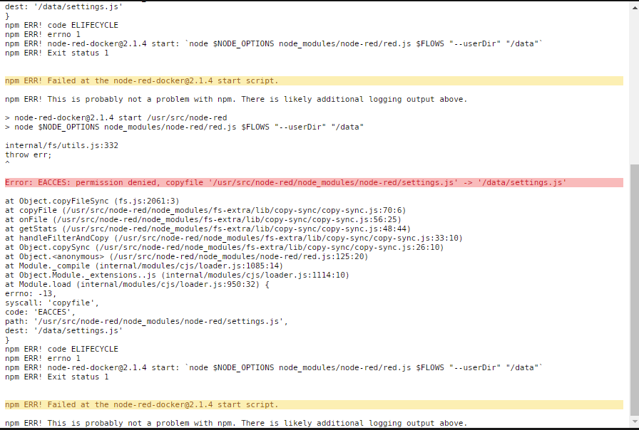

[support] Spants - NodeRed, MQTT, Dashing, couchDB
I was getting, but command wasnt working, so i removed NodeRed Docker. removed folder in Appdata and after installed it again, but now it doesnt want to even start and giving me this error:
