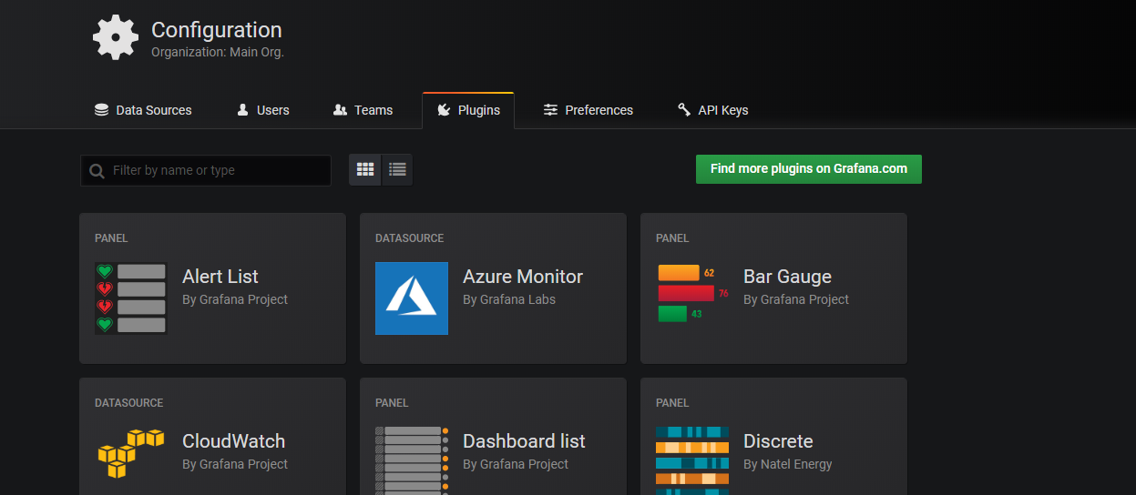

  1. Hi guys, Please how do i add additional Plugins , themes into the Grafana Docker? Is is possible to extend to "online" library or each plugin needs to be copied somewhere into the docker? If so please how/where? EDIT Seems like found here https://grafana.com/docs/grafana/latest/administration/cli/#plugins-commands Docker tab - right click on Grafana and run Console, each plugin has also ready commands https://grafana.com/grafana/plugins/yesoreyeram-boomtheme-panel/installation All sorted One more question still persist if i can somehow extend the local repository - to be able to see online via UI somehow? Thanks

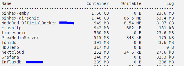

  18. i left it default, cos i didnt thought it can grow that much i was more worried about InfluxDB. So u think backup flows, wipe NodeRed reinstall (with some other data path) and put flows back? EDIT: I just checked now /appdata folder and "nodered" is not even there, so is only inside IMG
  19. not sure if its here the right place to ask - but ive tried Emby, AirSonic, LibreSonic (with enabled uPnP) ...but my Denon receiver or Mobile app (BubbleUpnp) could see only PlexMediaServer or Serviio content. So cant really use those apps thanks
  20. influxDB is separate Docker, i was assuming that InfluxDB could grow bit higher, but if the "Container Size" option is valid then NodeRed is the highest from all. Even it might grown due to some previous test in NodeRed, but no clue how to clean it up - wipe whole docker and install again?
  21. not sure - i have such option only to send data Even if it would save somewhere - i didnt find any option in NodeRed settings to clear logs...
  22. Hello, im using NodeRed to put my data from one system (Loxone) into InfluxDB, but seems like "NodeRed" docker size is growing (now over 8gb) and using most of my docker img space, how can i maintain / remove those old data / logs (what ever is it)? Thanks
