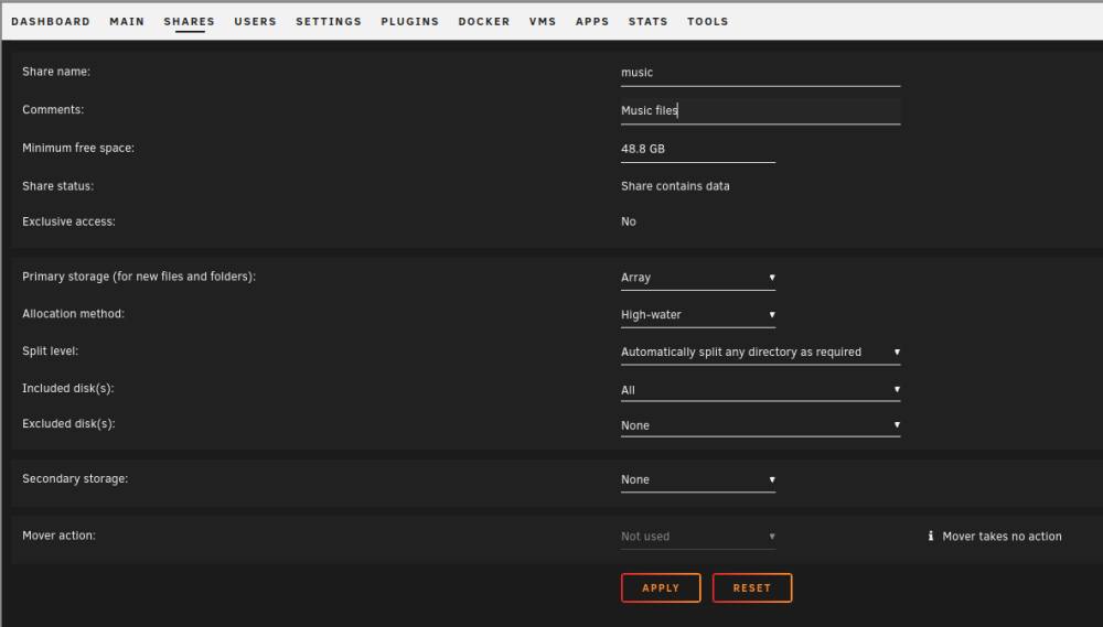

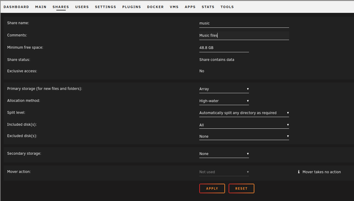

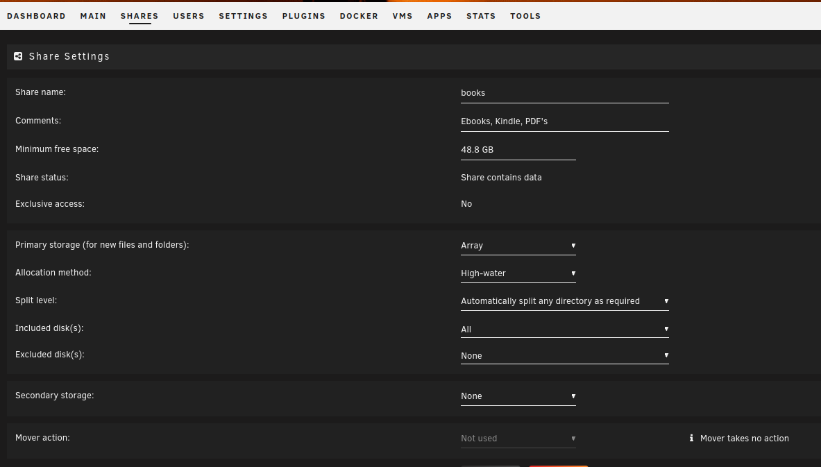

I'm getting this error - Share xxx references non existent cache pool yyy - but the share never had referenced a pool at all.
Ok, yeah. So, somehow what's being shown in the frontend, and what the config file are for the shares are different. When I make a slight change, like the description and then apply with it's current setting, the config file for the share then accurately reflects what's on the UI. So, i guess my next question would be, if the UI is not reflecting what's in the config file, which is reflecting how unraid behaves. Is it whatever is in the UI or is it whatever is in the config file for the share. My gut says config, but what would be odd about that is that I have seen files move onto the array and not into the cache. So I'm not sure.
Could there be some kind of issue with configs after upgrading? Or, am I missing something? When I go into the Shares, they are not configured to use a pool, as far as I can tell, below are some screenshots of some of the shares. Also, where can I find the flash drive to remove those files you mentioned? I do most of my file management via ssh and using midnight commander. Edited: found the /boot/ folder... Thanks,
