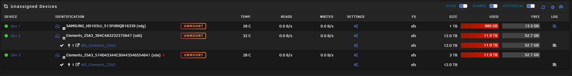

  4. I applogise if this has been covered in the past but I was unable to find anything. I had a 12TB USB HDD which was mounted through unassigned devices, it has now been shucked and made its way into the array. The disk it replaced a 3TB HDD has nolw made it into the old USB enclosure and I would like to mount it as an unassigned device. How ever as you can see from the attached photo altho it is reconised as being 3TB when I format it the old 12TB disks partition magicly appers. Im unable to use the drive and it sayd it is a full 12TB partition. How can I rectifiy it please? I have tried delting the partion and re-formatting and I still get the same result. Thanks universe-diagnostics-20220415-1216.zip
