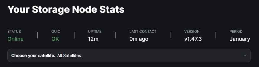

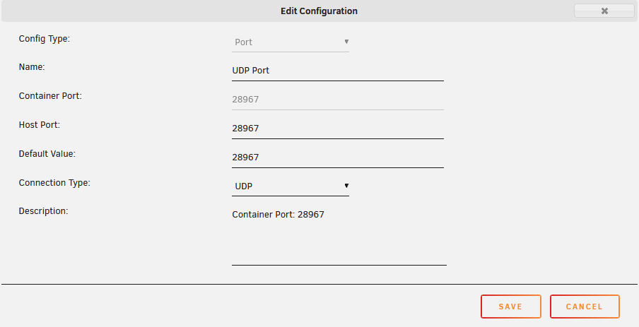

  6. Everything has been working well until this latest repository. QUIC Misconfigured. http://storjnet.info/ping_my_node Make sure your firewall is set to allow both TCP/UDP over your port. Unraid Container Settings: Add another Port Save/Apply Then go ping your node again. Check your node stats.
