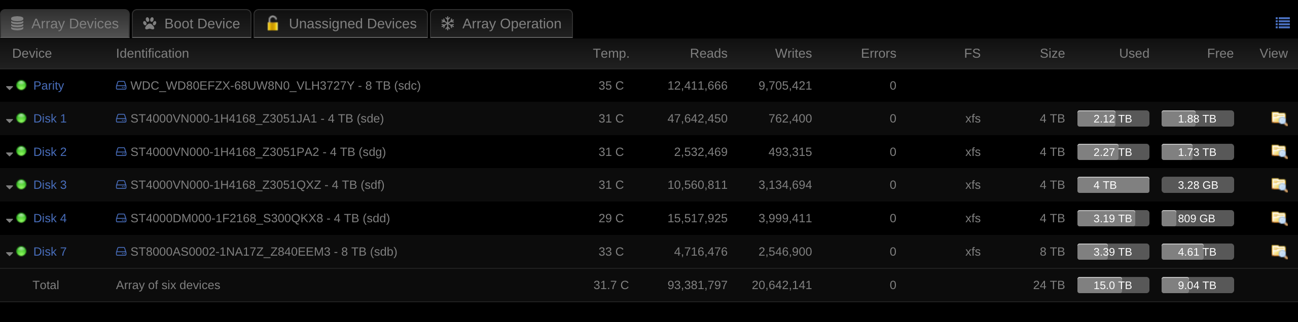

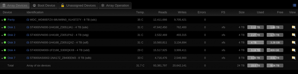

  13. Hey all, firstly I hope everything is staying healthy and well in this tough time! So I just found out about this tool, and I want to say thanks so much to JB for creating this - very easy to use and good info *NOTE: if this is not the appropriate forum for this question, please feel free to move it* So I have been having speed issues with my server for a long time, where I can not get anymore that 30/35Mb/s file transfer on any device in my home network, even when only transferring to one device at a time. I have tried testing SMB, FTP, SCP, AFP and they are all the same - I tried rsync and that came in at a thundering 8-9Mb/s - YAY! NOT! I was lazy and just dealt with it (bigger fish to fry!), but now that everyone is at the house, it is creating some issues. So I used this tool to see what my drives are doing to try and see if there is any issues. I have a very simple set up 24GB RAM Intel® Core i7-3770 CPU @ 3.40GHz 24TB array with cache pool A few dockers (Emby, sonarr, radarr, lidarr, NZBget, deluge etc), and couple of VMs I spin up when I want to use them. Full gigabit network and all devices support 1gb .... all client devices have SSDs or flash based storage apart from my unraid box. According to the benchmarks the drives average around 160Mb/s, so I should be able to saturate my gigabit network without issue, but thats never been the case - I have tried 3 different gigabit switches, with the same result. No drive errors are presenting either. Here are some screens Diagnostics unraid-diagnostics-20200417-2353.zip Any help at all would be appreciated guys!

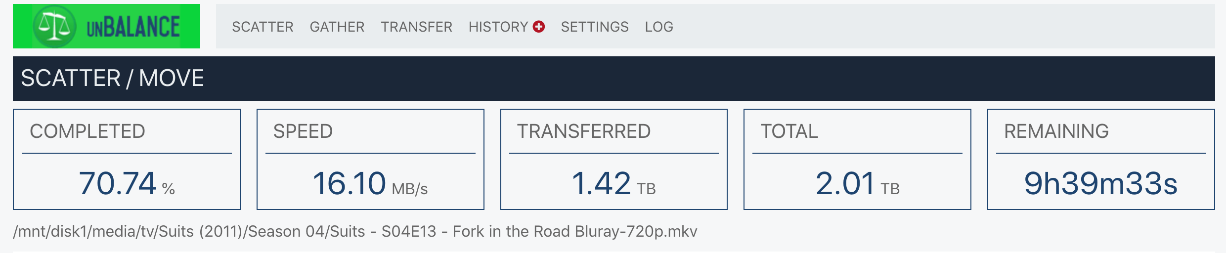

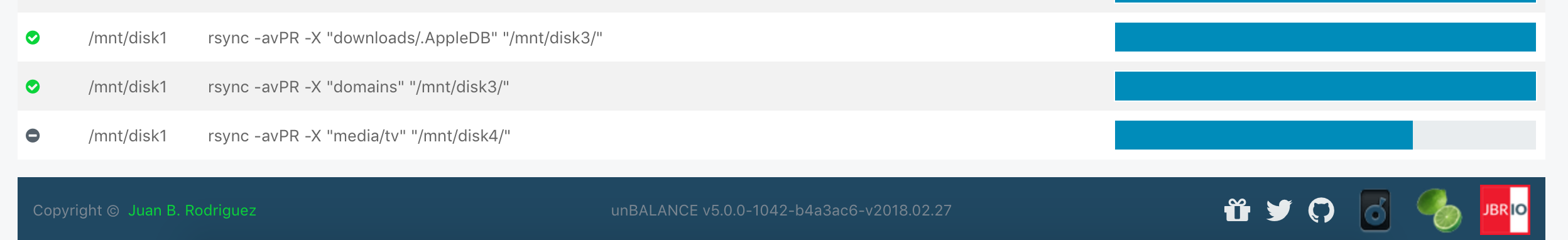

  16. Hey everyone! Just a quick one, I'm aware that the drives slow down as they fill up, however I think something may be amiss with my UnRAID and/or UnBalance, as I'm currently around hour number 39 for my move of files. Its going quite slow. I'm just moving all data off my first 4TB drive onto my other drives, as I'm preparing to encrypt my array. Sidenote: @gridrunner /spaceinvaderone has a great video (like all his videos) on how to do this if anyone is looking for a guide. However from the beginning its been so slow, the first time it even caused unbalance to crash around hour 15. At the start for about 30 seconds it went at about 60MB/s, then over the next minute or so it goes down to where it is now at around 16MB/s, and doesn't go any higher. The drive I'm moving the data off was only half full, so I wouldn't have thought that would have caused an issue, also the read speeds from that source drive should be a lot higher, and the fact its only writing from the source drive to another single drive at a time. I have two SATA 3 ports, one for my 8TB parity drive, and the other for another 8TB data drive. The rest are four 4TB drives connected to SATA 2 ports. I cant see any errors listed against my drives in dashboard: I've also attache my diagnostics that I generated a few mins ago. unraid-diagnostics-20180411-1832.zip It may just be how its meant to be, however it never hurts to ask right? Any help would be welcomed.... Cheers Dan

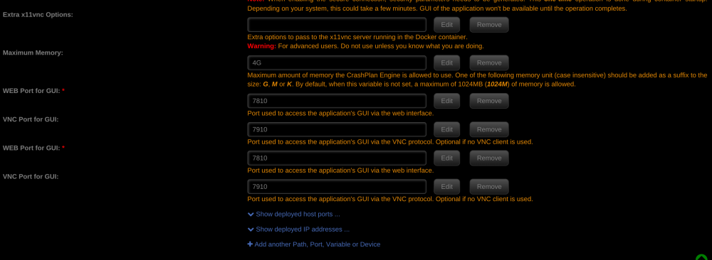

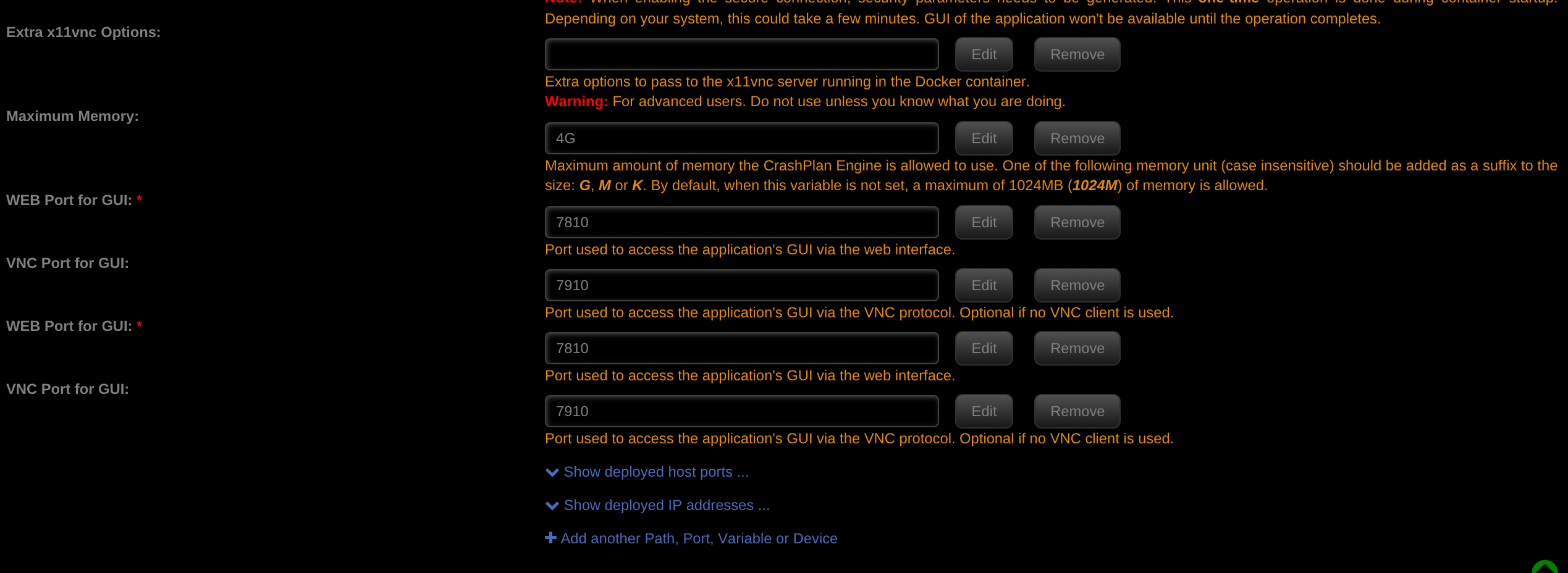

  19. hey guys, I'm hoping some of you guru's here will be able to offer some advice.... I've got the this crashplan pro docker container installed, and for the most part it runs wonderful! However I have two small issues that I am hoping to try and get sorted out: 1. I have an ubuntu VM installed, and everytime my docker autoupdate runs and my crashplan docker restarts, I can no longer VNC to it. I think it has something to do with the fact that the VM sometimes uses the same VNC port. So what I end up having to do is shut down the VM, restart crashplan, then restart the VM which then assigns the VM a different VNC port .... 5901 or something. Theres a number of settings in the CrashPlan Pro docker setup to, and I'm a little confused about them, I also have duplicate entries for the VNC and WebUI ports: It should be OK to remove those duplicates yeah? When I load the WebUI it opens on port 5800, so I can only assume that as per the above, ports 7810 & 7910 are internal ports inside the container for the Crashplan Pro services to run properly? 2. The other issue is that I can only seem to run the docker in host mode, it will not run in bridge mode, so I can specify another port like all my other docker containers, to try and avoid the current VNC conflict with my VM. I tried doing bridge mode and mapping a port to a spare port on my host machine, but when I tried to access it, it didnt work. I'm sure its a simple solution and just a configuration change, I'm just a little unsure as to what to change is all. Any help would be appreciated. Cheers, Dan
