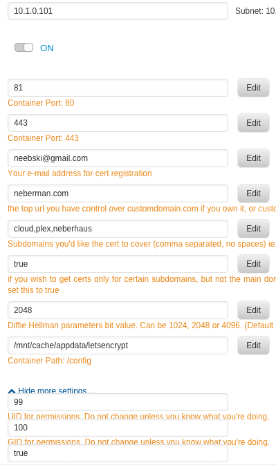

@aptalca Most of your suggestions worked as intended, although I have a few issues when attempting to login to the WP install. Do you mind if I PM you about this?
Great, thank you!
Also interested. I'm stuck right now trying to get a site to work that is running through cloudflare > nginx > apache-php (docker) > wordpress install. If I could just axe having to run apache docker that would be great. Does nginx have builtin php support?
