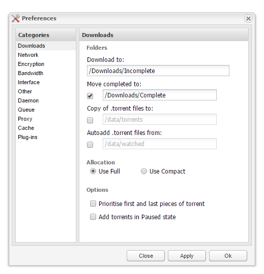

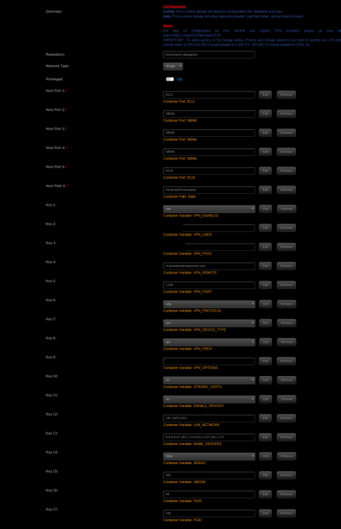

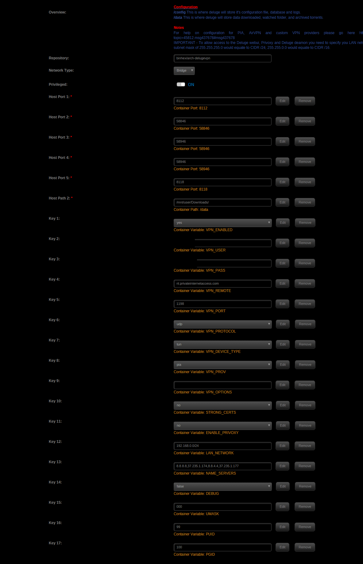

  8. Attached are pictures of the configuration. Thanks!
  9. So I am having a very odd issue that I am hoping fill fix itself now as I feel as though I have tried everything... I have now re installed unRAID and the issue persists. Whenever I add a torrent to Deluge it begins to download, speeds up as usual then slows down until it stalls only seconds later... checking the downloads folder show no data has been downloaded. I have played with every setting imaginable so I'm sure I'm just being an idiot. I am using binhex-delugevpn with Private Internet Access. This issue started yesterday. I have been playing around with downloaders like Couch Potato but after removing every trace of those I could find and even re-installing the OS and re-configuring unRAID I am at a loss... Please help! Here are some logs from Deluge: 2017-03-07 22:28:19.696152 [info] Starting Supervisor... 2017-03-07 22:28:19,885 CRIT Set uid to user 0 2017-03-07 22:28:19,885 INFO Included extra file "/etc/supervisor/conf.d/delugevpn.conf" during parsing 2017-03-07 22:28:19,887 INFO supervisord started with pid 6 2017-03-07 22:28:20,889 INFO spawned: 'start-script' with pid 113 2017-03-07 22:28:20,889 INFO spawned: 'deluge-script' with pid 114 2017-03-07 22:28:20,890 INFO spawned: 'deluge-web-script' with pid 115 2017-03-07 22:28:20,891 INFO spawned: 'privoxy-script' with pid 116 2017-03-07 22:28:20,894 DEBG 'start-script' stdout output: [info] VPN is enabled, beginning configuration of VPN 2017-03-07 22:28:20,894 INFO success: start-script entered RUNNING state, process has stayed up for > than 0 seconds (startsecs) 2017-03-07 22:28:20,894 INFO success: deluge-script entered RUNNING state, process has stayed up for > than 0 seconds (startsecs) 2017-03-07 22:28:20,894 INFO success: deluge-web-script entered RUNNING state, process has stayed up for > than 0 seconds (startsecs) 2017-03-07 22:28:20,894 INFO success: privoxy-script entered RUNNING state, process has stayed up for > than 0 seconds (startsecs) 2017-03-07 22:28:20,895 DEBG 'privoxy-script' stdout output: [info] Privoxy set to disabled 2017-03-07 22:28:20,895 DEBG fd 26 closed, stopped monitoring <POutputDispatcher at 46949059601544 for <Subprocess at 46949059024512 with name privoxy-script in state RUNNING> (stderr)> 2017-03-07 22:28:20,895 DEBG fd 22 closed, stopped monitoring <POutputDispatcher at 46949059602984 for <Subprocess at 46949059024512 with name privoxy-script in state RUNNING> (stdout)> 2017-03-07 22:28:20,895 INFO exited: privoxy-script (exit status 0; expected) 2017-03-07 22:28:20,896 DEBG received SIGCLD indicating a child quit 2017-03-07 22:28:20,896 DEBG 'deluge-script' stdout output: [info] Deluge config file doesn't exist, copying default... 2017-03-07 22:28:20,898 DEBG 'deluge-script' stdout output: [info] VPN is enabled, checking VPN tunnel local ip is valid 2017-03-07 22:28:20,899 DEBG 'start-script' stdout output: [info] VPN default certs defined, copying to /config/openvpn/... 2017-03-07 22:28:20,901 DEBG 'start-script' stdout output: [info] VPN config file (ovpn extension) is located at /config/openvpn/openvpn.ovpn 2017-03-07 22:28:20,901 DEBG 'start-script' stderr output: dos2unix: converting file /config/openvpn/openvpn.ovpn to Unix format... 2017-03-07 22:28:20,928 DEBG 'start-script' stdout output: [info] Default route for container is 172.17.0.1 2017-03-07 22:28:20,930 DEBG 'start-script' stdout output: [info] Adding 8.8.8.8 to /etc/resolv.conf 2017-03-07 22:28:20,932 DEBG 'start-script' stdout output: [info] Adding 37.235.1.174 to /etc/resolv.conf 2017-03-07 22:28:20,934 DEBG 'start-script' stdout output: [info] Adding 8.8.4.4 to /etc/resolv.conf 2017-03-07 22:28:20,936 DEBG 'start-script' stdout output: [info] Adding 37.235.1.177 to /etc/resolv.conf 2017-03-07 22:28:20,940 DEBG 'start-script' stdout output: [info] Adding 192.168.0.0/24 as route via docker eth0 2017-03-07 22:28:20,941 DEBG 'start-script' stdout output: [info] ip route defined as follows... -------------------- 2017-03-07 22:28:20,941 DEBG 'start-script' stdout output: default via 172.17.0.1 dev eth0 172.17.0.0/16 dev eth0 proto kernel scope link src 172.17.0.2 192.168.0.0/24 via 172.17.0.1 dev eth0 2017-03-07 22:28:20,941 DEBG 'start-script' stdout output: -------------------- 2017-03-07 22:28:20,945 DEBG 'start-script' stdout output: [info] iptable_mangle support detected, adding fwmark for tables 2017-03-07 22:28:20,965 DEBG 'start-script' stdout output: [info] iptables defined as follows... -------------------- 2017-03-07 22:28:20,966 DEBG 'start-script' stdout output: -P INPUT DROP -P FORWARD ACCEPT -P OUTPUT DROP -A INPUT -i tun0 -j ACCEPT -A INPUT -s 172.17.0.0/16 -d 172.17.0.0/16 -j ACCEPT -A INPUT -i eth0 -p udp -m udp --sport 1198 -j ACCEPT -A INPUT -i eth0 -p tcp -m tcp --dport 8112 -j ACCEPT -A INPUT -i eth0 -p tcp -m tcp --sport 8112 -j ACCEPT -A INPUT -s 192.168.0.0/24 -i eth0 -p tcp -m tcp --dport 58846 -j ACCEPT -A INPUT -p udp -m udp --sport 53 -j ACCEPT -A INPUT -p icmp -m icmp --icmp-type 0 -j ACCEPT -A INPUT -i lo -j ACCEPT -A OUTPUT -o tun0 -j ACCEPT -A OUTPUT -s 172.17.0.0/16 -d 172.17.0.0/16 -j ACCEPT -A OUTPUT -o eth0 -p udp -m udp --dport 1198 -j ACCEPT -A OUTPUT -o eth0 -p tcp -m tcp --dport 8112 -j ACCEPT -A OUTPUT -o eth0 -p tcp -m tcp --sport 8112 -j ACCEPT -A OUTPUT -d 192.168.0.0/24 -o eth0 -p tcp -m tcp --sport 58846 -j ACCEPT -A OUTPUT -p udp -m udp --dport 53 -j ACCEPT -A OUTPUT -p icmp -m icmp --icmp-type 8 -j ACCEPT -A OUTPUT -o lo -j ACCEPT 2017-03-07 22:28:20,966 DEBG 'start-script' stdout output: -------------------- 2017-03-07 22:28:20,966 DEBG 'start-script' stdout output: [info] Starting OpenVPN... 2017-03-07 22:28:20,974 DEBG 'start-script' stdout output: [info] OpenVPN started 2017-03-07 22:28:23,036 DEBG 'deluge-script' stdout output: [info] Deluge not running [info] Deluge listening interface IP 0.0.0.0 and VPN provider IP 10.43.10.6 different, marking for reconfigure 2017-03-07 22:28:29,789 DEBG 'deluge-script' stdout output: [info] Attempting to start Deluge... 2017-03-07 22:28:30,351 DEBG 'deluge-script' stdout output: [info] Deluge listening interface currently defined as 0.0.0.0 [info] Deluge listening interface will be changed to 10.43.10.6 [info] Saving changes to Deluge config file /config/core.conf... 2017-03-07 22:28:30,603 DEBG 'deluge-script' stderr output: /usr/lib/python2.7/site-packages/deluge/_libtorrent.py:59: RuntimeWarning: to-Python converter for boost::shared_ptr<libtorrent::alert> already registered; second conversion method ignored. import libtorrent as lt 2017-03-07 22:28:30,749 DEBG 'deluge-web-script' stdout output: [info] Starting Deluge webui... 2017-03-07 22:28:30,977 DEBG 'deluge-script' stdout output: Setting random_port to False.. Configuration value successfully updated. 2017-03-07 22:28:31,238 DEBG 'deluge-script' stdout output: Setting listen_ports to (55923, 55923).. Configuration value successfully updated. 2017-03-07 22:28:31,257 DEBG 'deluge-script' stdout output: [info] Deluge started
