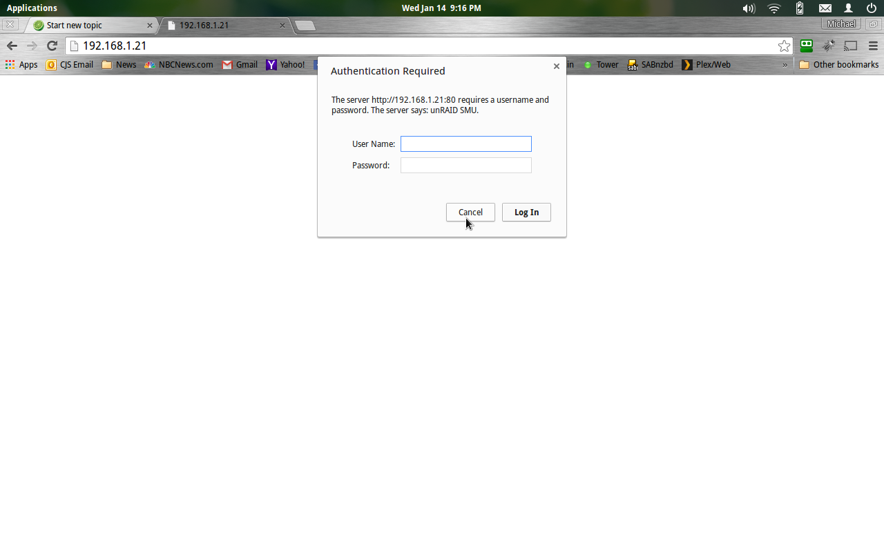

Frank1940 That worked but it has happened again. What would cause the issue. I don't want to keep having to reset this all the time. How can I fix this so it does not happen again.

I tried the following username. password root. blank blank. root root. root none work

I have upgraded to 6.0 recently and everything was working fine until today. All of a sudden it is asking for a user name and password. "The server says: unRAID SMU" I tried the standard root root but it does not work. there are no other users or password on the server. any suggestions
