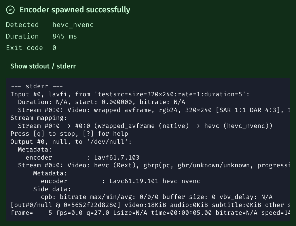

  1. Outputs for you: root@unraid:~# docker exec x265-butler ffmpeg-nvenc -hide_banner -f lavfi -i testsrc=size=320x240:rate=30 -frames:v 30 -c:v hevc_nvenc -f null - 2>&1 | tail -20 Input #0, lavfi, from 'testsrc=size=320x240:rate=30': Duration: N/A, start: 0.000000, bitrate: N/A Stream #0:0: Video: wrapped_avframe, rgb24, 320x240 [SAR 1:1 DAR 4:3], 30 fps, 30 tbr, 30 tbn Stream mapping: Stream #0:0 -> #0:0 (wrapped_avframe (native) -> hevc (hevc_nvenc)) Press [q] to stop, [?] for help Output #0, null, to 'pipe:': Metadata: encoder : Lavf61.7.103 Stream #0:0: Video: hevc (Rext), gbrp(pc, gbr/unknown/unknown, progressive), 320x240 [SAR 1:1 DAR 4:3], q=2-31, 2000 kb/s, 30 fps, 30 tbn Metadata: encoder : Lavc61.19.101 hevc_nvenc Side data: cpb: bitrate max/min/avg: 0/0/2000000 buffer size: 4000000 vbv_delay: N/A [out#0/null @ 0x562117606300] video:55KiB audio:0KiB subtitle:0KiB other streams:0KiB global headers:0KiB muxing overhead: unknown frame= 30 fps=0.0 q=10.0 Lsize=N/A time=00:00:01.00 bitrate=N/A speed=2.86x root@unraid:~# docker exec x265-butler ffmpeg-nvenc -hide_banner -f lavfi -i testsrc=size=320x240:rate=30 -frames:v 30 -pix_fmt p010le -c:v hevc_nvenc -f null - 2>&1 | tail -20 Input #0, lavfi, from 'testsrc=size=320x240:rate=30': Duration: N/A, start: 0.000000, bitrate: N/A Stream #0:0: Video: wrapped_avframe, rgb24, 320x240 [SAR 1:1 DAR 4:3], 30 fps, 30 tbr, 30 tbn Stream mapping: Stream #0:0 -> #0:0 (wrapped_avframe (native) -> hevc (hevc_nvenc)) Press [q] to stop, [?] for help Output #0, null, to 'pipe:': Metadata: encoder : Lavf61.7.103 Stream #0:0: Video: hevc (Main 10), p010le(tv, progressive), 320x240 [SAR 1:1 DAR 4:3], q=2-31, 2000 kb/s, 30 fps, 30 tbn Metadata: encoder : Lavc61.19.101 hevc_nvenc Side data: cpb: bitrate max/min/avg: 0/0/2000000 buffer size: 4000000 vbv_delay: N/A [out#0/null @ 0x55b02e7243c0] video:20KiB audio:0KiB subtitle:0KiB other streams:0KiB global headers:0KiB muxing overhead: unknown frame= 30 fps=0.0 q=10.0 Lsize=N/A time=00:00:01.00 bitrate=N/A speed=2.85x
  2. A: name, driver_version, compute_cap Tesla P4, 580.159.04, 6.1 B: [hevc_nvenc @ 0x564ef338e000] Driver does not support the required nvenc API version. Required: 13.1 Found: 13.0 [hevc_nvenc @ 0x564ef338e000] The minimum required Nvidia driver for nvenc is 610.00 or newer C: fb72fd6b365b: Pull complete 19bd9c9a3a70: Pull complete Digest: sha256:aefb67e6a7ff1debdd154a78a7bbb780fd0c873d8639210a7f6a2016ad2b35db Status: Downloaded newer image for jellyfin/jellyfin:latest Input #0, lavfi, from 'testsrc=size=320x240:rate=30': Duration: N/A, start: 0.000000, bitrate: N/A Stream #0:0: Video: wrapped_avframe, rgb24, 320x240 [SAR 1:1 DAR 4:3], 30 fps, 30 tbr, 30 tbn Stream mapping: Stream #0:0 -> #0:0 (wrapped_avframe (native) -> hevc (hevc_nvenc)) Press [q] to stop, [?] for help Output #0, null, to 'pipe:': Metadata: encoder : Lavf61.7.103 Stream #0:0: Video: hevc (Rext), gbrp(pc, gbr/unknown/unknown, progressive), 320x240 [SAR 1:1 DAR 4:3], q=2-31, 2000 kb/s, 30 fps, 30 tbn Metadata: encoder : Lavc61.19.101 hevc_nvenc Side data: cpb: bitrate max/min/avg: 0/0/2000000 buffer size: 4000000 vbv_delay: N/A [out#0/null @ 0x14b5a4a7c040] video:55KiB audio:0KiB subtitle:0KiB other streams:0KiB global headers:0KiB muxing overhead: unknown frame= 30 fps=0.0 q=10.0 Lsize=N/A time=00:00:01.00 bitrate=N/A speed=2.92xD: V....D av1_nvenc NVIDIA NVENC av1 encoder (codec av1) V..... av1_qsv AV1 (Intel Quick Sync Video acceleration) (codec av1) V....D av1_vaapi AV1 (VAAPI) (codec av1) V....D h264_nvenc NVIDIA NVENC H.264 encoder (codec h264) V..... h264_qsv H.264 / AVC / MPEG-4 AVC / MPEG-4 part 10 (Intel Quick Sync Video acceleration) (codec h264) V....D h264_vaapi H.264/AVC (VAAPI) (codec h264) V....D libx265 libx265 H.265 / HEVC (codec hevc) V....D hevc_nvenc NVIDIA NVENC hevc encoder (codec hevc) V..... hevc_qsv HEVC (Intel Quick Sync Video acceleration) (codec hevc) V....D hevc_vaapi H.265/HEVC (VAAPI) (codec hevc) V..... mjpeg_qsv MJPEG (Intel Quick Sync Video acceleration) (codec mjpeg) V....D mjpeg_vaapi MJPEG (VAAPI) (codec mjpeg) V..... mpeg2_qsv MPEG-2 video (Intel Quick Sync Video acceleration) (codec mpeg2video) V....D mpeg2_vaapi MPEG-2 (VAAPI) (codec mpeg2video) V....D vp8_vaapi VP8 (VAAPI) (codec vp8) V....D vp9_vaapi VP9 (VAAPI) (codec vp9) V..... vp9_qsv VP9 video (Intel Quick Sync Video acceleration) (codec vp9)Just the P4 in my build. Yes, just HEVC Yes, happy to do so once it's there.

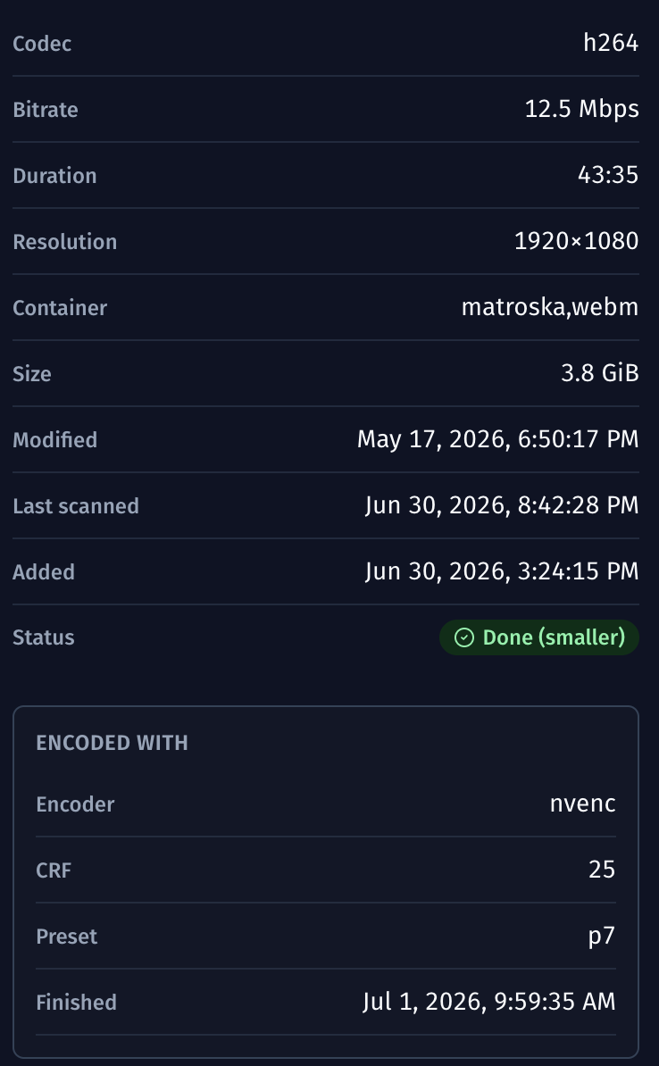

  3. Tesla P4 on NVIDIA 580-series driver. GPU is visible inside the container and nvidia-smi works, but Butler's bundled FFmpeg requires NVENC API 13.1 / driver 610: Driver does not support the required nvenc API version. Required: 13.1 Found: 13.0 The Tesla P4 is Pascal and NVIDIA driver 580 is the final branch supporting Pascal. Could Butler use an FFmpeg build compiled against Video Codec SDK 13.0, or provide a legacy-NVENC image/tag for Pascal GPUs?
