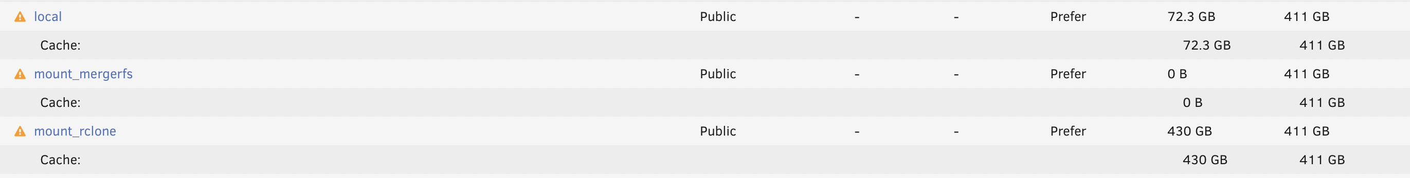

  15. First off, I want to say the setup for this is super easy and I appreciate your hard work, DZMM. I started from scratch on a smaller server this weekend and I was able to have this up and running in no time. I'm seeing that my cache drive is being eaten up by the "mount_rclone" share, even after reset. My cache size is set to 400GB, which I copied from the scripts. Is this normal/expected? Is there a need for it to be so large? What exactly is cache doing here?
