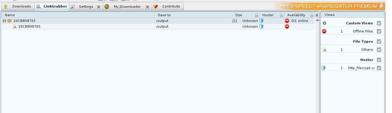

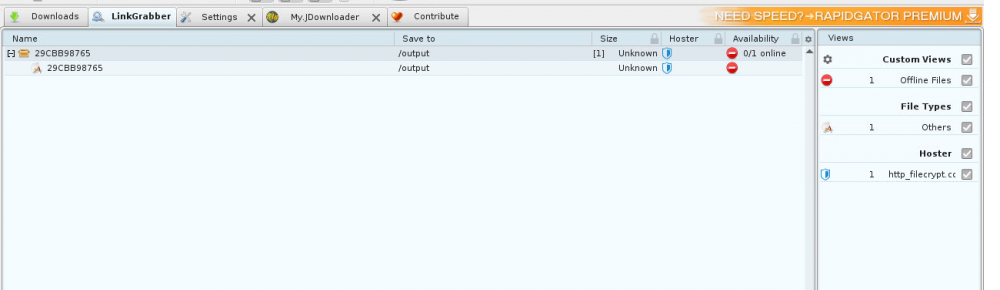

  1. believe me that problem is not the filecrypt container link, the link works with other JD2 , just with JD2 on docker doesnt work , i read on JD forum that seems to be related to the FF linux version
  2. with this docker i have problems decrypting Filecrypt containers, if i add one, the links of the filecrypt html show as OFFLINE already updated JD2 and even reinstall the docker with JD2 directly on the pc, filecrypt containers works without problems , so i guess there is a problem with JD2 on the docker
